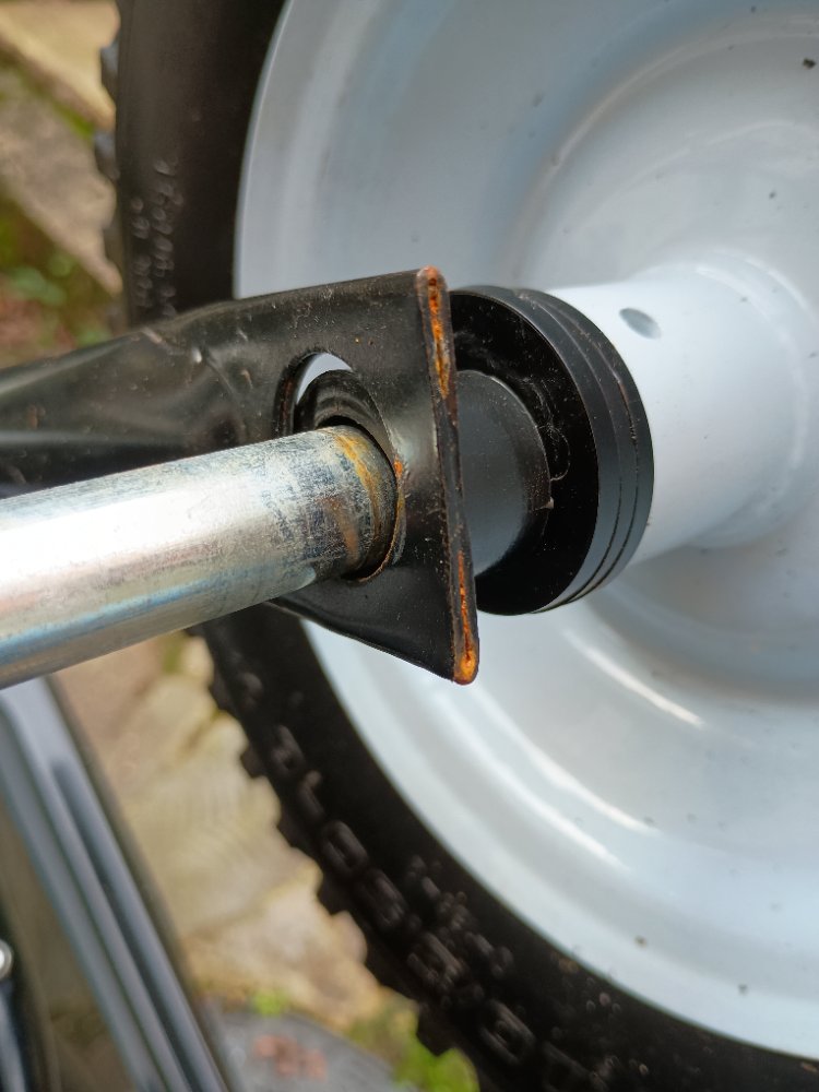

Yes you're right, there's another part not in the photos that goes inside the flanged part, it's now installed on the outside of the frame and can't move out of position.What stops your reverse flanged bush from wandering along the axle?
I would have thought the flange would be to the outside, between wheel and frame, with either an exle length, or suitable spacers, to keep the wheel up to it so it keeps it in the frame? And a good tight fit in the frame so it doesn't rotate in the frame.
I've had several wheeled items where that has happened .I've just taken delivery of a small salt spreader for our lane but have discovered the flanged plastic bearing for the axle has been fitted round the wrong way.
The flange looks like it should be this side of the frame.

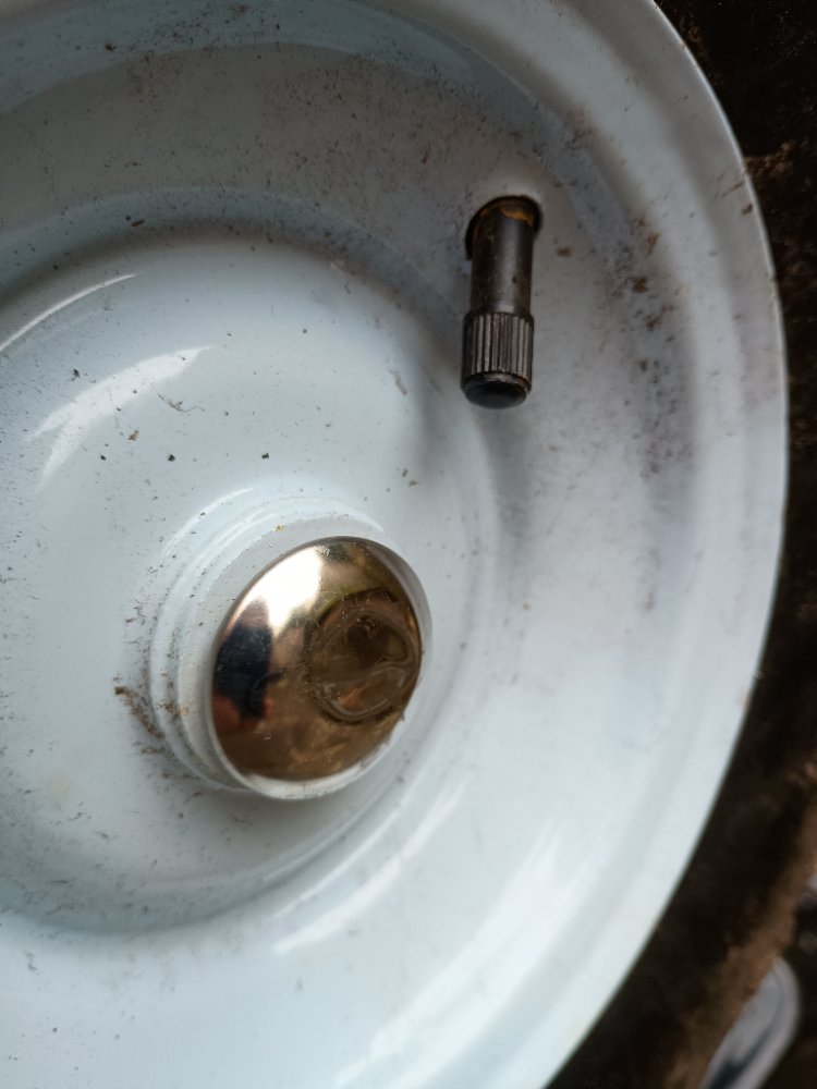

I need to remove these 'dome nuts'?
Any ideas without damaging them?
