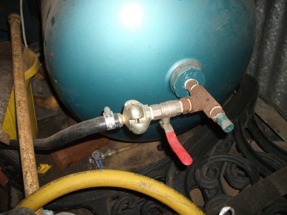

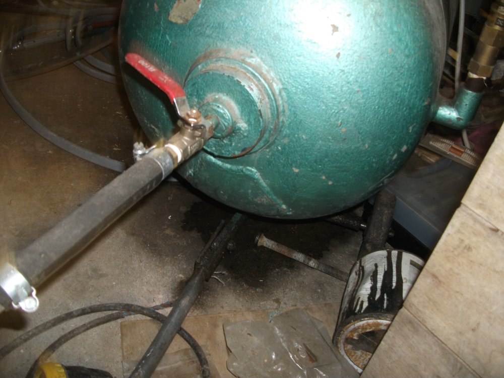

dont bother with a lubricator bin it just a few drops of oil in the tool is suficient each day. i use these 2 couplings on a y piece hose along with c couplings with large bore pipe for various aplicationsIf you've got both types of connectors it's worth fitting an outlet of each type. Keep the older type for air tools that need a lubricator and the later type for spraying and air fed mask, Fit the appropriate fittings on two airlines to keep them separate and avoid contaminating your paint with oil.
