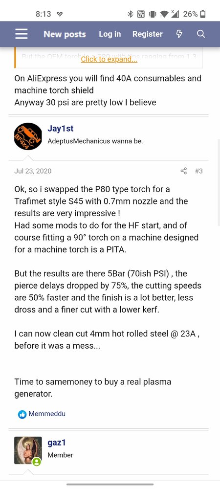

He only metioned that he had done some "mods" for the HF start. That is what I am trying to hunt down so I could run the S45 torch.
That's all I found as well.View attachment 455593
That's simply pilot arc, not HF versus snap start.Here's a video that might point you in the right direction
