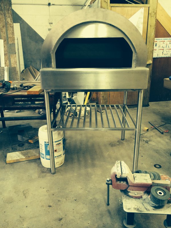

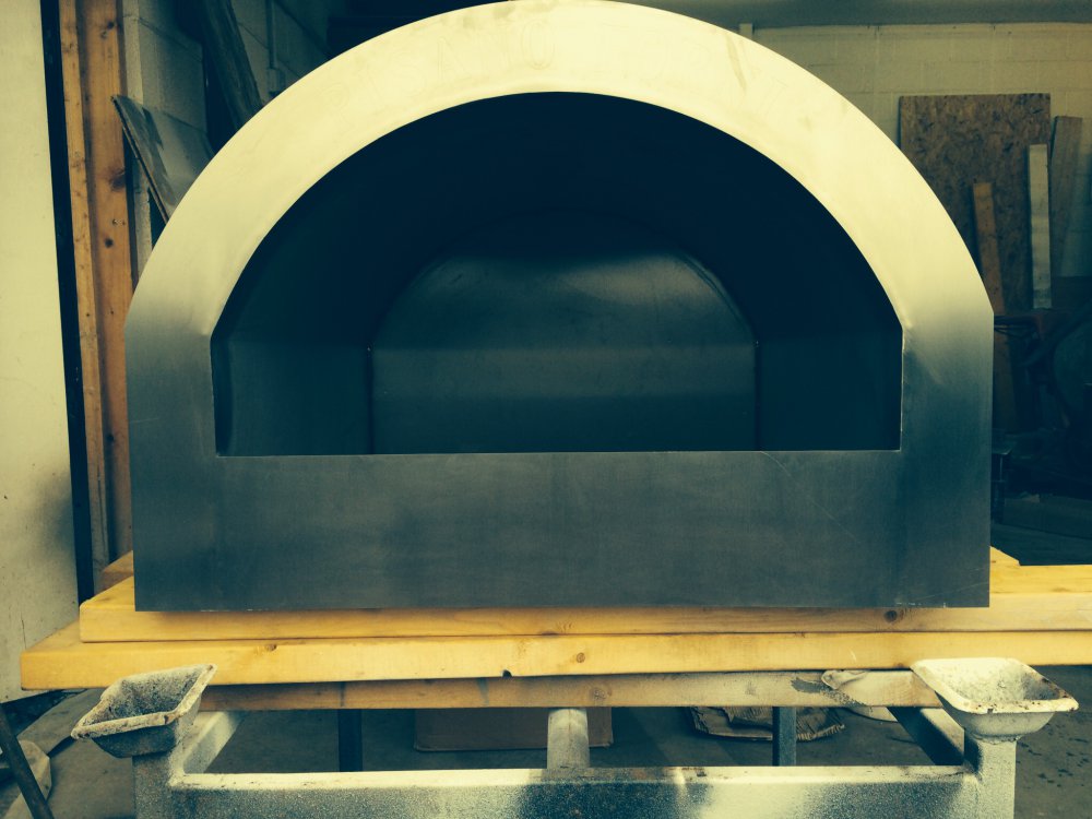

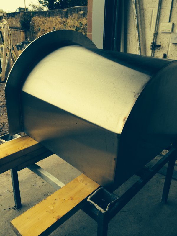

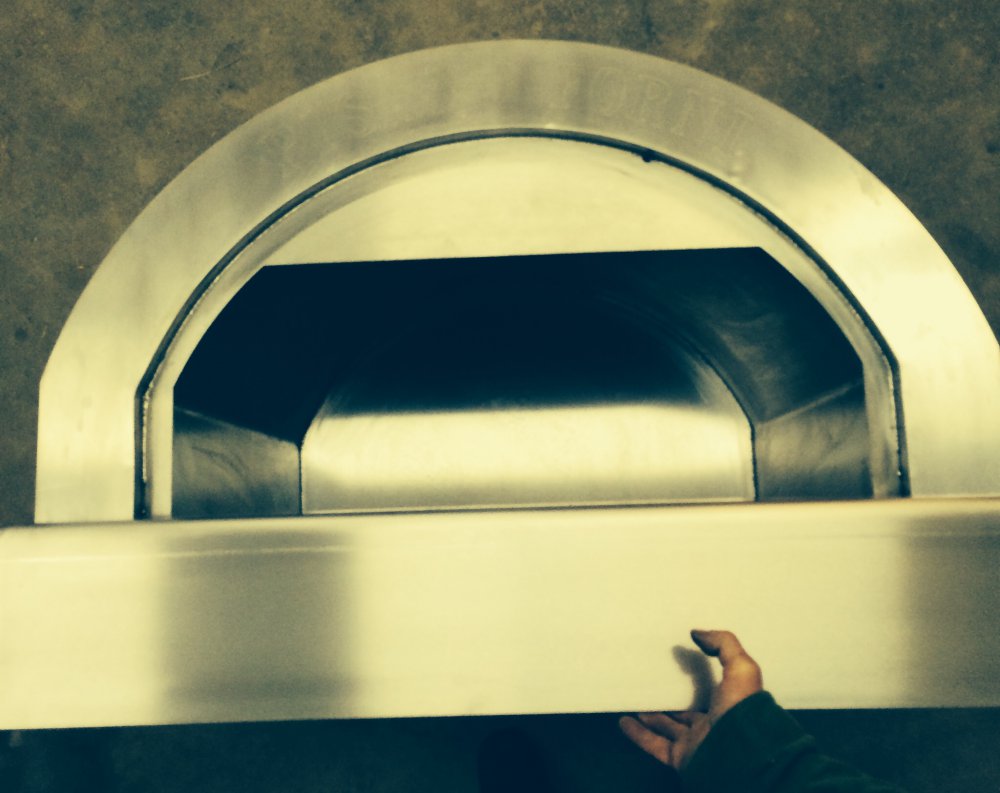

    image.jpg Base done !

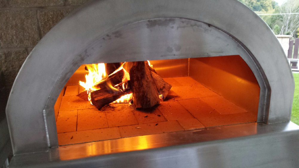

    Anyone for pizza! When it's upto full temp ' it will cook upto three pizza's in 2 mins ! image.jpg image.jpg

    Cheers ' Jim just trying to get it finished today as owners got family coming over from Italy tomorrow ! He couldn't resist it last night , and as soon as I had gone fired it up " lol , just skirts & door to finish today !

    Is that made from 310 ss ?

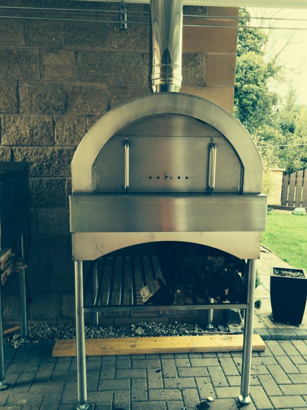

    :drunk::welder:Nearly there now! image.jpg

    Internal oven yes ' but you could get away with using 316 as long as you don't exceed 400 n odd degrees for extended periods of time , but the temp should not exceed 300 - 50 as long as it's not abused , over filled with timber draft bar fully opened , exedra !
