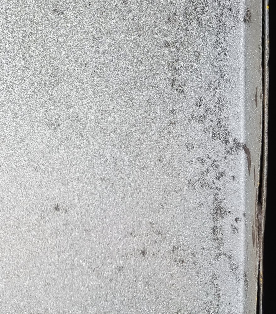

id make do at that if its just the engine compartment. give it a coat of 2k epopxy primer and a coat of 2k topcoat will last donkeys years without flaking offSorry should have specified this is 60 year old mild steel about 20-22 gauge. Here is the result after a quick pass just to get paint and lose rust then a slower pass to clean up. View attachment 341778
