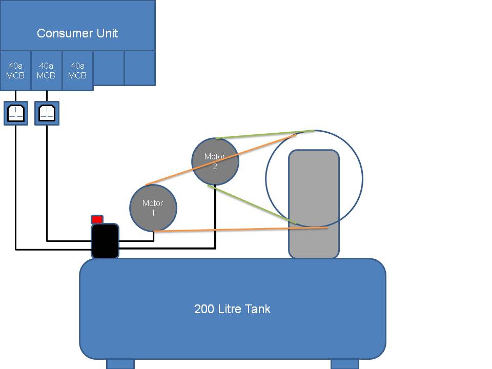

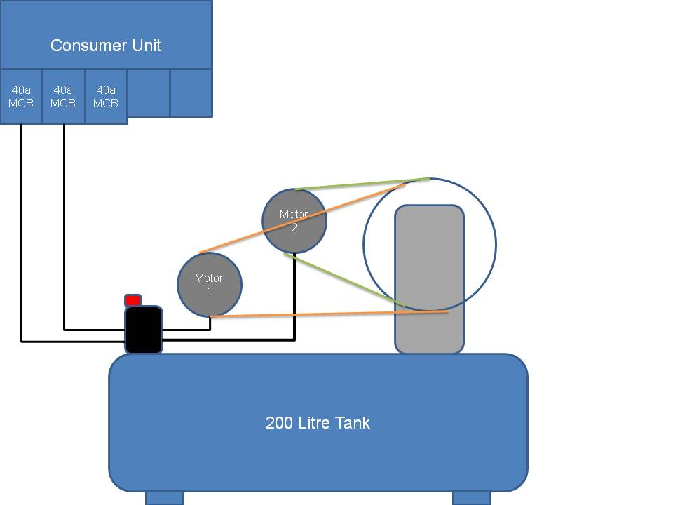

Ideally have each socket on a separate MCB.yes exactly that and the fact you have a 3 phase switch on the compressor already means you can switch both motors and just as if you had 2 compressors just plug both motors into separate sockets
Ah - thank you very much indeed for your patience. I was a little confused about this earlier. This has been incredibly helpful.
So, just to make sure I've understood it properly (and to help others thinking about the same thing):
So it looks like I just need:
- due to the nature of a three phase switch, by using it on a single phase circuit, I could use two of the three inputs/outputs in order to provide two independent power supplies to the two motors, with one input/output unused. However the manual on/off and the pressure on/off switches would control both motors simultaneously - regardless of the fact that they have power supplied from two different MCBs.
- I assume that the 3-phase switch is more than man enough to control the start-up draw of two or three 1-ph 3hp motors.
- Both motors will start and turn off simultaneously using the button on the top of the pressure switch/gauge
- Both motors will start and turn off simultaneously when the pressure switch/gauge detects the pressure in the tank has reached lower/upper levels.
- If the fuse on one motor blows, then the other would keep running but the compressor's performance would drop.
- I would not need to change the pressure switch.
- I would not need to change the pressure gauge.
- I would not need to change the drain/outputs/etc.

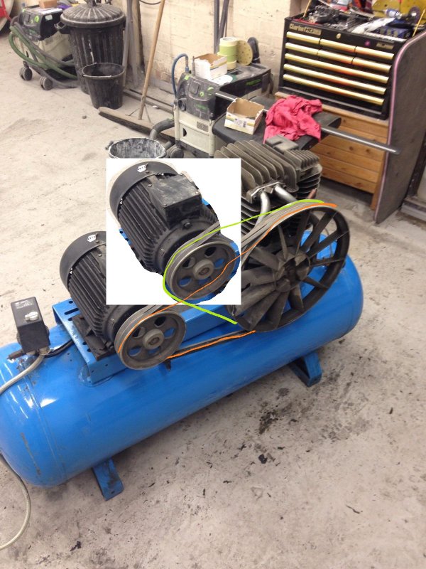

I would end up with a 5.5HP 23CFM pump powered by a pair of 3hp 1-ph motors which (I think) would give comparable performance to the original 5.5HP 3-ph motor.
- my 3-phase compressor (already got)
- a pair of 3hp motors (which I already have access to - though I might try to get a matching pair)
- The wiring in my garage to be completed, with two 40 amp MCBs dedicated to the compressor (in progress anyway)
- Some wiring to connect the new motors to a plug apiece - run via the single pressure switch.
Something like this?:

Right - I'll get on with making up the second motor mount and gathering the motors I need. Might take a few weeks but I'll report back with pictures.
I've updated my little diagram to show a pair of plugs for each of the motors (rather than it seeing to be wired straight into the consumer unit) to make it clearer for anyone else who's interested in following this thread.
Double check the current rating of the pressure switch it should give you the rating when wired in three phase as well as when wired in single.
The motors that you intend to use are they going to be the ones with a built in re-settable overload.
Your 3 HP motors are I guess about 2.5kw each so 40amp MCB's are overkill, 20amps should suffice.Fantastic!!!!!
