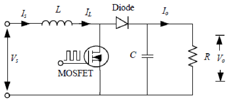

Wichwoman often works from home, if we pop out in the camper how's best to charge her Mac / Laptop?
Don't fancy an inverter as too much wastage and drain on the battery. Can you get a 12v Mac book charger?
A dc-dc boost converter will be far more efficient than a 240v mains inverter. You would buy one to match the required output voltage and current.If the Mac battery is over 12V then there is no way other than an inverter. If it is a 12V input, then just a cable should do.

Years ago I bought something branded "Juice" - cigarette lighter adapter straight into their box of tricks & then out to the laptop with one of the brand specific adapters. I've made I sound a lot more complicated that it really was & worked a treat.Wichwoman often works from home, if we pop out in the camper how's best to charge her Mac / Laptop?

No an inverter's output (in this context) is AC.It is still an 'inverter' regardless of the input voltage.
I disagree but with regards to efficiency from a battery source, mains equipment is usually terrible, which for me would rule out a 240v inverter.It is still an 'inverter' regardless of the input voltage.
