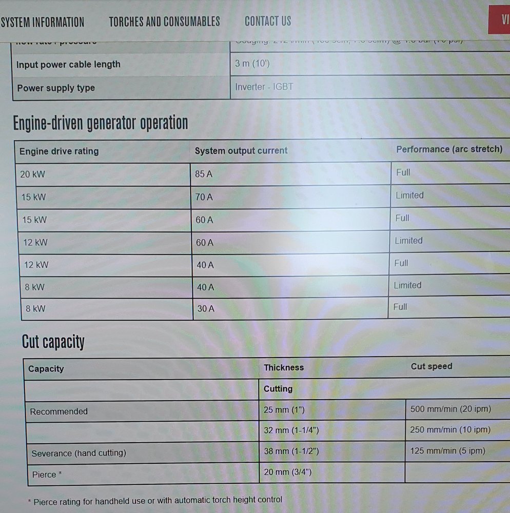

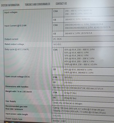

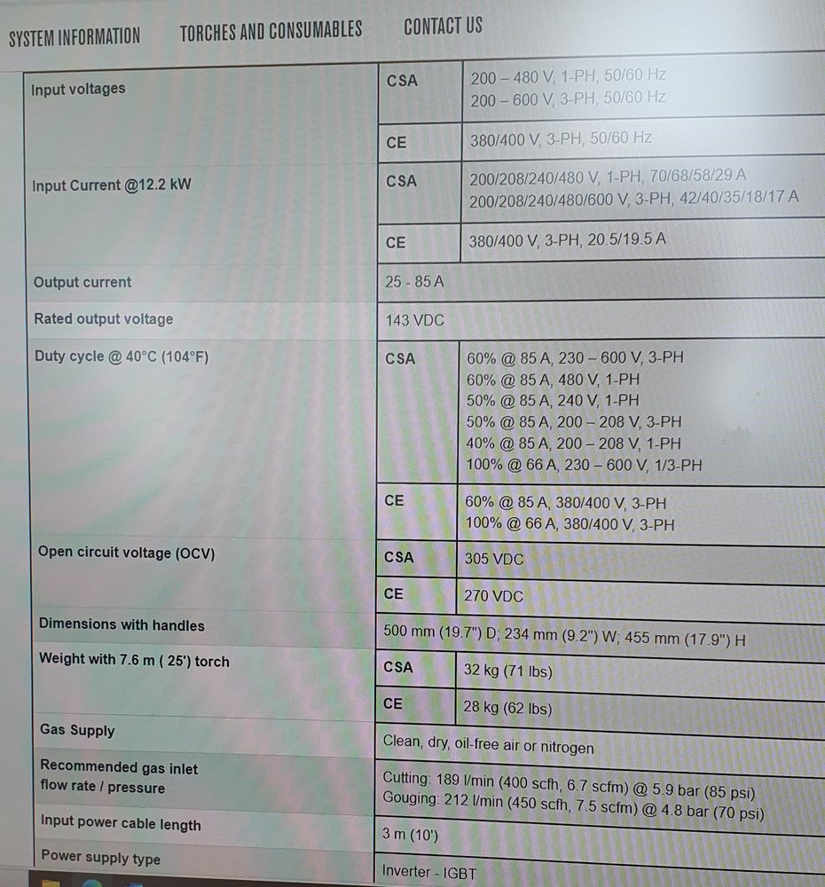

I am looking to run a hypertherm 85 from a generator. I've looked on their website and found this info i have attached.
I'm not sure i understand the numbers correct. Does it mean to run it at full power i need a 20kva 3 phase generator or would i need one slightly bigger?
I have previously used a hypertherm 105 powered by i think a 35kva generator and that seemed to handle it no bother at all.
I just want to make sure i buy a generator which will run the ht85 without issue.
