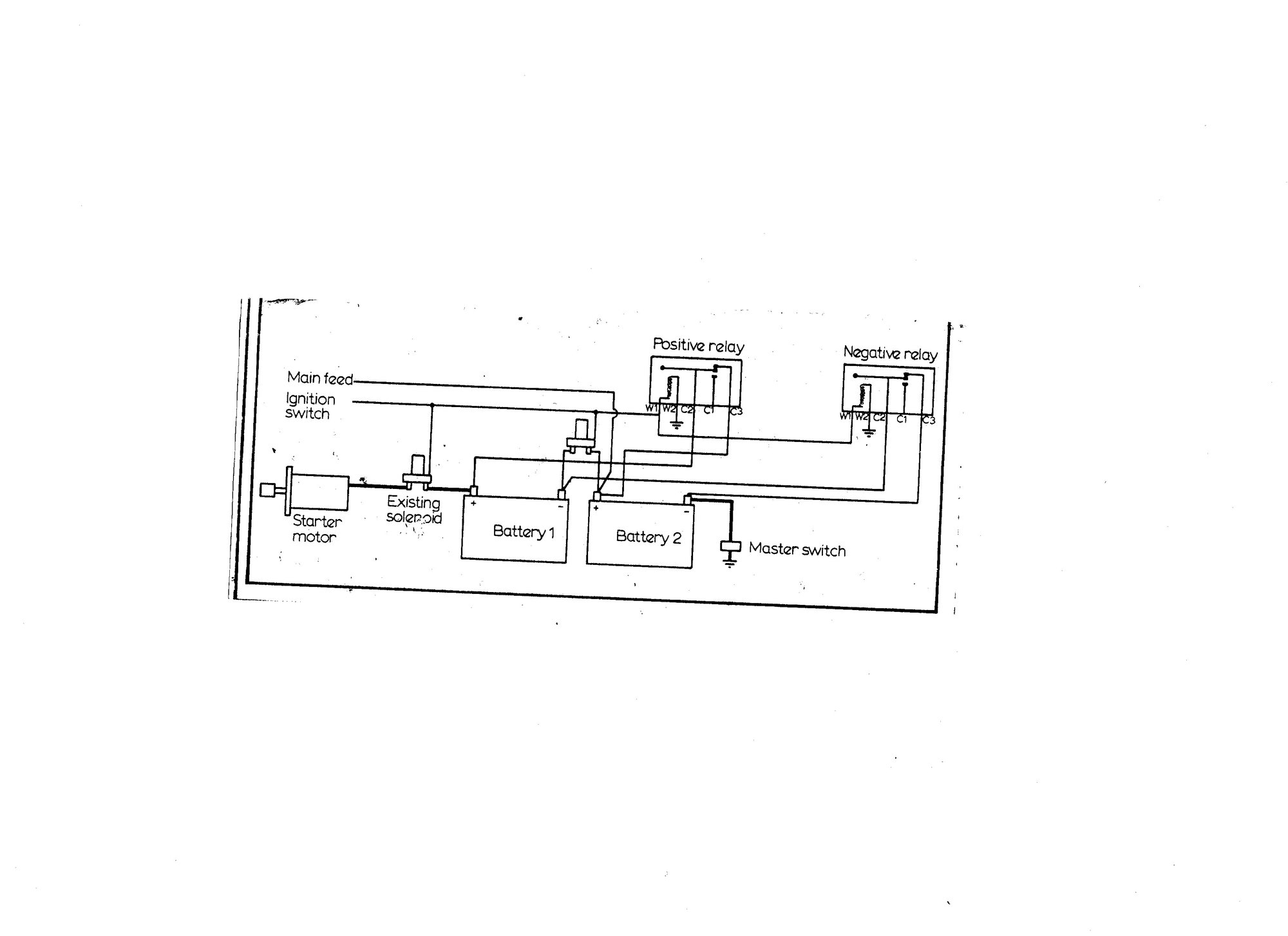

I think an actual 12v starter is rare and from a bus iirc, there are several bodges including spacers to use other starters so is suppose if you had the skills and equipment you could make a nice non bodgy spacer?
