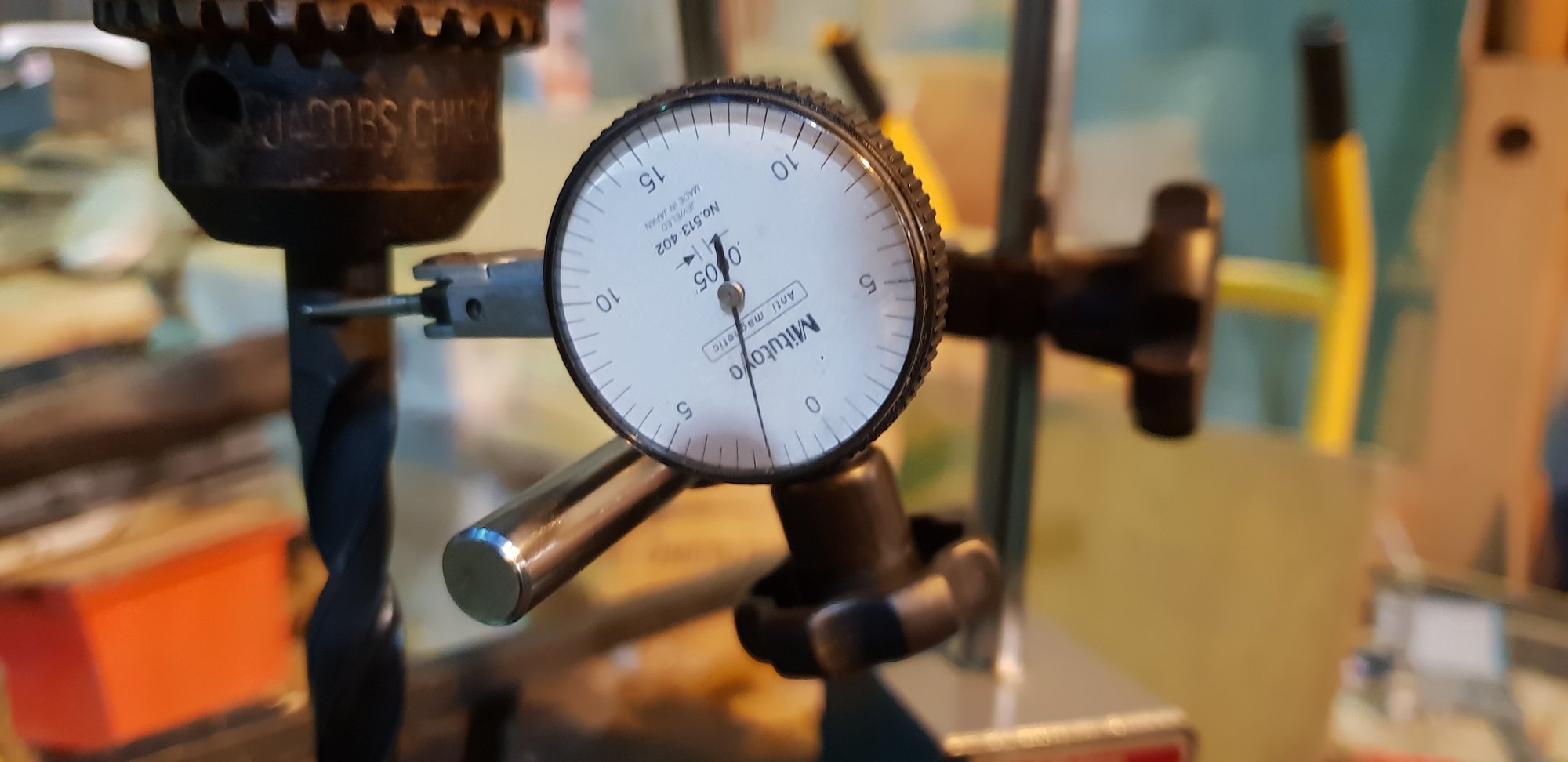

me too...run it fast and you wont notice2 thou? I'd say that was pretty damn good.
its nothing on a drill try it with a bit of ground silver steel in chuck. the drill isnt forced to be perfect but thats nitpickingJust noticed quite a bit of run out on my drill but when I measured it seemed ok.
What is an acceptable figure?
It varies from 0 to 2
