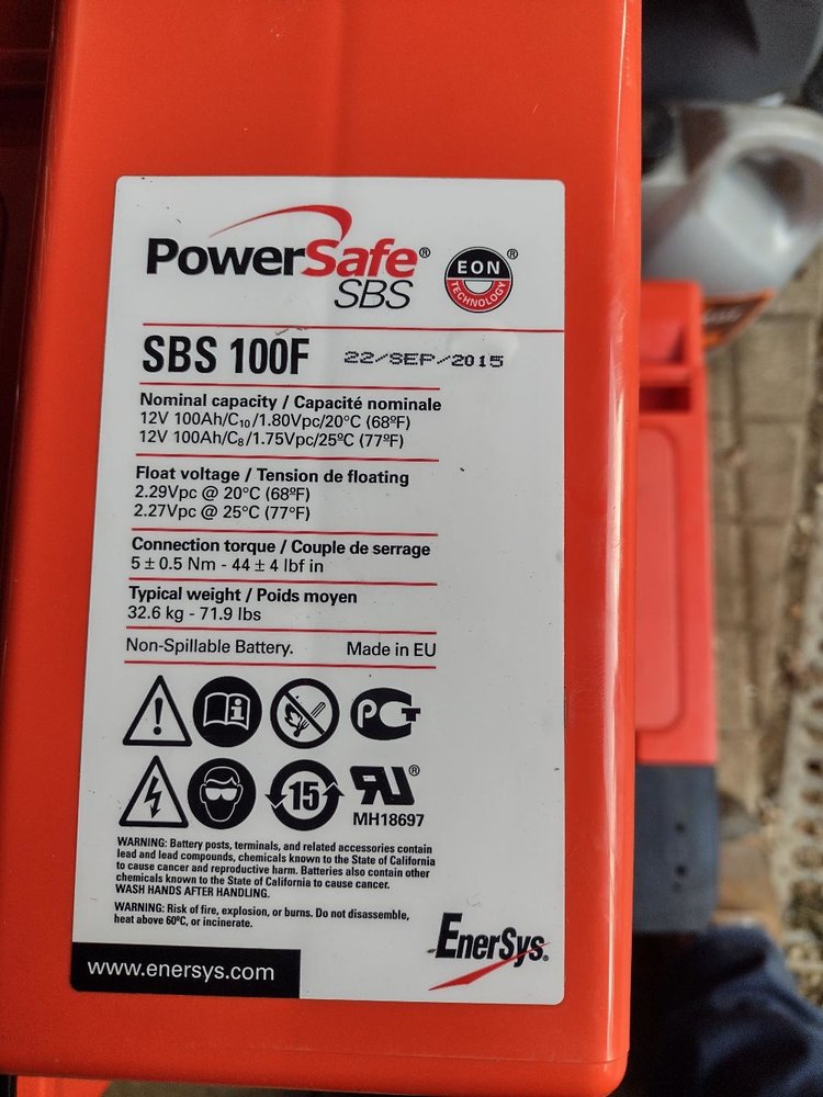

video ref30kw, means very little to me, how does that relate to 100AH batteries, would I need 300 of these???? View attachment 443302

Read my post above.30kw, means very little to me, how does that relate to 100AH batteries, would I need 300 of these???? View attachment 443302
The sums are easy kWh, not kW see...I like the sound of this idea, but "Confused from Northampton" (me) wants to know -
How long does the 30kw battery (of what voltage?) run consumables for ?
I assume theres a controller (& inverter?) involved (?)
And also, for simplicity, assuming there's a 240 volt constant draw of 1kw
I need an "Electrickery for Dummies" type explanation
I would add, my daily electric consumption is around 24kw...
