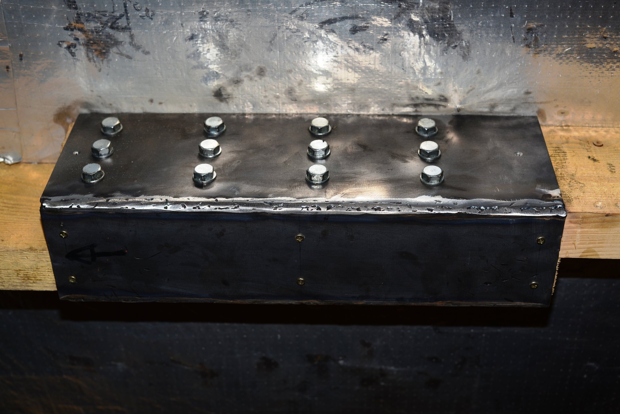

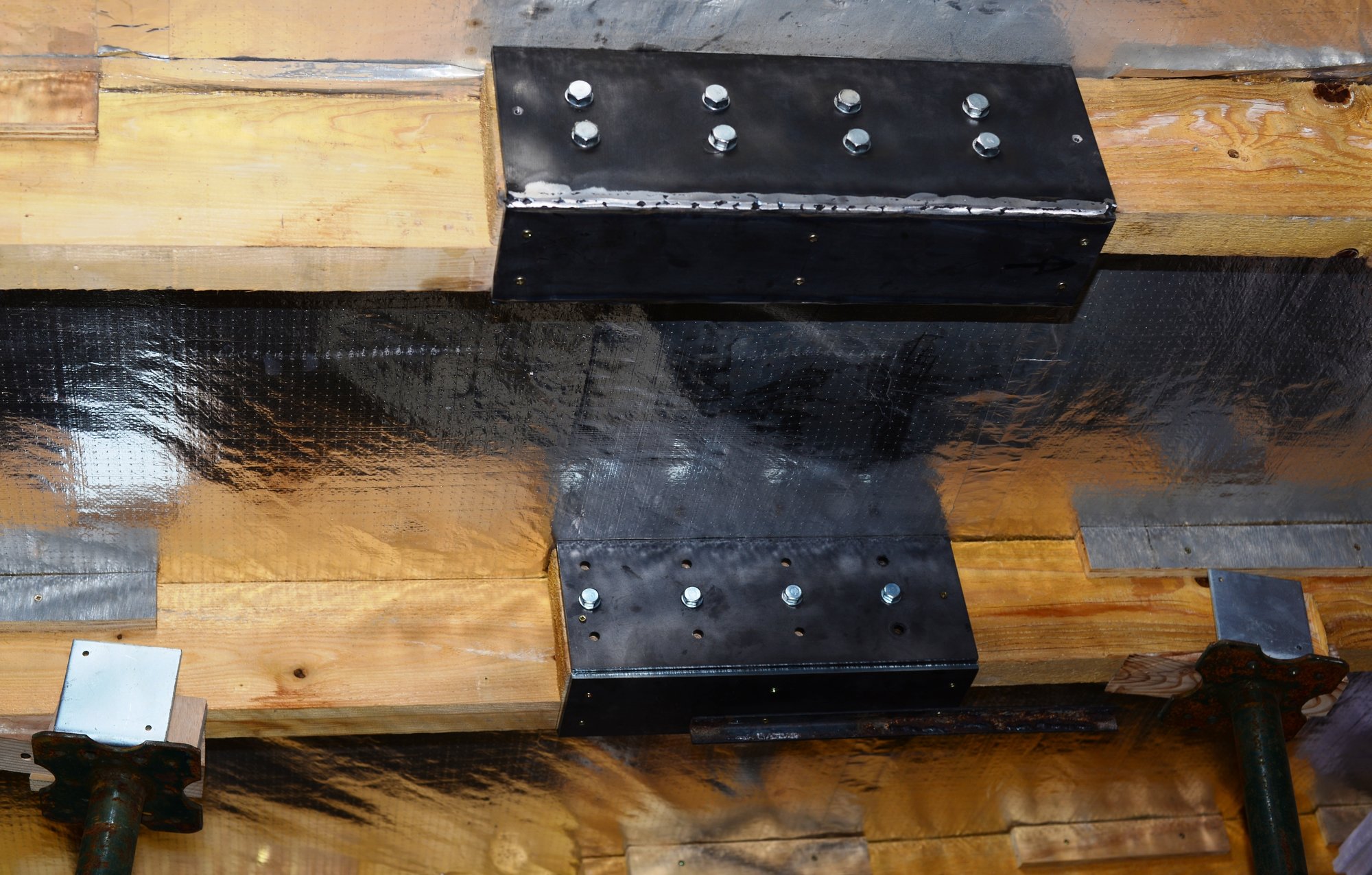

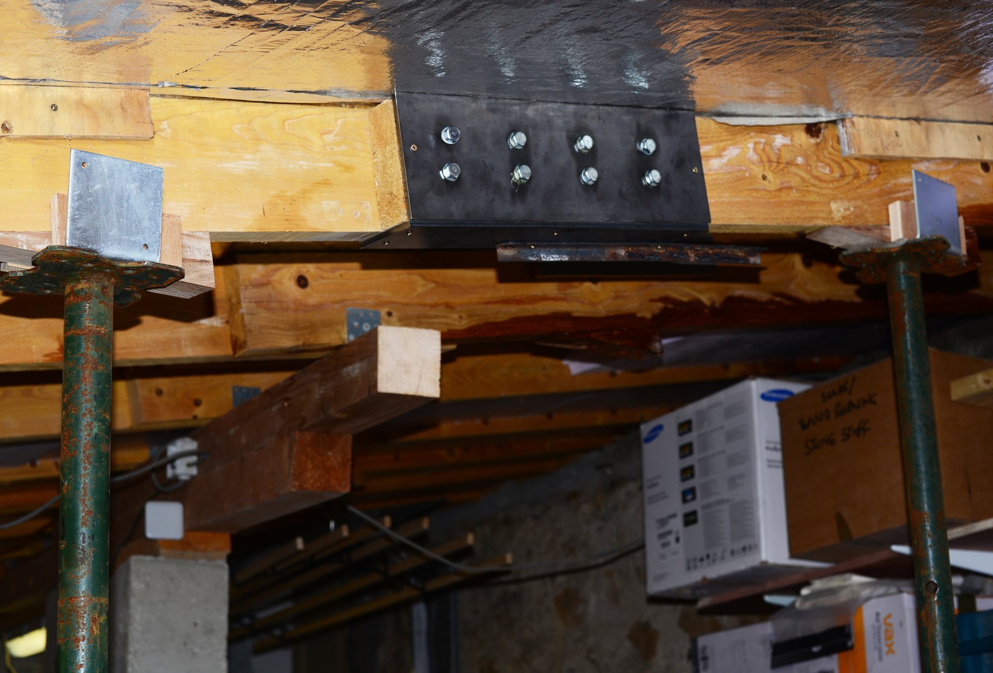

Thought I'd update this thread, even though it hasn't seen any activity for 4 or 5 months. I carried through with my cunning plan and got a local engineering firm to get 6 steel plates laser-cut in 8mm mild steel plate to my drawings. I took them down to France last month and bolted the 3 pieces in place for one of the beams (having previously wound them up on Acrow props to the desired height), ready for my welder mate to turn up (he works in the UK a lot despite living in France).
It's taken until now for him to return, and a couple of days ago he did the deed. He tacked the base to the sides with the plates in their final position, then we dropped the assembly down by one row of bolts (40 mm) and he then finished the job. For one u-section he used 20 rods (I know, I counted them as I cleaned up after), so there's plenty of metal in there.

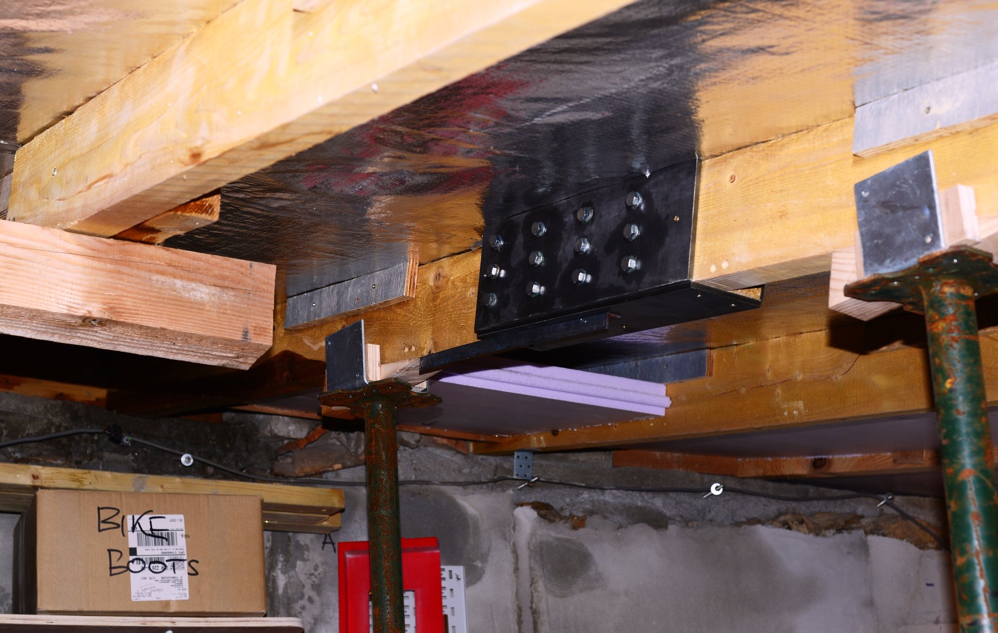

That beam is now supporting itself and didn't budge a jot when I removed the Acrows. The other beam has been jacked up and the plates bolted to the beam in readiness for him to repeat the treatment when he gets back from his hols next week.

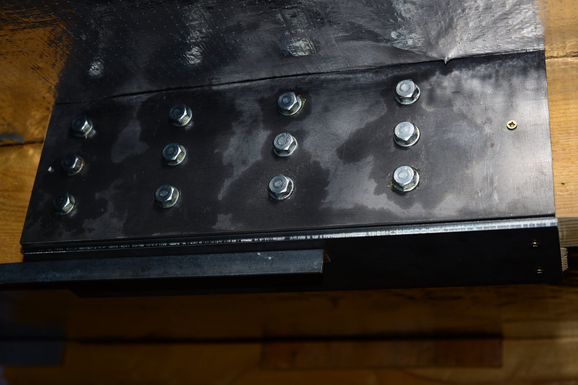

First set of plates bolted up and ready for welding
View from other side. One side has 12 bolts, the other has 8 and they are arranged to miss each other. I'm using M10 x 100 steel carriage bolts into the wood, with pilot holes pre-drilled.

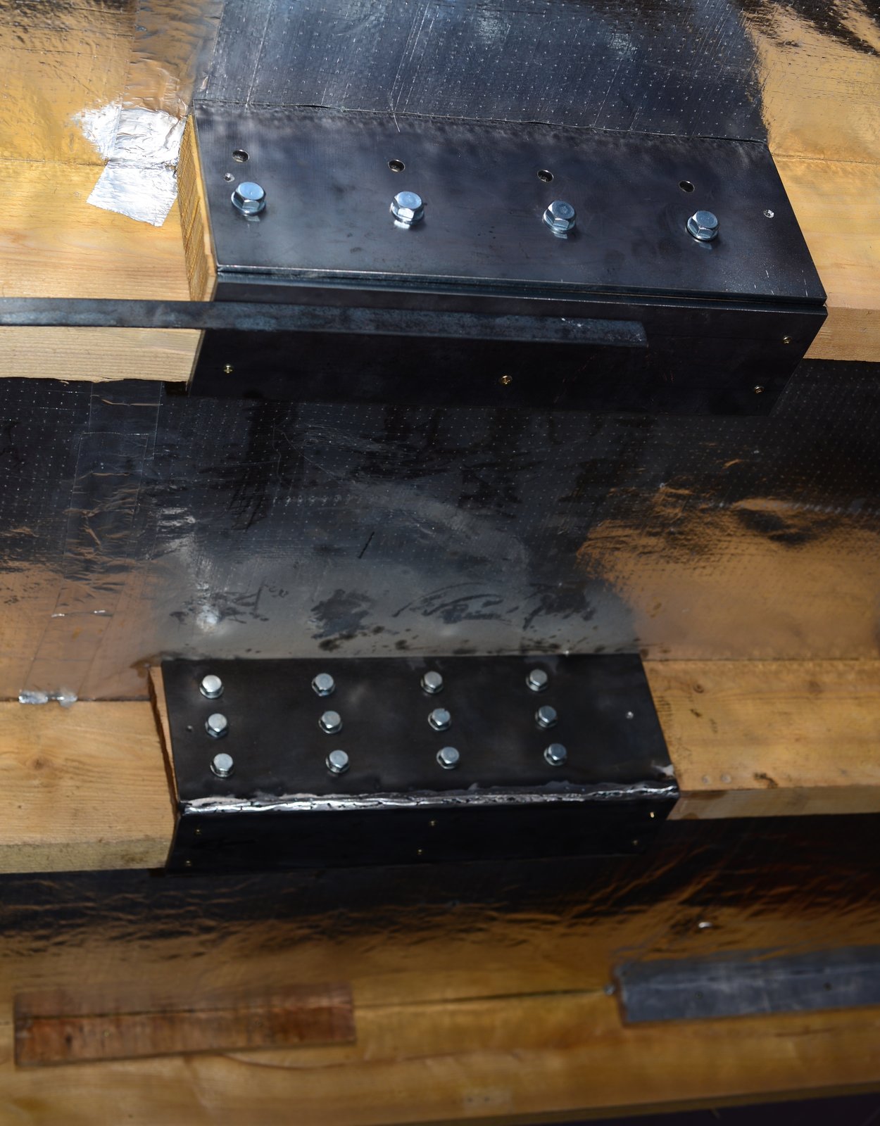

Finished article at rear of shot, second set of plates ready for tacking/welding at front of shot.
Other way about.
Close up of the welded section.
