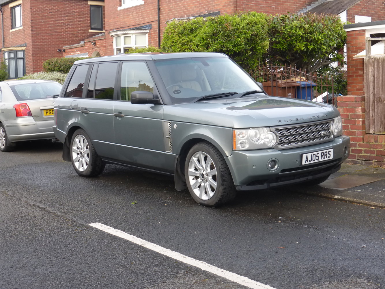

Out with the young today for a run a along the 69 to Hexham / garden center / riverside park , came to leave the garden center starts the car and warnings galore . DSC off HD on light on for Low range air suspension inactive and no lights , transmission failure quite a collection really
. Now I've had spurious warnings before but they usually sort them selves out , I didn't fancy the dual carridge all the way back at 20 mph so a short drive confirmed it wasn't in low range but it wouldn't change up till about 3000 rpm so the usual stop start a few times to see if it would clear it's self ended in a no go ! . Now I know it's got no mechanical issues so I resorted to the mechanical version of IT ( turn it off turn it on ) no tools in the truck other than a 30" bar for the wheels so couldn't disconnect the battery so I pulled all 5 60 amp fuses in the glove box and a few others with anything to do with anything
.So key ignition on start .............................. starts as normal no warning lights suspension raises lights on , quick drive on the estate through the gears
so riverside park quick ice cream and home .
