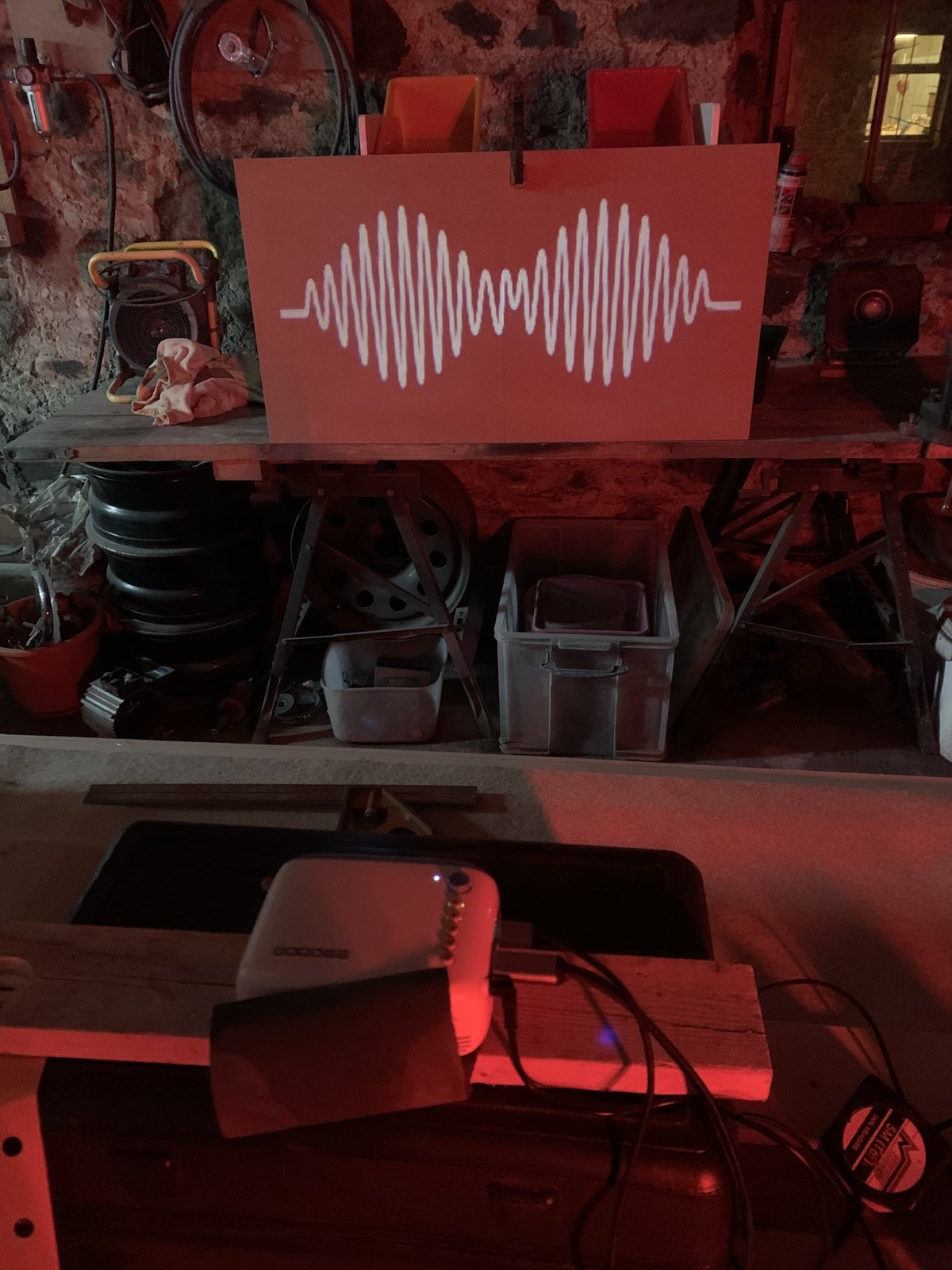

That's quite a bit bigger than I thought it would be.Well there’s 2hr in already.

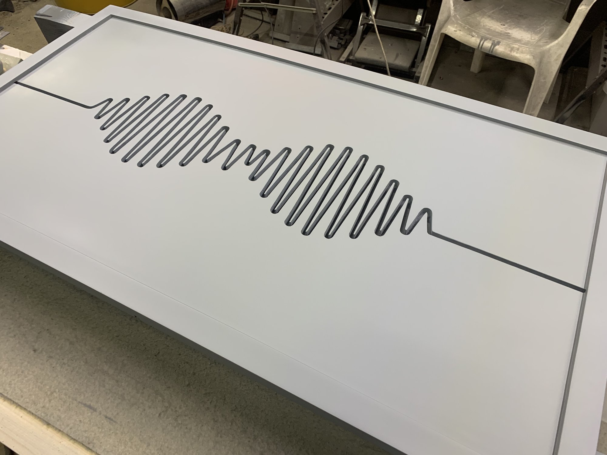

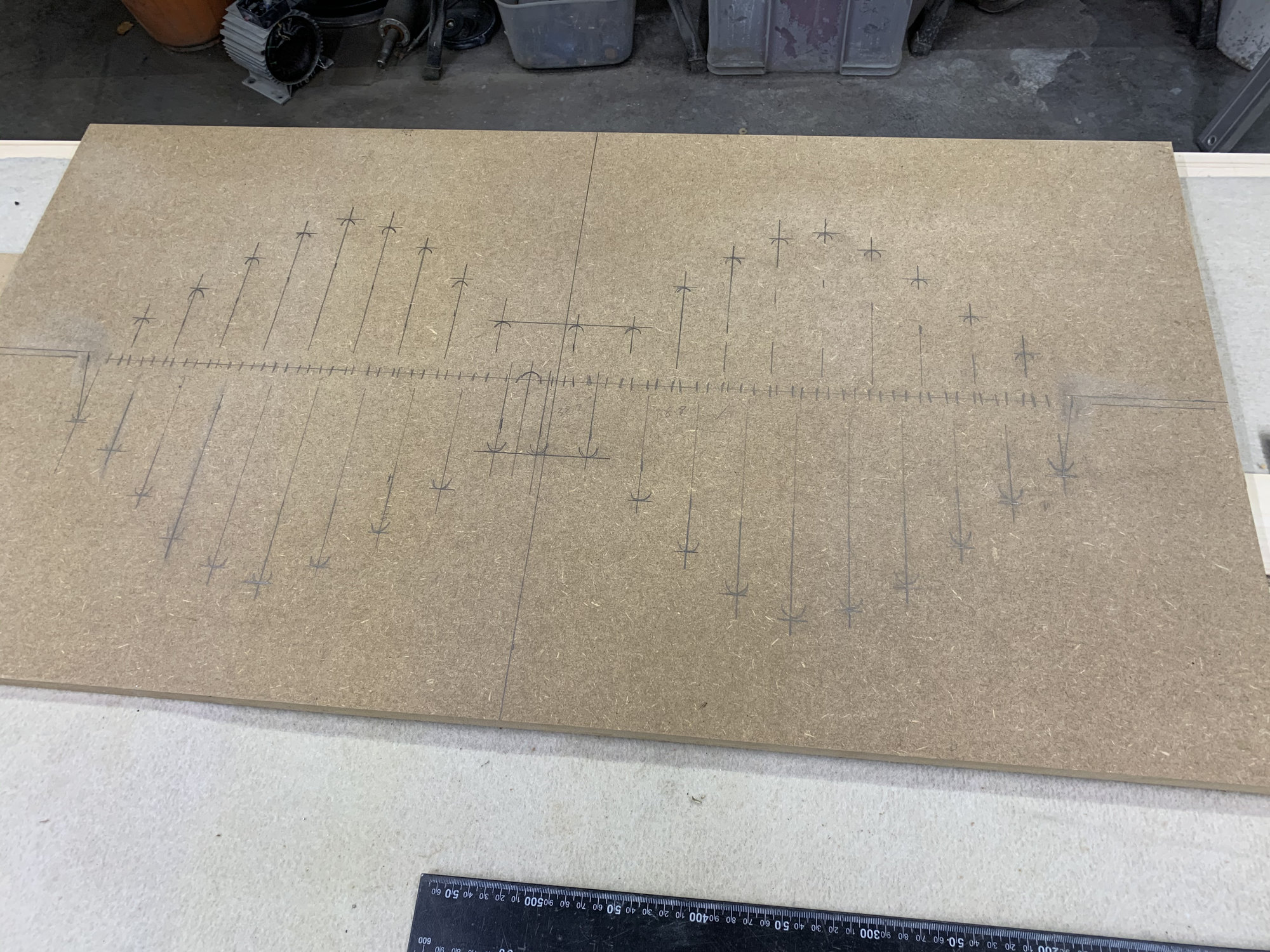

mused out small camping projector then spent a while making sure everything was bang on measurement wise. Started looking at the router and there’s no way I could use the guide bush. It leaves you blind.
think I’ll sink a 12mm bit into each apex, then use the edge of the circle at each end to straight line across using a fence against the router base.
View attachment 263289 View attachment 263290
I'd be tempted to drill all the ends and use my little bottle trimmer and a tracksaw track to join em up.
Yeah. Haven't tested mine out yet. Just a 3d printed jobbie. Bought it for those odd times I can't risk a slip.Been looking at those recently. Do they lock into the tracksaw tracks?
Farm it out no way that's being done by hand
I wasn't expecting a large display.Really?
It's just a series of holes, joined by straight lines.
Bore the endpoints first, then use a straight edge and top guided straight bit, to route the lines.
(Insert dowels in the bored holes to set the straight edge, then clamp + remove dowels.
You could set stops to prevent over cutting, the same way.)

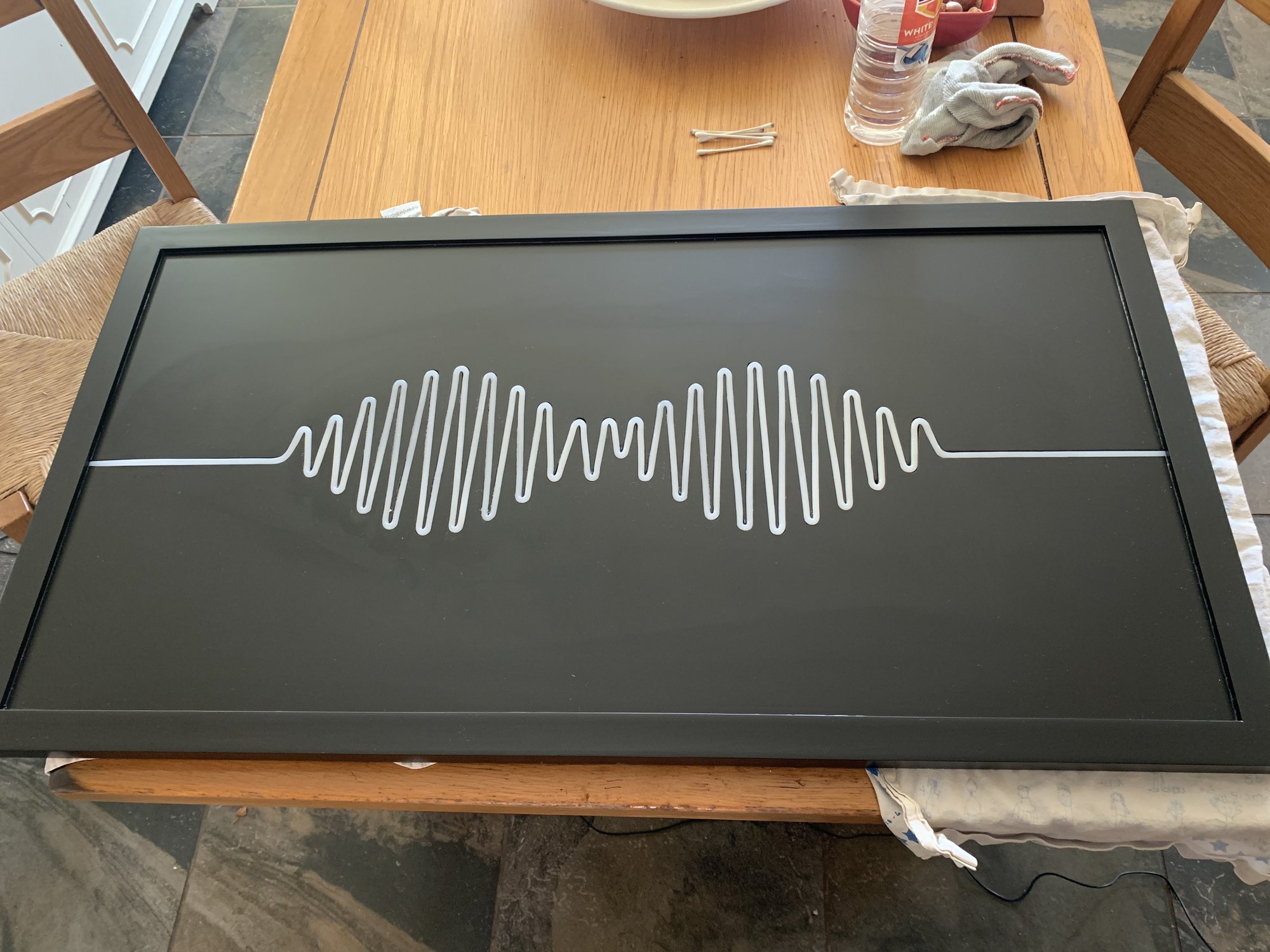

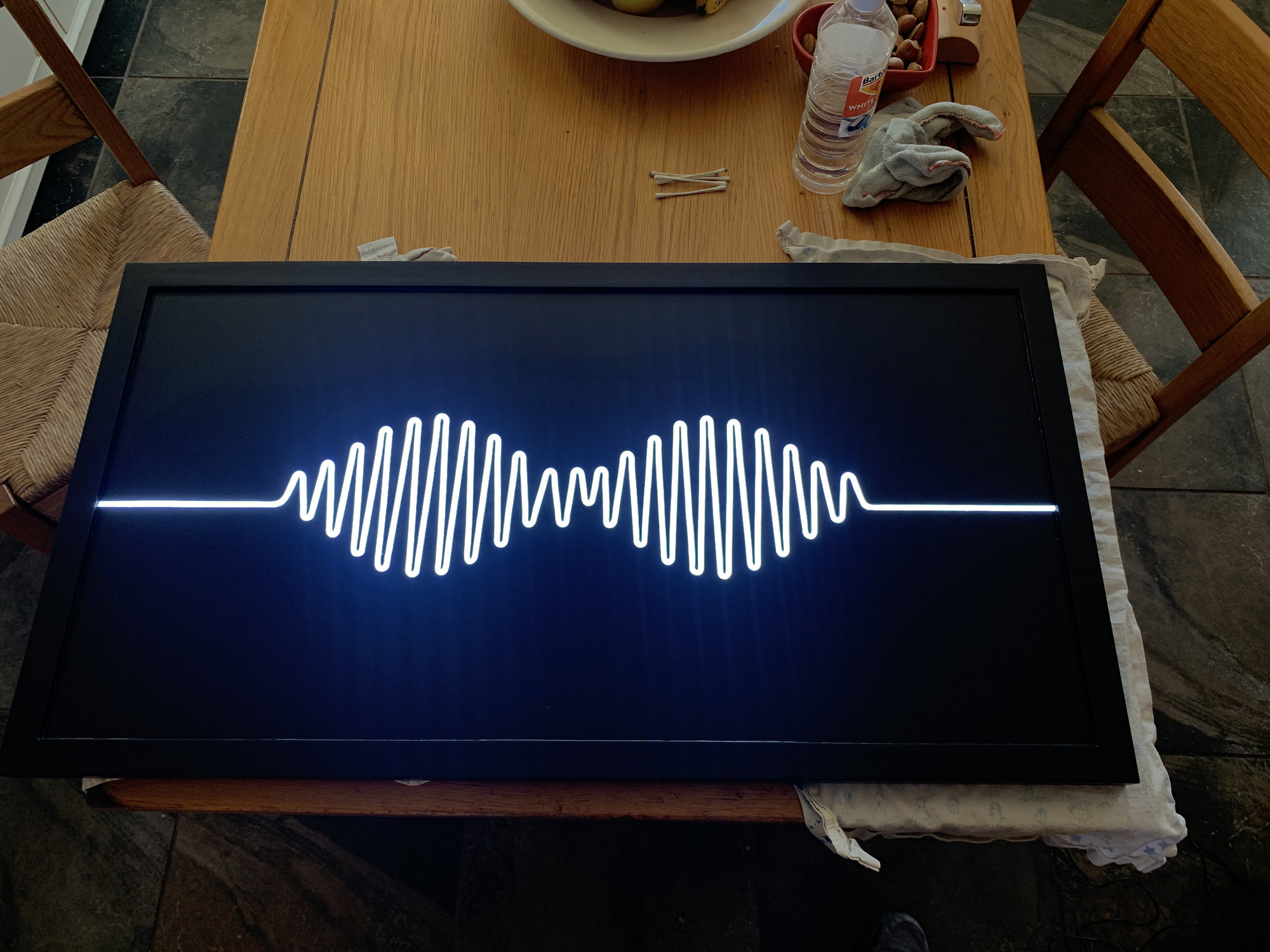

I'd assumed A4 size wrongly.
Spot on. Have you got a link or details of the LED strip you used?
