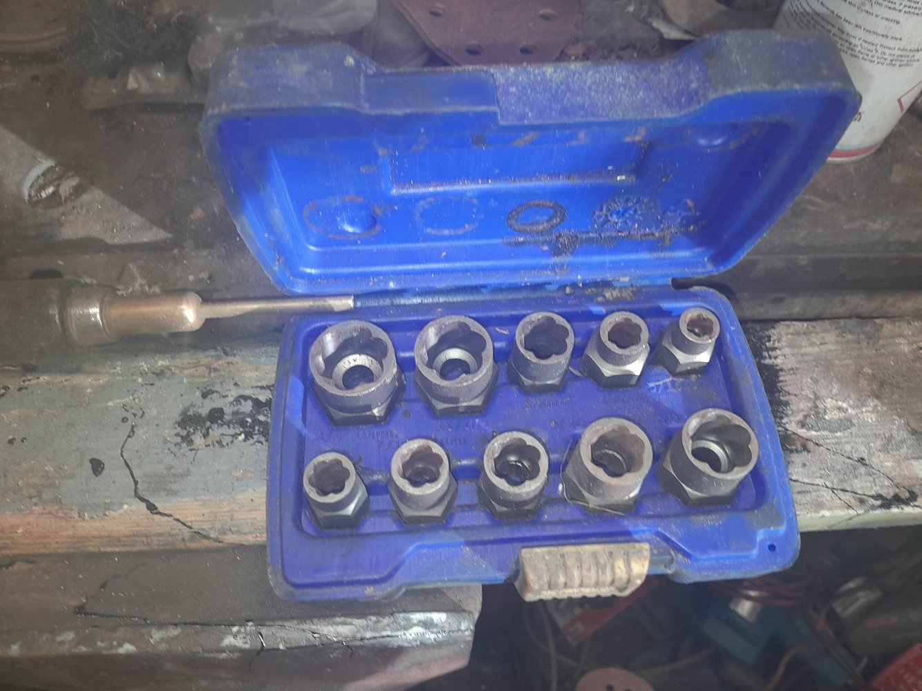

Twin grips would be my first choice, failing that as above, try a smaller socket - should be able to snap the head off if nothing else.
This is what I'd have thought too. Looking at the gap, it ought to fit with one of their slitting discs on it, then a stubby flat head screwdriver, or bit in a small wrench?Cut a slot with a dremmel and slitting disc, don't let it get too hot while cutting.
I know them as Irwin bolt extractors and already tried. Smallest one is too small and next size up is designed for 10mm (which is what the bolt head was) but that just finished rounding it off. I've used them before with pretty decent success but relies on keeping pressure / twatting it hard with a hammer to seat them. The twatting part is tricky because of access and also the whole radiator is on some form of sprung mounts so gets pushed forwards when you apply lots of pressure.Not sure if these things have been mentioned yet?

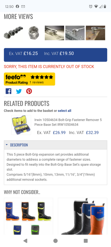

Minotaur Bolt Grip Nut Remover Set
Easily remove stubborn or broken fasteners with this Minotaur bolt extractor set. With a choice of five sizes from 10-16mm, use it to remove broken studs, pipes, set screws and grease fittings – the kit is comfortably equipped to take on a larger range of bolts in engines, furnaces and...www.toolstation.com
There are no corners left for it to bite - almost perfectly round now.I'd try the correct 6 point socket but with the end chamfer relief machined flat...and hammer it on. If that fails just a touch with the flame from a pencil blow torch (I assume the threads are into plastic and not a captive nut).
I have a mini grinder that doubles as a r/a 1/4" die grinder if you think it'd help.I suspect it's too rounded off for that and access for the big mole grips to apply enough force is minimal.
