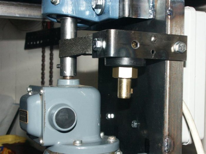

Pretty much what's already been said... the carbon brush ground particually (more for long term reliabilty). I like the idea of 0-90* adjustment but can see where you're coming from- quite a bit of extra work if you rarely need that adjustability. Given the size of the frame (relative to the face plate) if you added another bearing to the shaft it'd work on it's side 'as is' though? With a roller stand that'd let you use it for longer work should the need ever arise without needing a step ladder to reach
Simple stuff aside I don't do electrics but if you going to add a torch holder how about setting it up so that the welder can start and stop the table with the arc?
