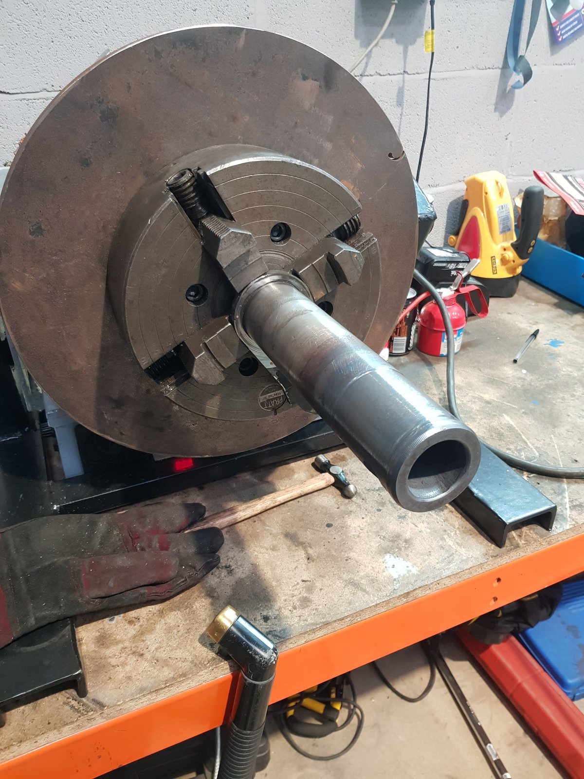

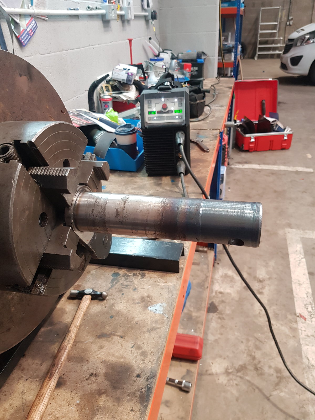

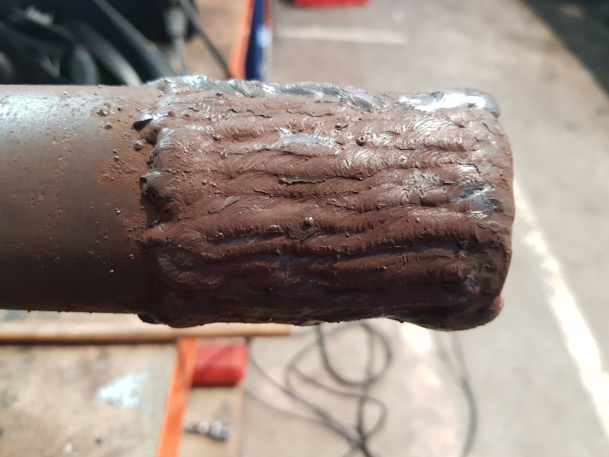

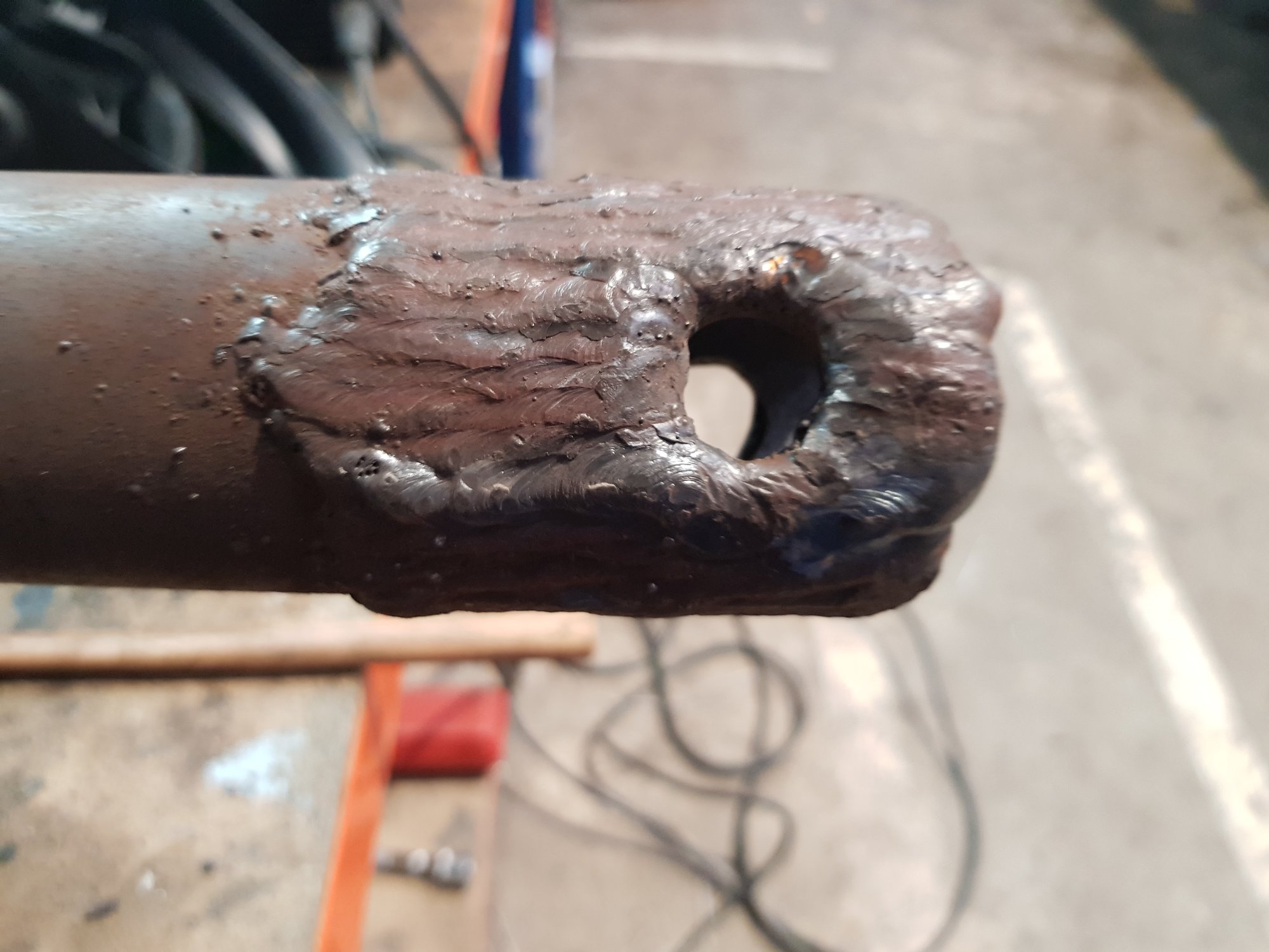

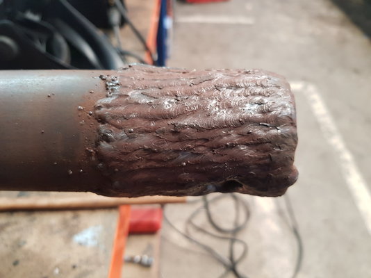

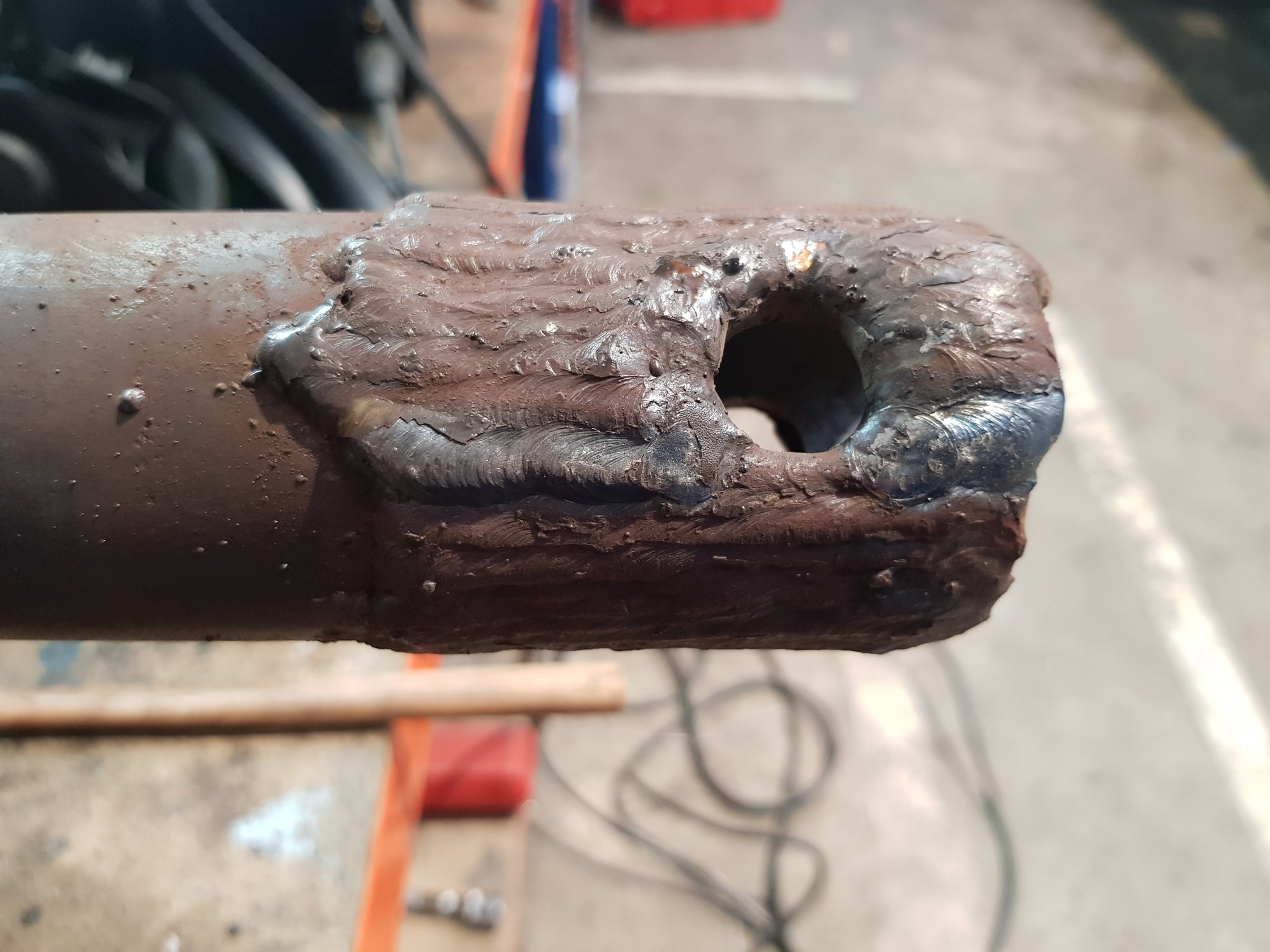

zzr1200 Working at 650 ft on open steel work. Messages 6,690 Location Glapwell, Chesterfield, Derbyshire, UK Mar 14, 2019 #122 Padding beads on a pivot pin before re- machining back to size. Life's so much easier with a rotary table. 20190314_095849.jpg 329 KB · Views: 126 20190314_095731.jpg 357.5 KB · Views: 118 20190314_110126.jpg 328.1 KB · Views: 120 20190314_110122.jpg 315.2 KB · Views: 119 20190314_110131.jpg 262.6 KB · Views: 113 20190314_110129.jpg 330.7 KB · Views: 112 Last edited: Mar 14, 2019
