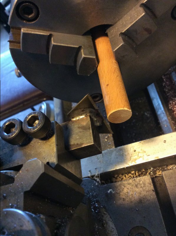

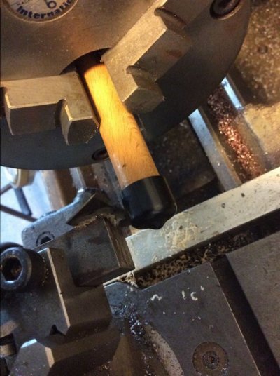

HughF Member Messages 6,490 Location Work: Dorchester, Workshop: Corfe Castle, Wife's place: Frome Jul 16, 2015 #27 Job done, can still count to 21... Soft solder, bit of mild steel bar, Stanley blade. Cut down 55 caps in little over 30 mins.

HughF Member Messages 6,490 Location Work: Dorchester, Workshop: Corfe Castle, Wife's place: Frome Jul 17, 2015 #31 They're pvc caps, used in industrial painting for masking things. We needed them trimming down by 15mm.
