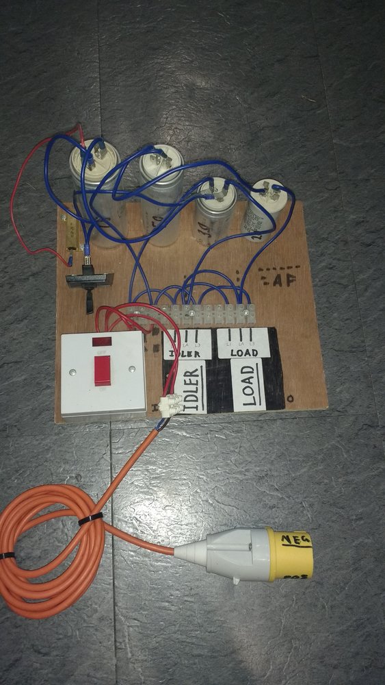

I'm not starting this project from scratch I must start out by saying. The "guts" of it, pictured below was thought up by a mate on another forum who successfully used it until he had 3 phase laid on.
It's clever (imo) as it uses a 110V transformer rewired as an auto transformer by connecting primary and secondary in series to give 230+110 so in reality in excess of 350V.
I've a big 5kVA trannie I can repurpose.

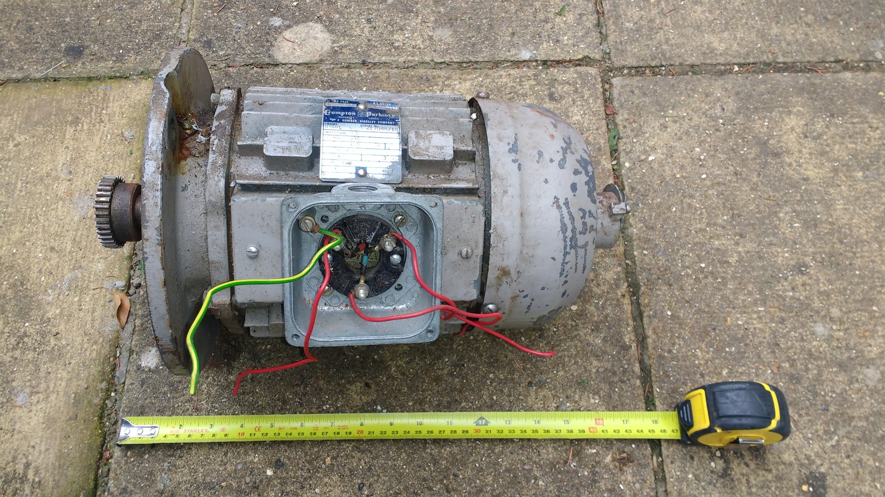

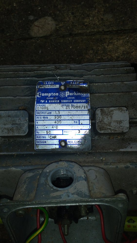

Off to the garage to see what that big old motor is I kept and have been meaning to use for "something" for about 30 years!
