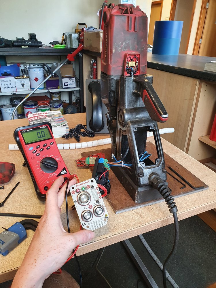

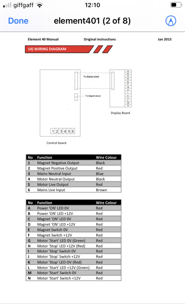

Have a rotor broach element 40 here, it's fallen off a scaffold so is a bit banged up, motor won't run. Magnet is fine. Suspecting one of the relays is damaged or the switch. Dose anyone have a wiring diagram for it by any chance? Run switch is pushed, green run light stays off, red stop switch light comes on. Resistance of wires and motor checks out ok. And audible click can be heard when both buttons are pressed.
