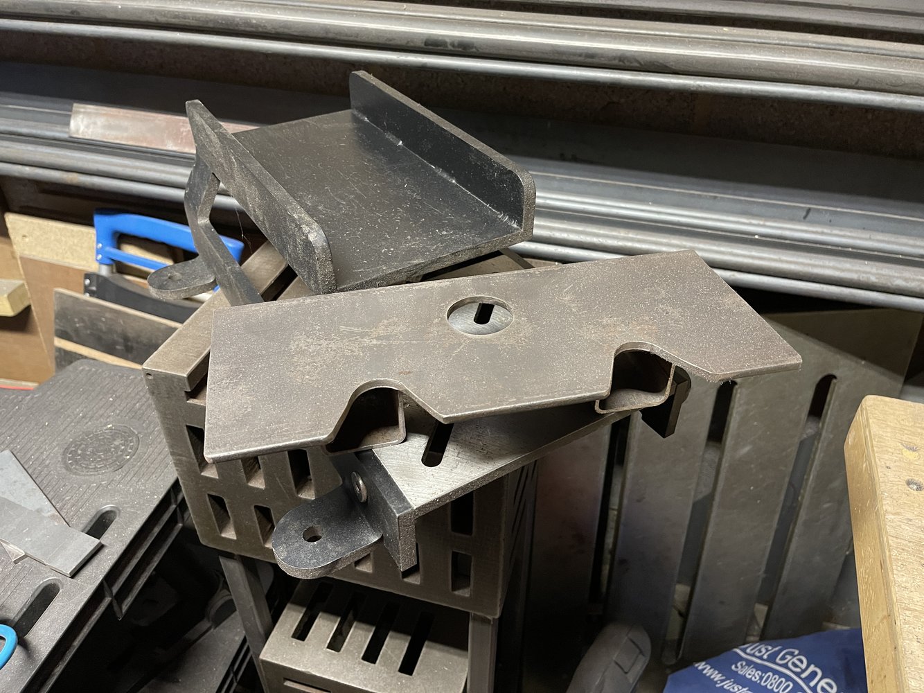

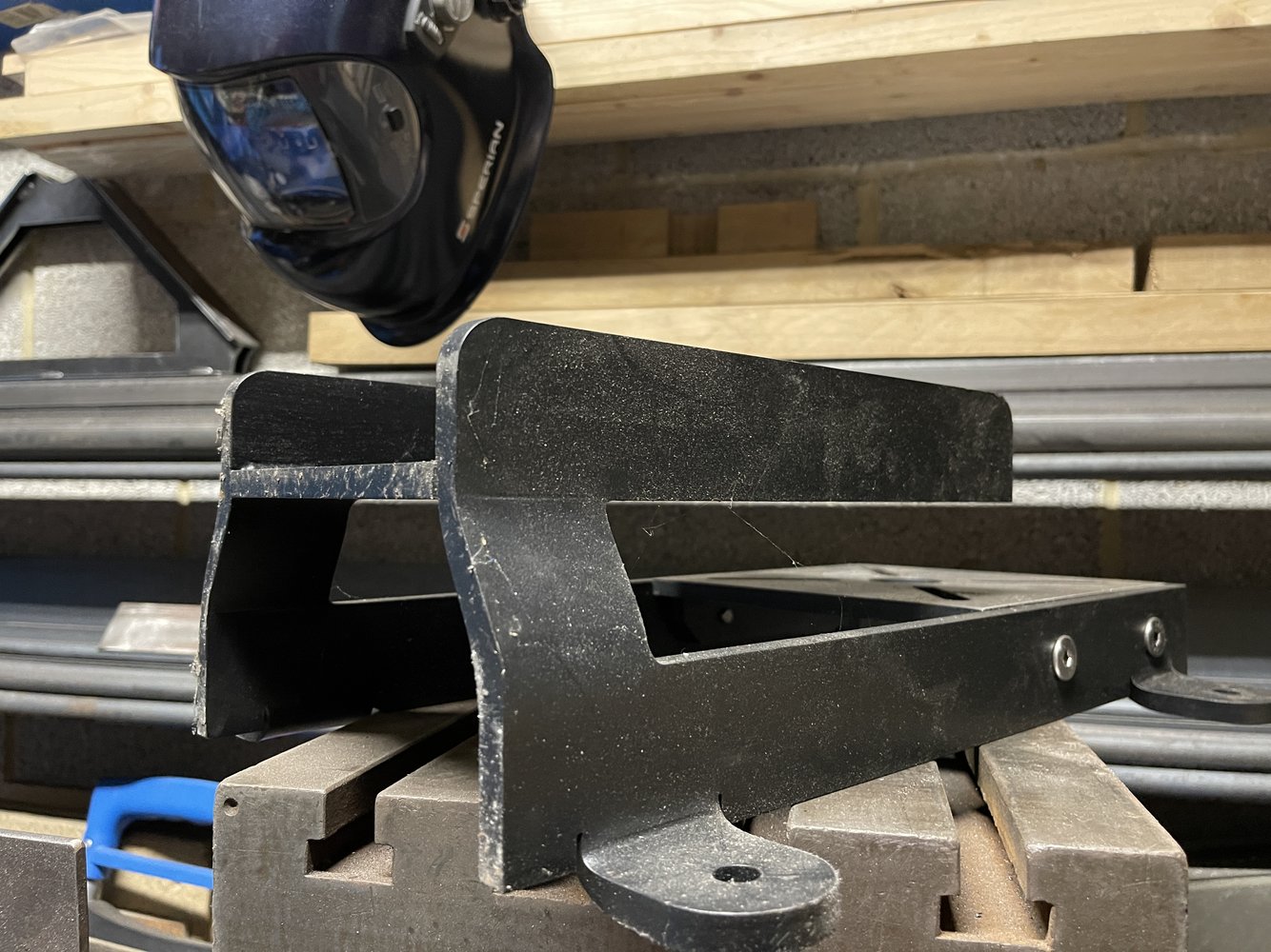

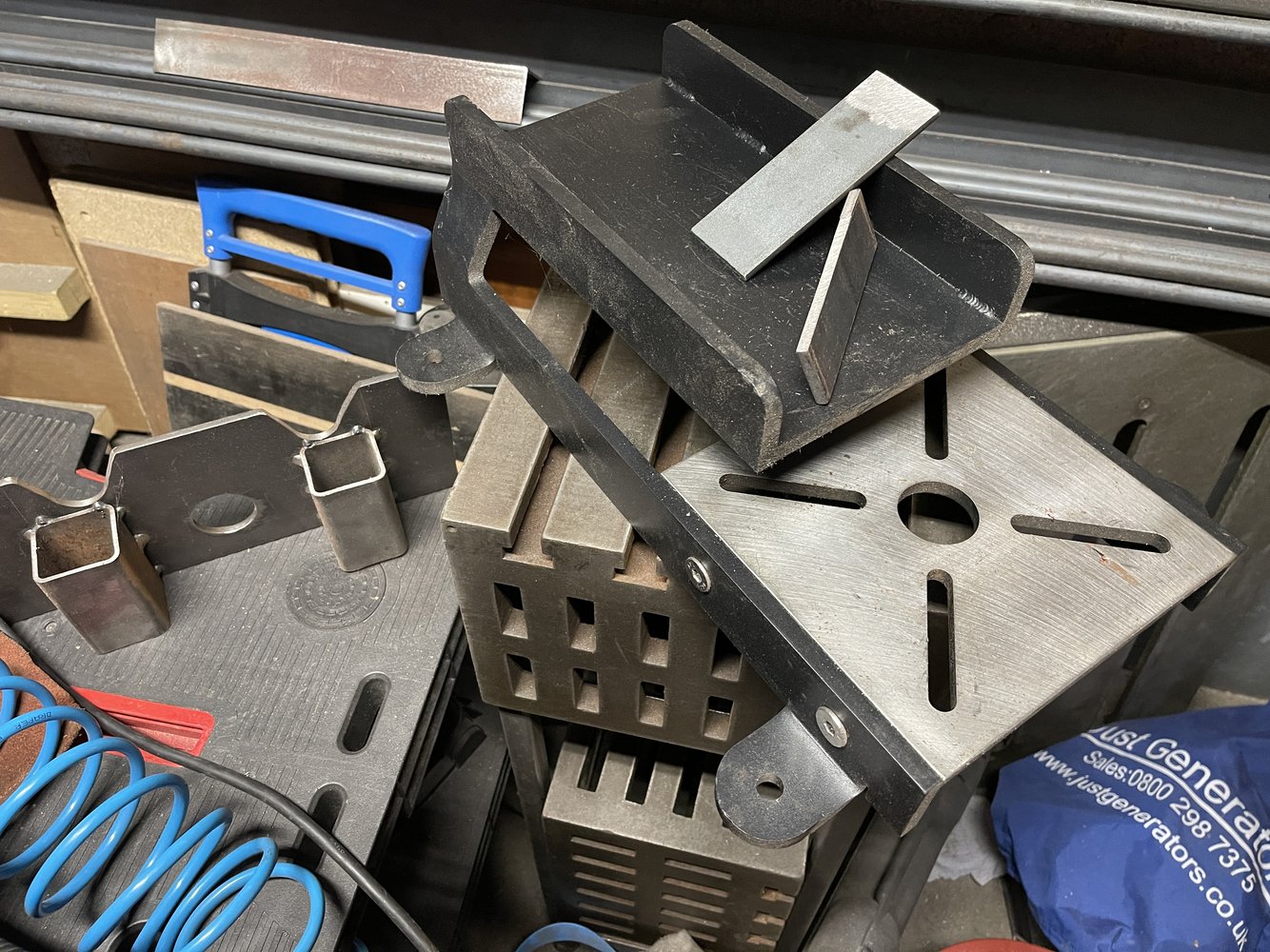

The magnet is beefy.. The manual recommends using 25mm steel or backing plates to get the desired grip bit i used it on my custom mag drill press that uses a large 10mm plate for it to sit on and that actually worked just fine but just to be safe ill be getting 1 inch plate just to make sure it never breaks loose while cutting ! Also i did notice the magnet its self generates heat so things can get rather warm near the area.. something i did not experience with the evo drill
