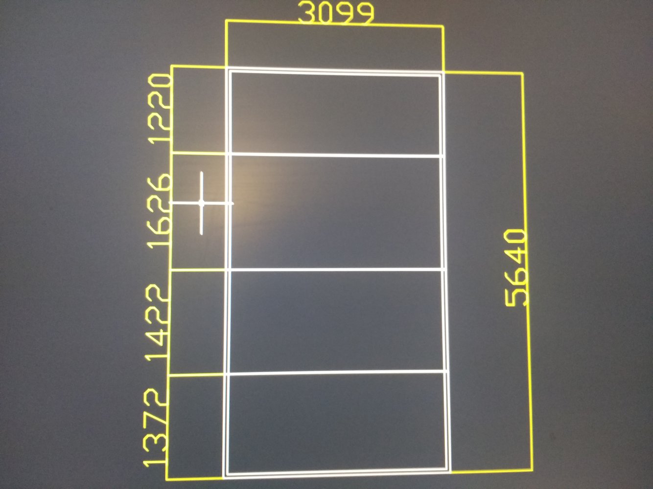

care to stand on it yourself with only a 3x2 and 0.7mm thick steelAre you really saying i need a 6x2 purlin to hold some 0.7mm pressed steel sheeting over a 1.6m span??
Seems pretty excessive to me!
Right ho @julianf

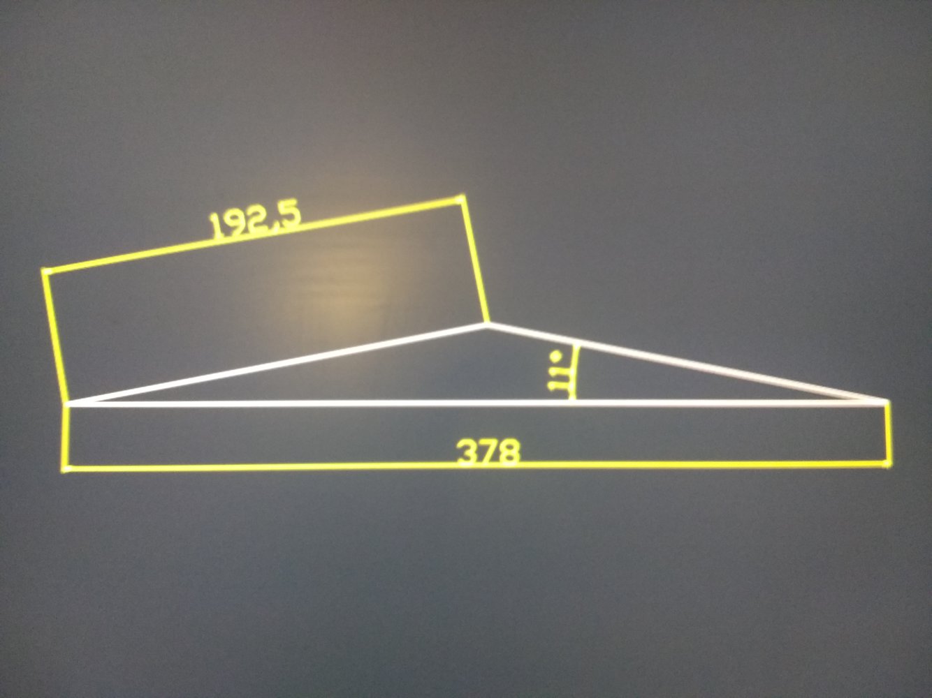

what’s your pitch (approx) and where is the building?
How long is the slope?
Are you looking for building regs approval or just getting it done/exempt?
pitch is 11 degrees
slope is 1.92m from ridge to, umm, eves (i forget half the terminology - the wall)
does not need any paperwork
