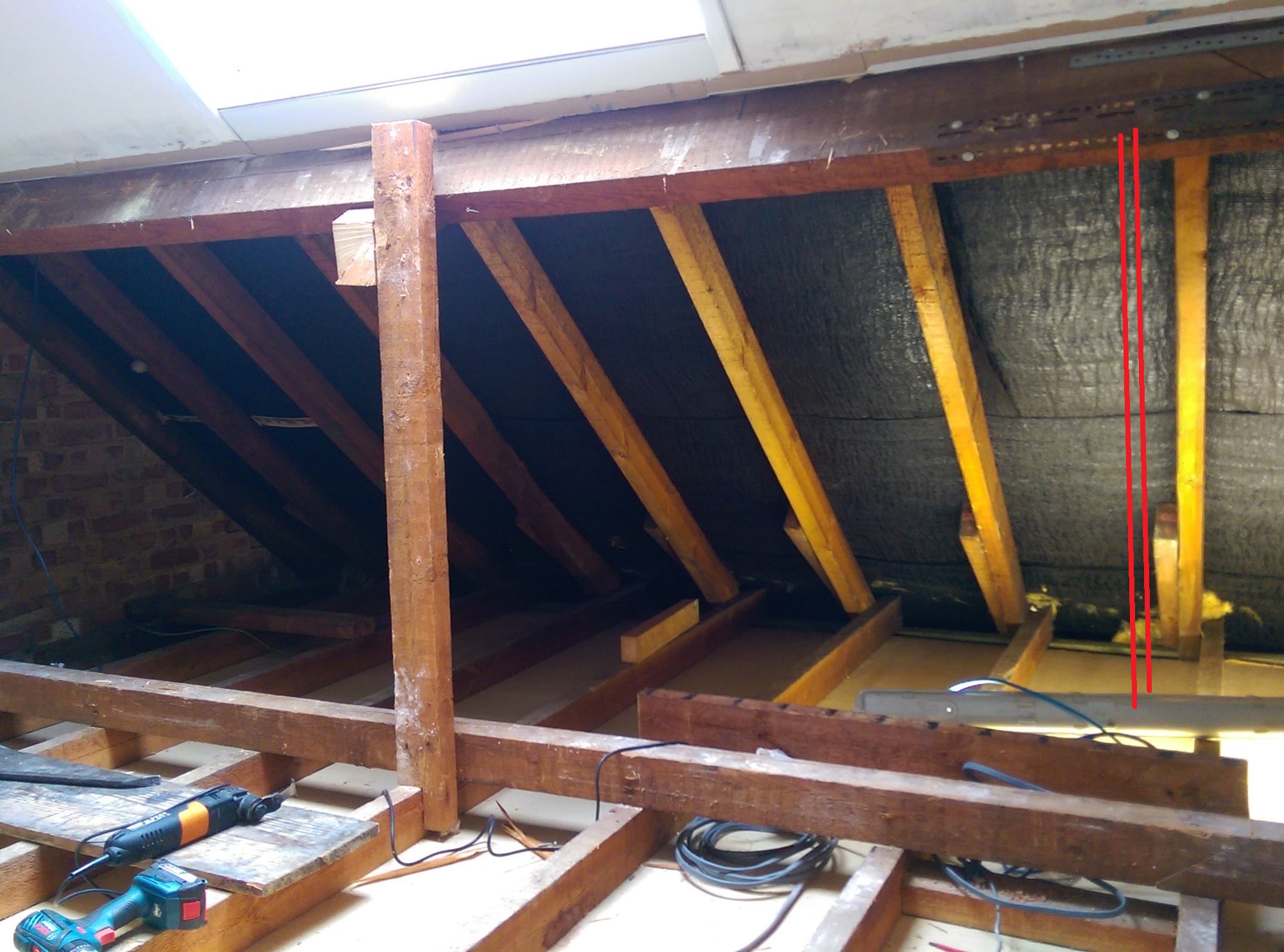

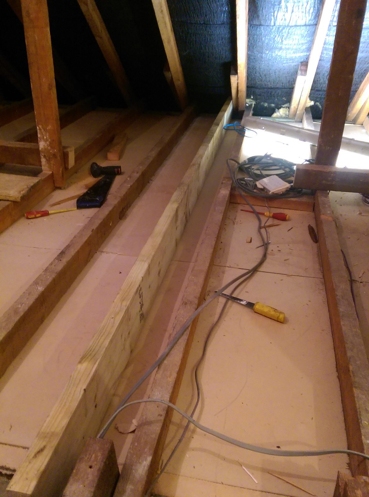

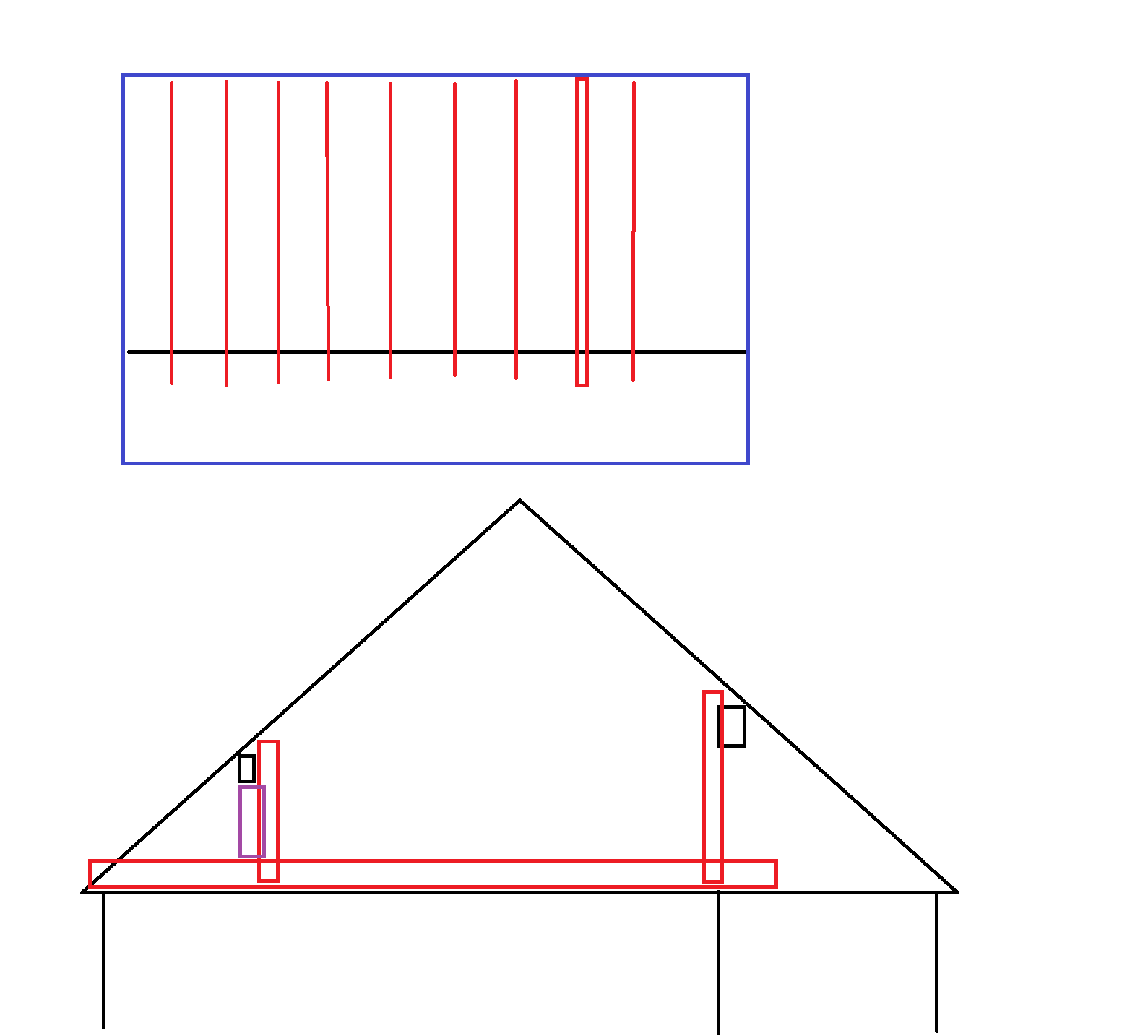

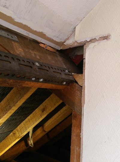

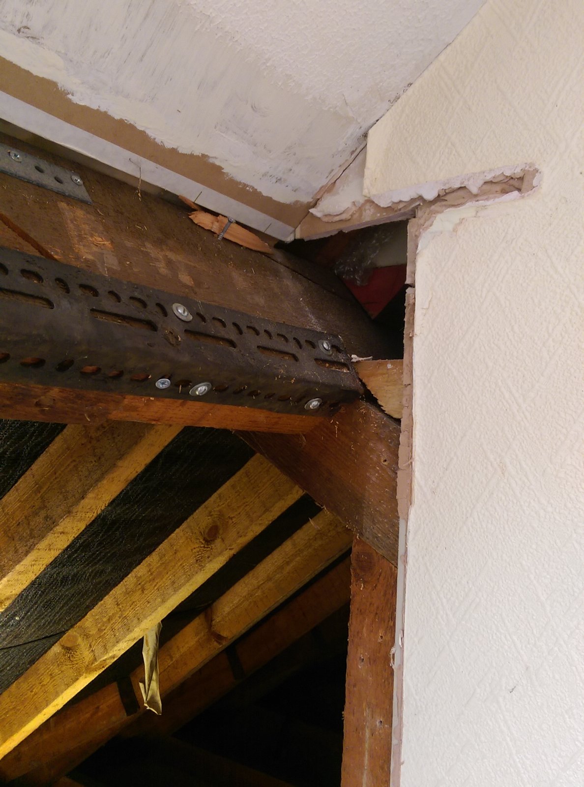

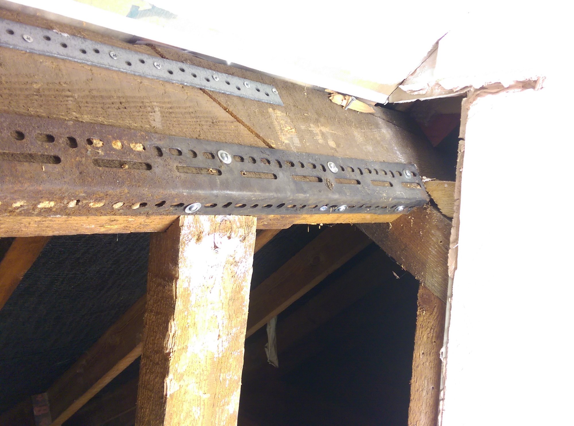

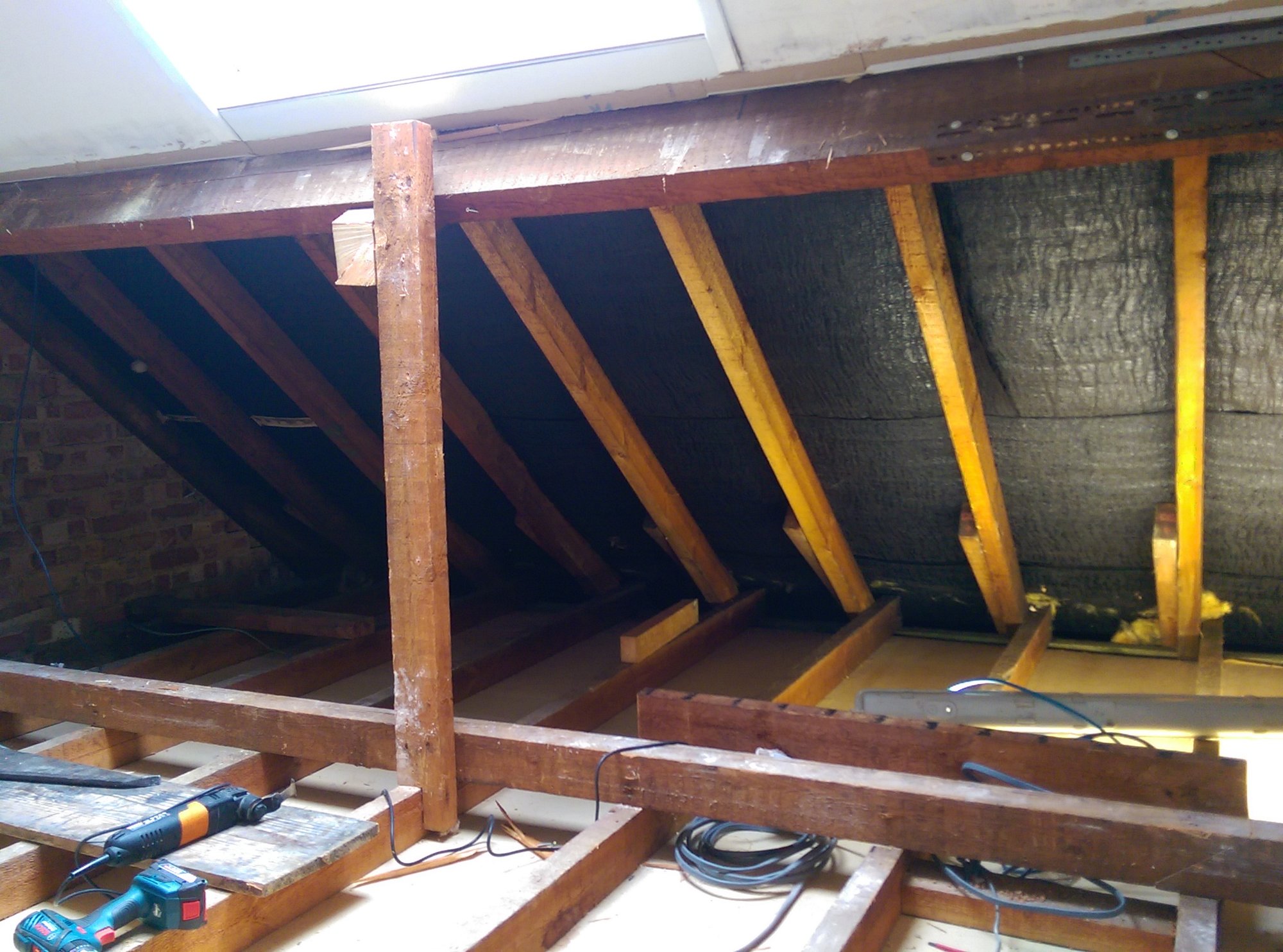

The strut that's been cut out was running to a wall plate on top of the lounge wall.
Nothing supporting the purlin now......![]()
i can tell you now

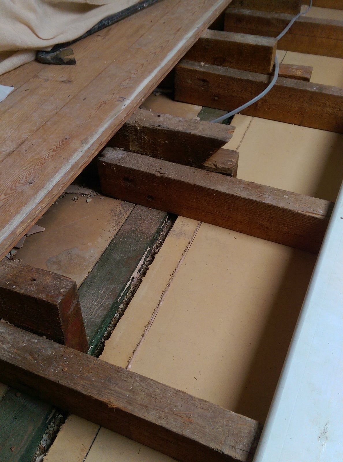

its all wrong as those up rights should be fasten to the ceiling beams and the beams that are your actual floor more of supporting the floor structure with the roof

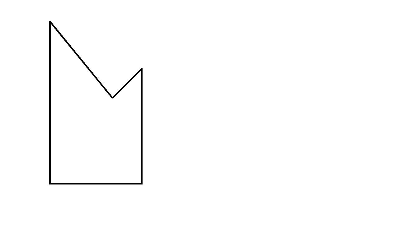

what's a flitch beam?
