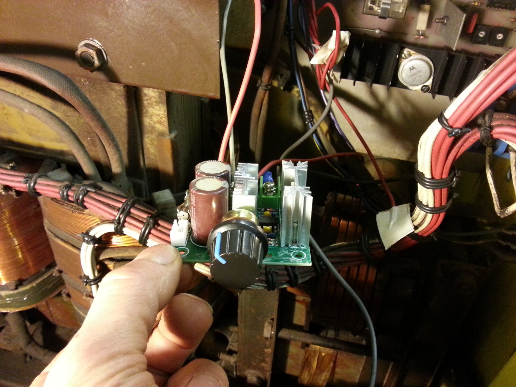

So I pulled the coarse switch off and tested it, seems to be working ok.
Am I barking up the wrong tree here - is there a big inrush current on this sort of machine even with no arc that would flip the 16A MCB but not blow the 13A fuse in the plug ? If so would switching out the breakers for a Type C or D solve it ?
