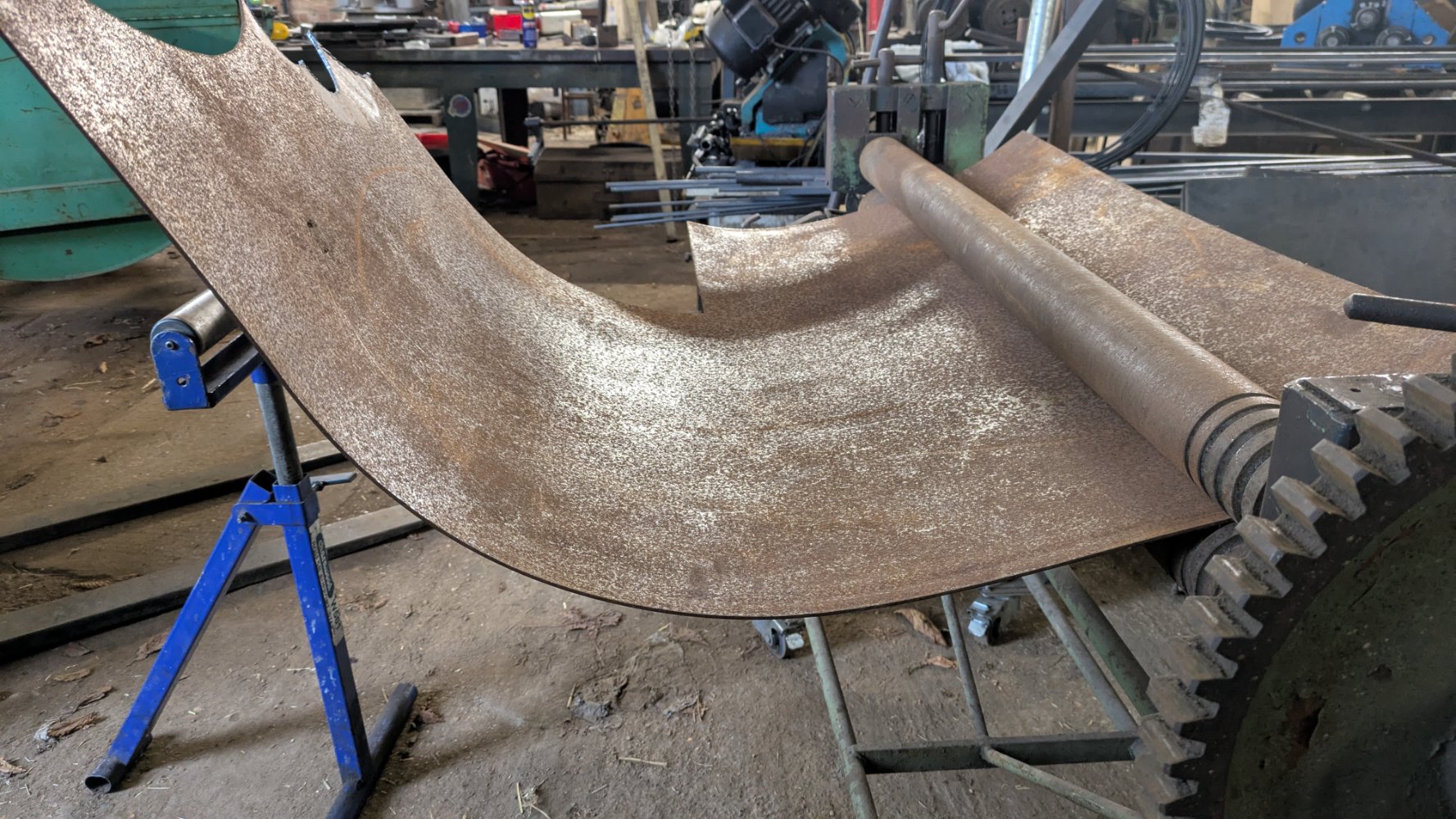

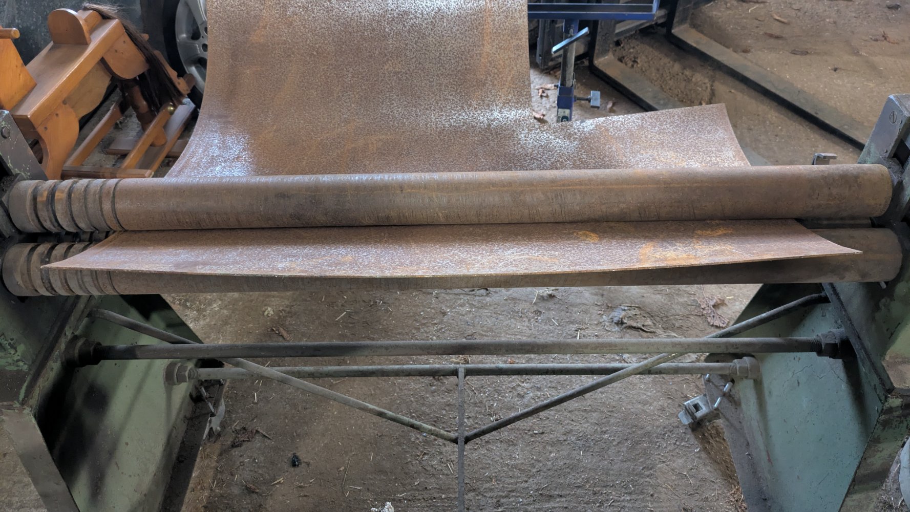

Hello all, I have some Vickers Armstrong RP25 manual sheet rollers, 100mm diameter, about 4 foot long from memory.
I've never really used them much in anger. Would I be totally stupid to try rolling a couple cylinders with them in 4mm mild steel? 600mm long, 500mm diameter, or thereabouts.
I'd make a bloody big wheel, no way I'd crank the little handle. Thanks
I guess pinch because the two nearest to you kinda pinch the material, then the bottom one furthest away raises up & down to affect the radius of the curve. At the end nearest the crank handle they've got grooves for rolling bar from 6mm through to 16mm I think. I did some 12mm round bar the other day.
