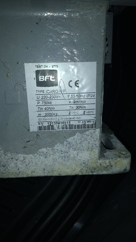

Probably not a lot, the main issue is the starting power. When it’s starting under load it take a fair bit of power to get it going.
With your set-up, the 3P motor with caps on a 1P supply, aka a Steinmetz connection, then you've I believe a low starting torque anyway. The system can only supply around 60% of the motors power compared to if it were on 3P.
@Pete. might be able to comment on that.
