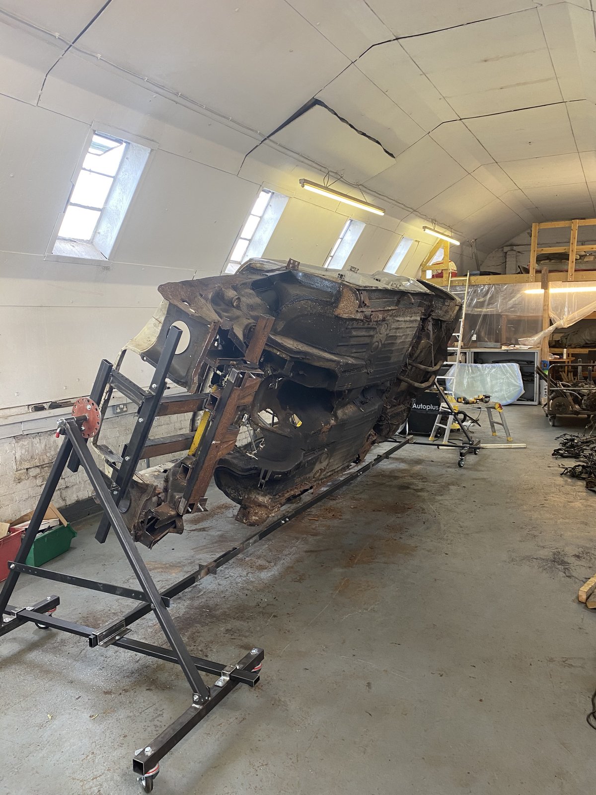

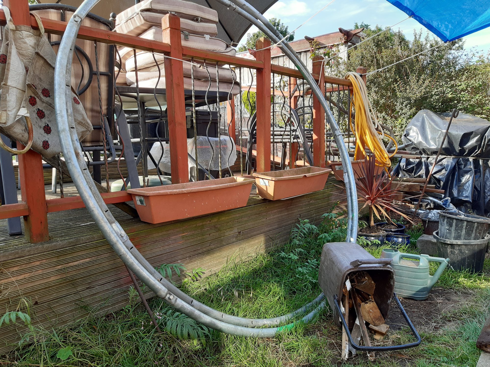

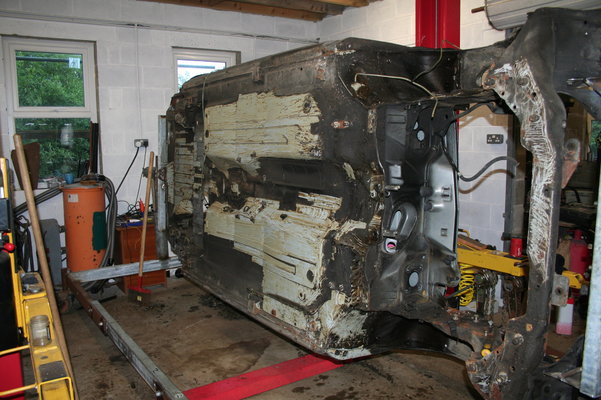

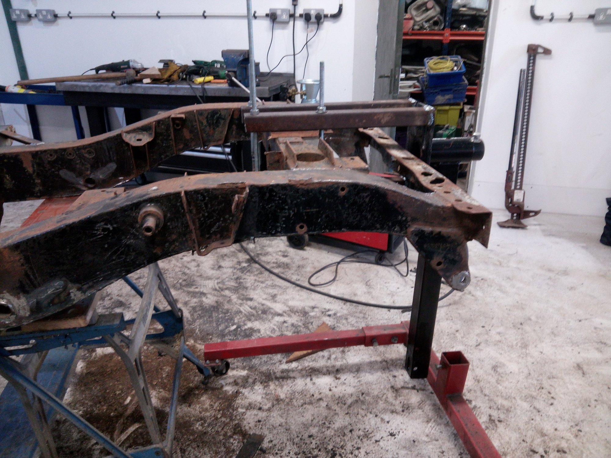

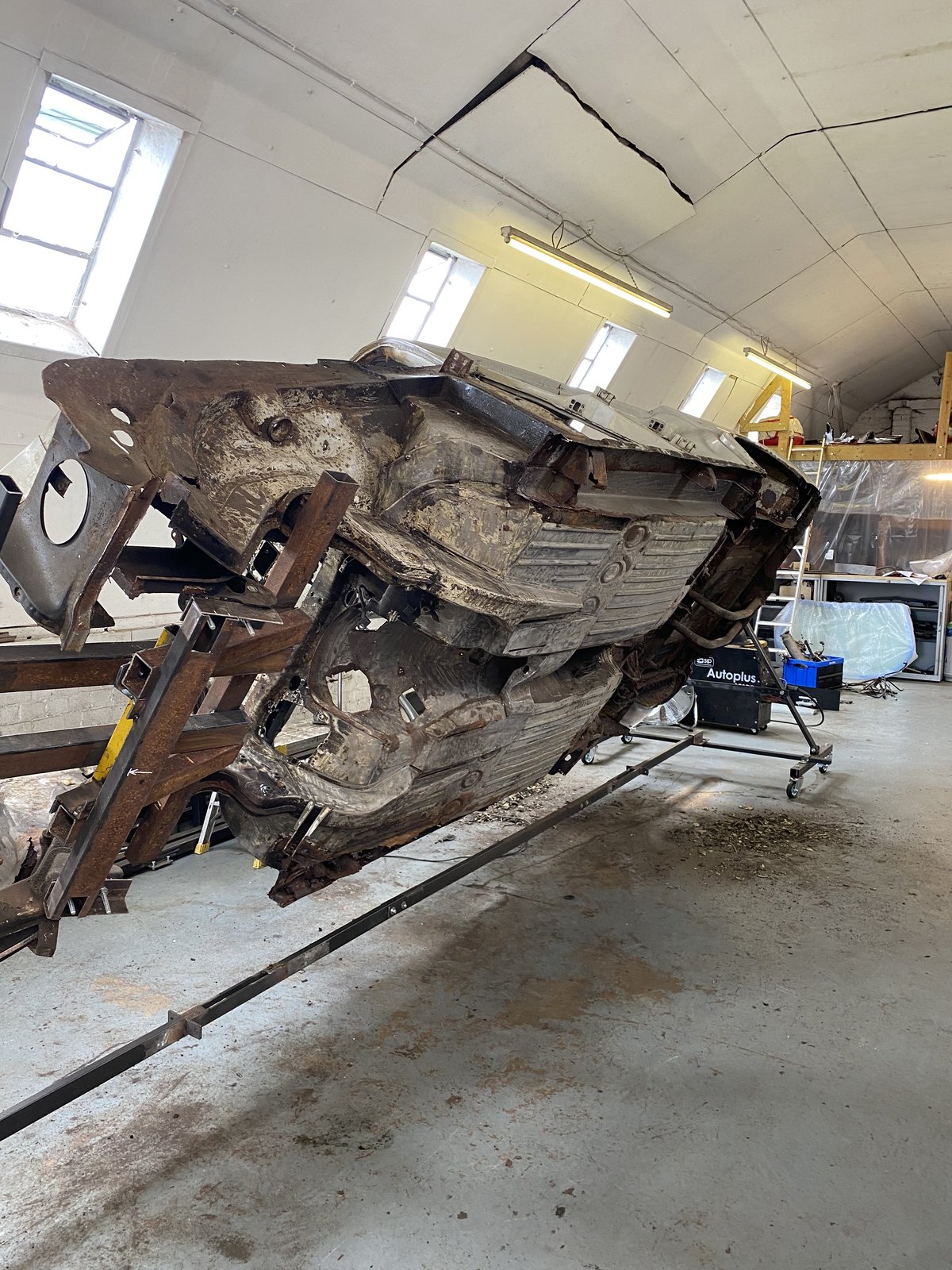

Thats exactly what I'm thinking and mine is for an escort aswell.Made one like the 2nd pic, works fine though escorts are pretty light bare shells.

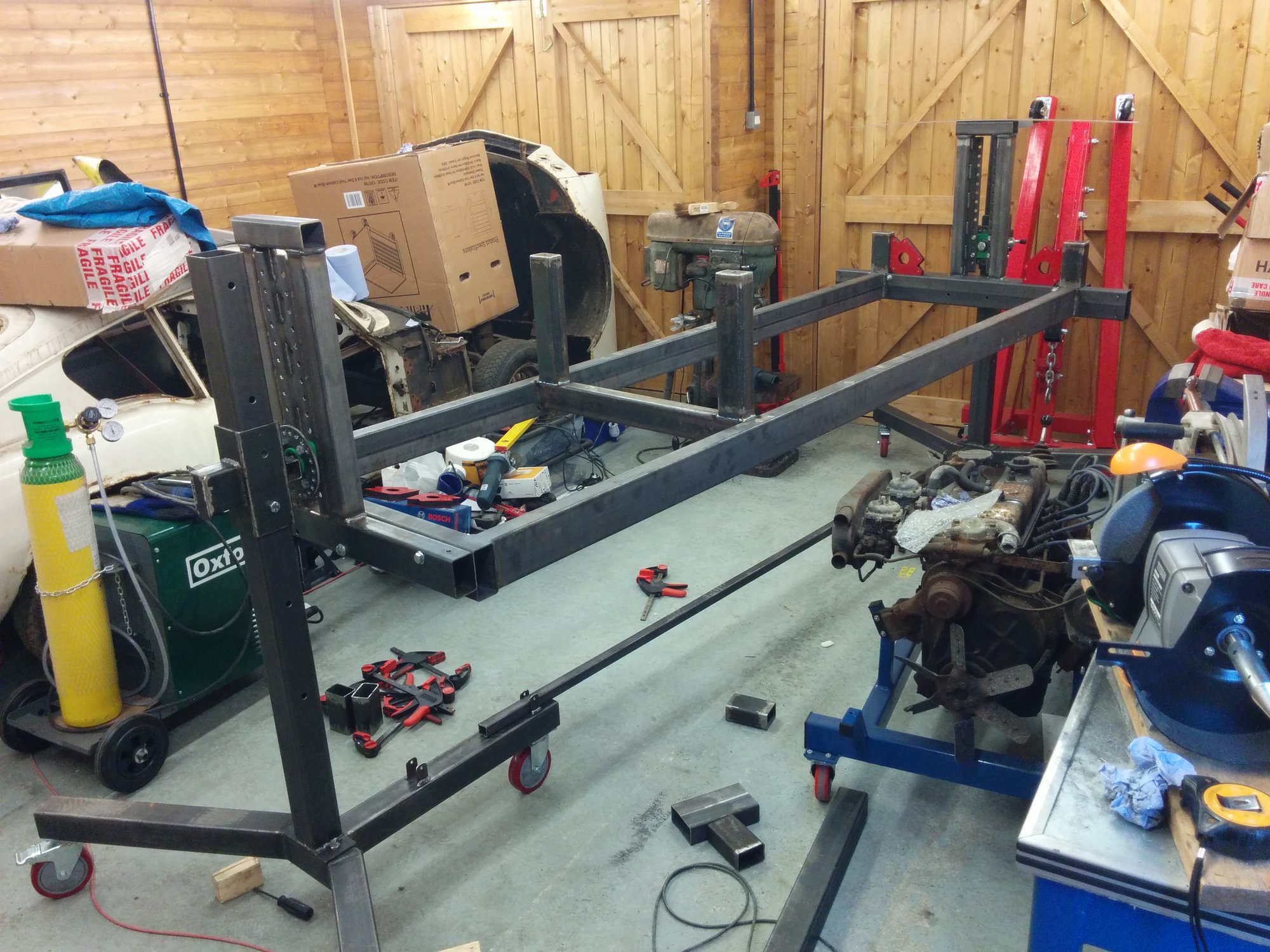

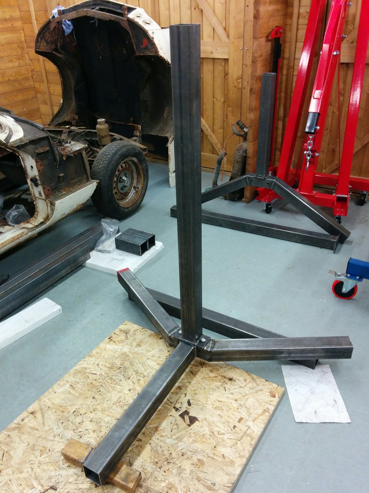

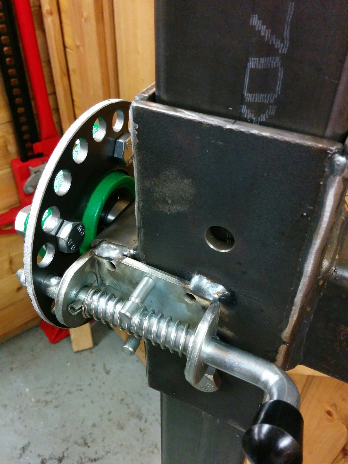

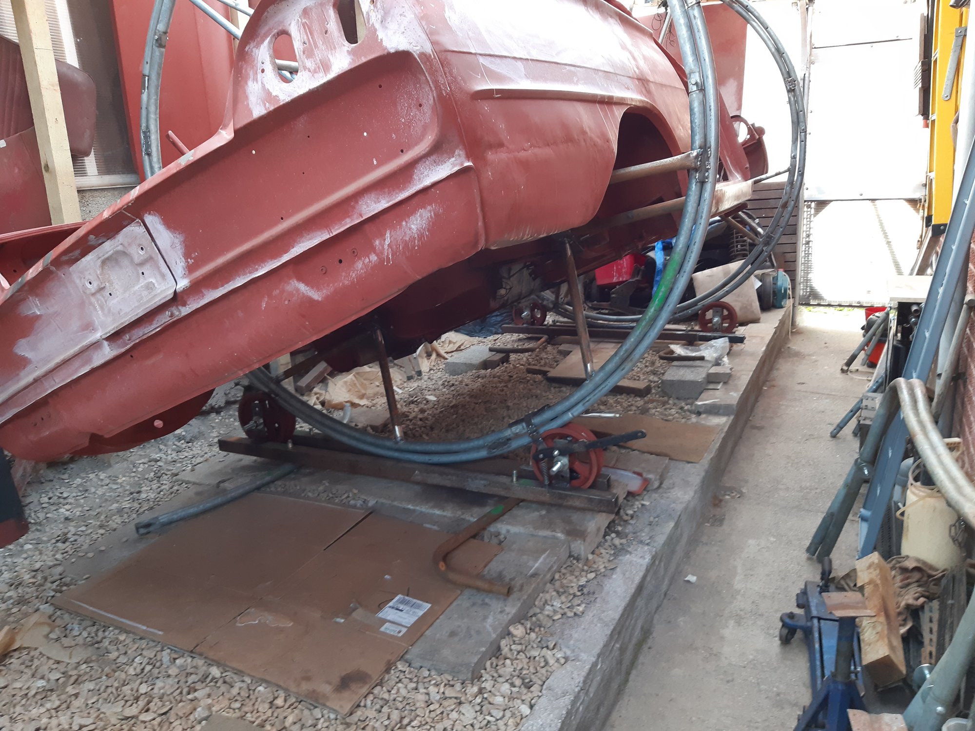

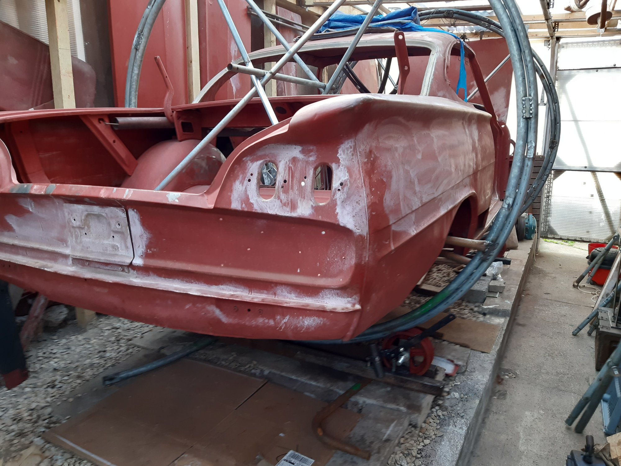

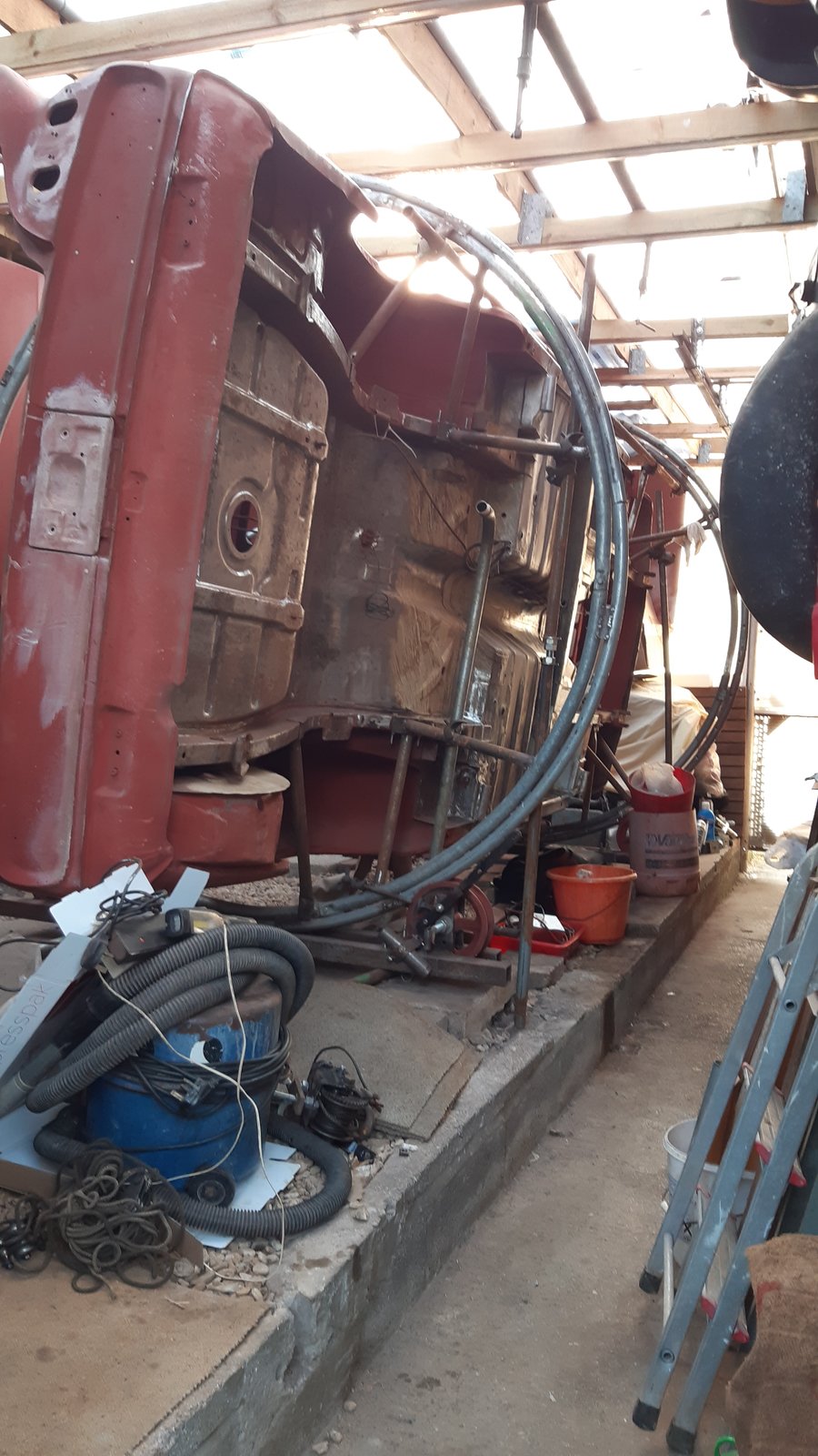

The bearing height is adjustable to the CG, following pics show it in final position...

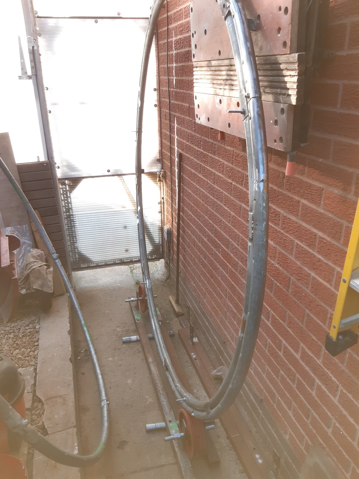

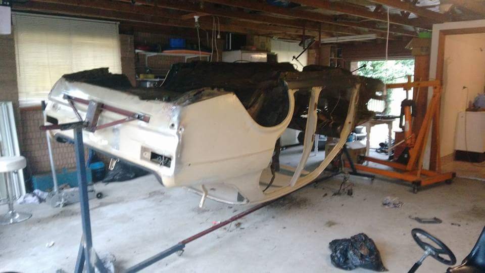

Mine you can turn the shell over with one finger. It is perfectly balanced with a totally stripped out shell, but it took a lot of messing around to get it like that.The chances of finding the true centre of gravity when mounted to a chassis or body are virtually nil, I have alway used wheel bearing/hub/handbrake assemblies both ends of a jig so it can be stopped in any position, saves fumbling with locating pins especially when you are on your own
Bob.

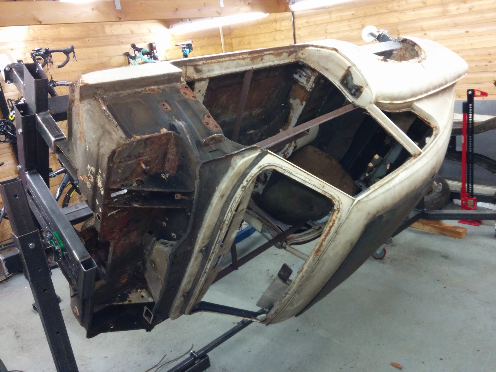

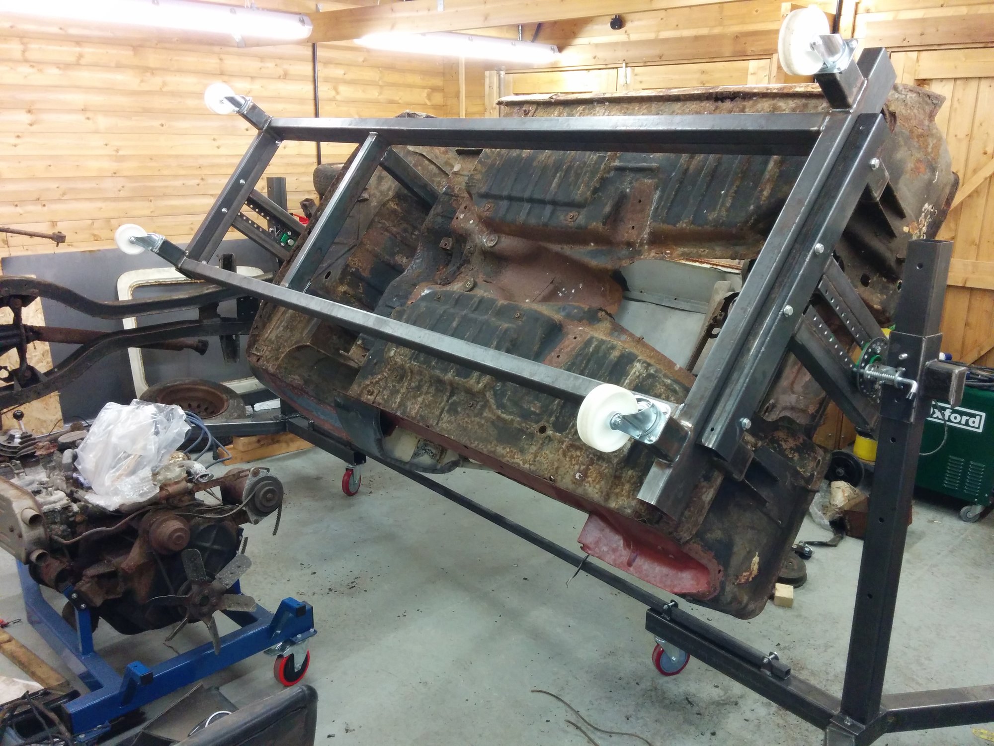

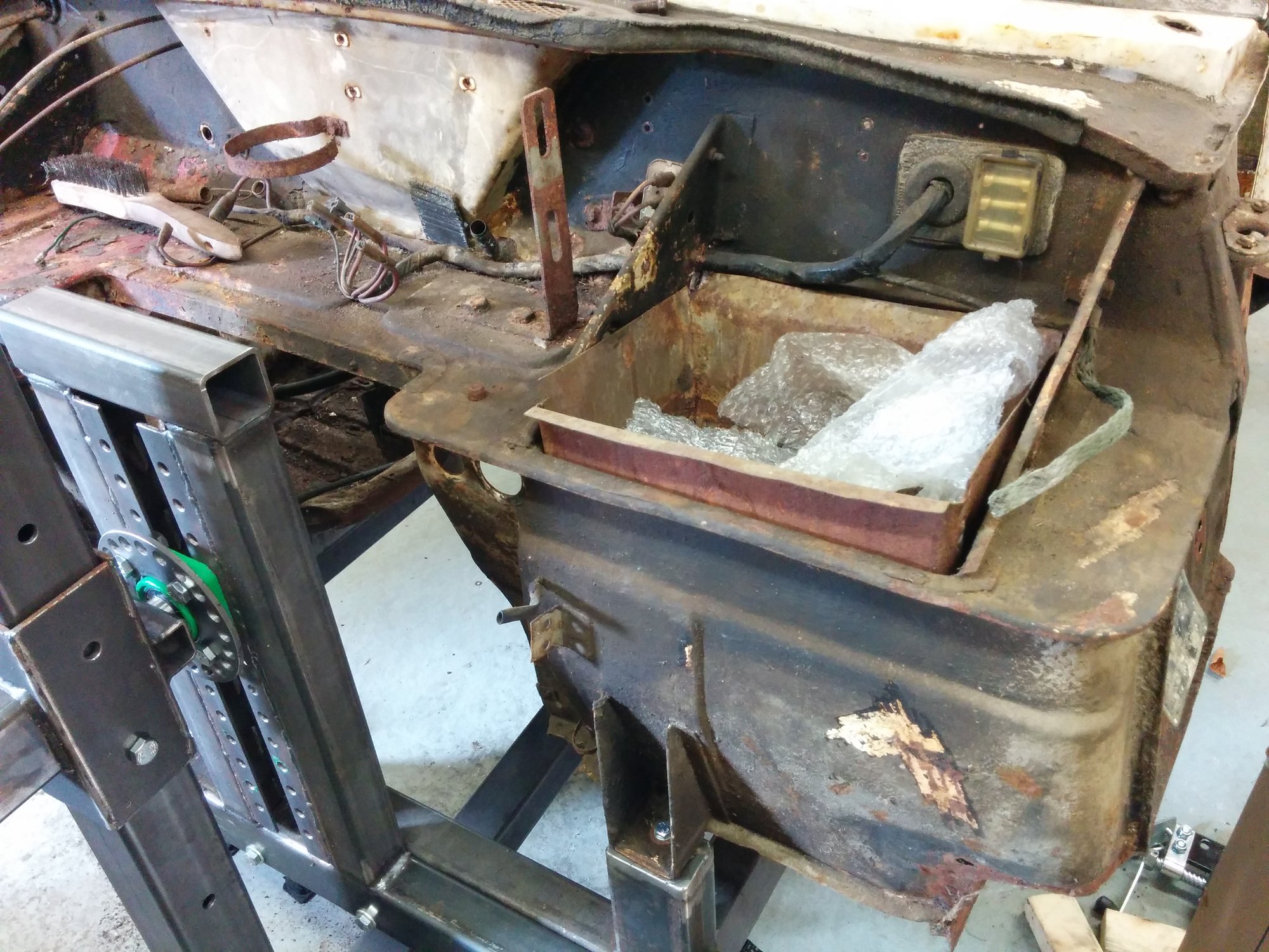

It's just a series of holes that the green flange bearing bolts to.can you share some pics of the height adjustable part please
You can.....It's just a series of holes that the green flange bearing bolts to.
Even though you can set the CG to within approximately 10mm, you can't adjust for one side of the tub being heavier than the other - which mine was, probably a combination of filler in the rear wing and extra metal work due to RH drive.
