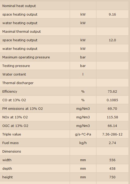

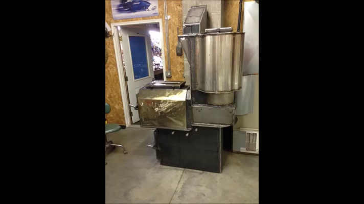

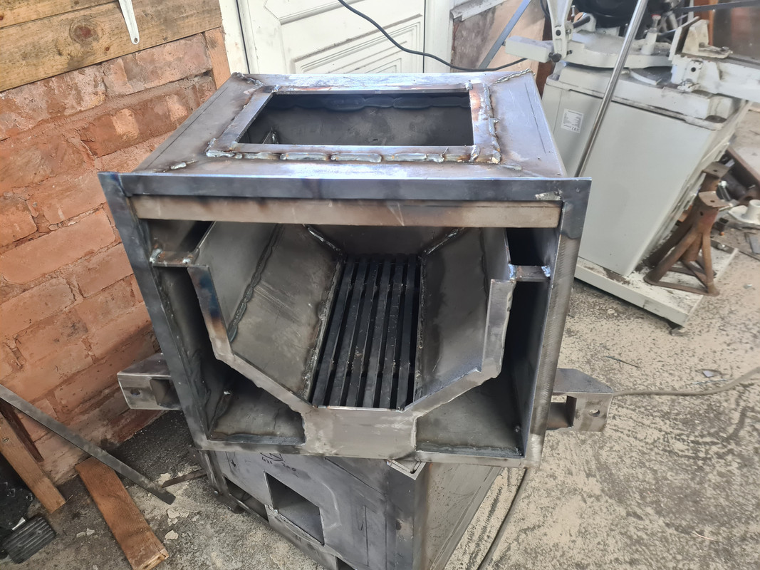

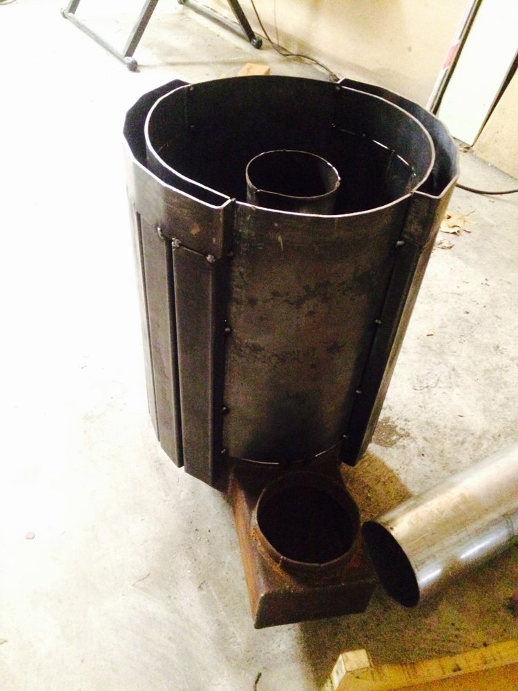

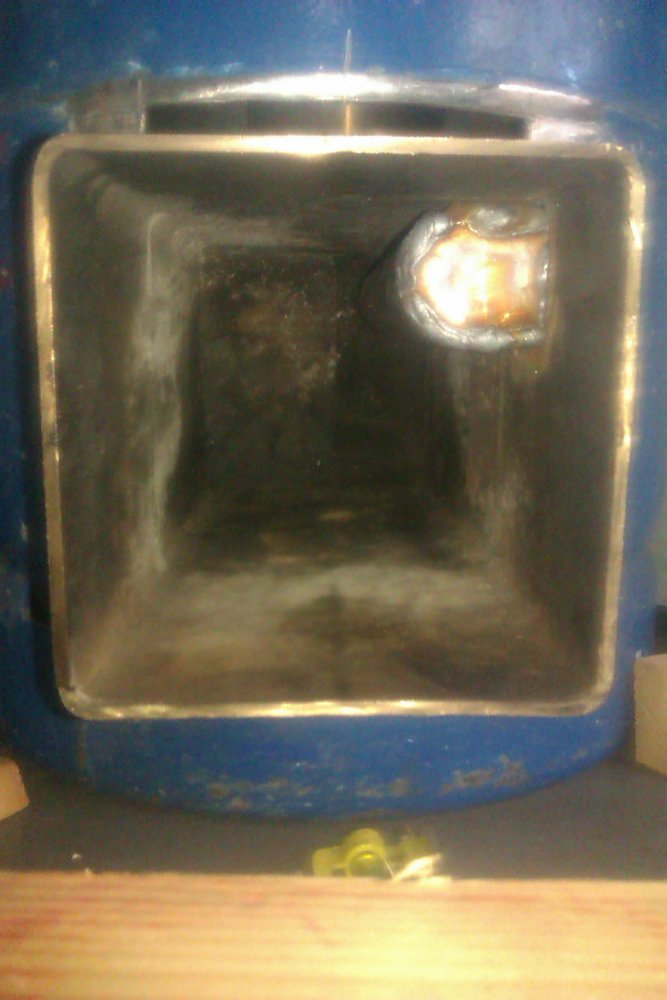

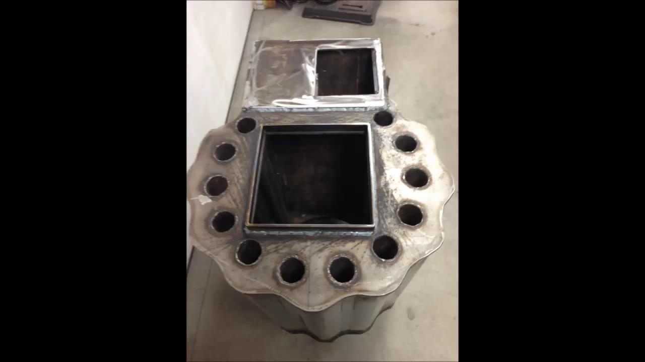

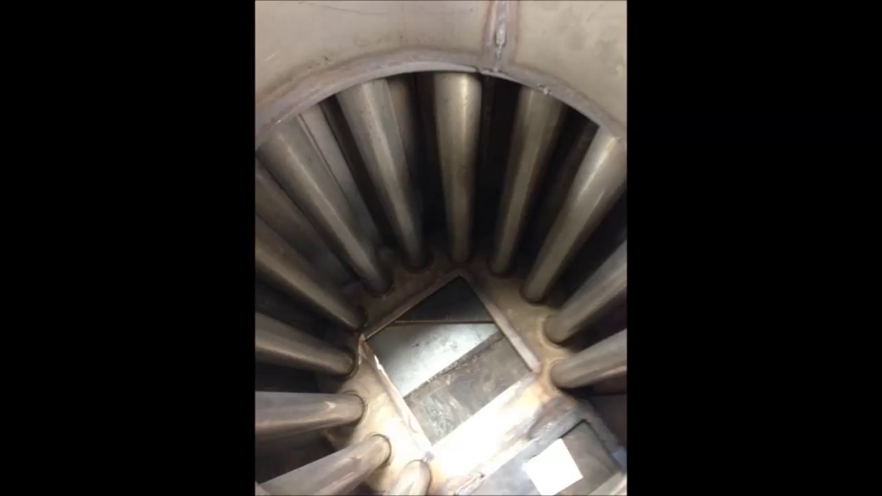

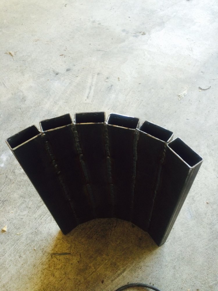

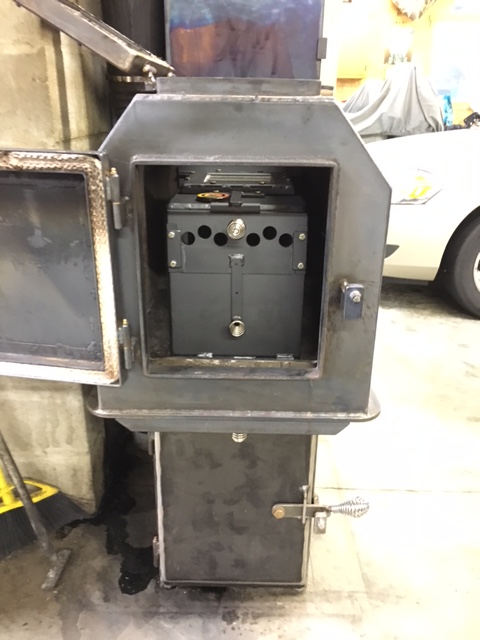

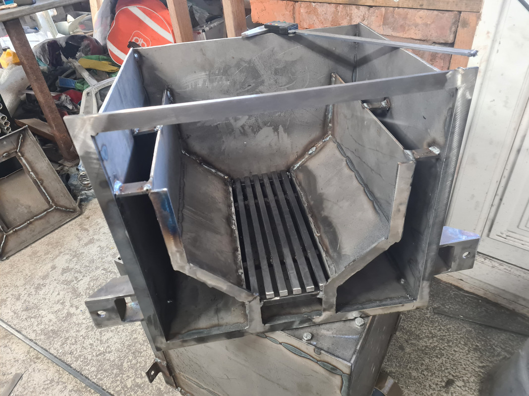

the build maybe seem alot for a wood stove but it has alot of advantages compared to a normal stove

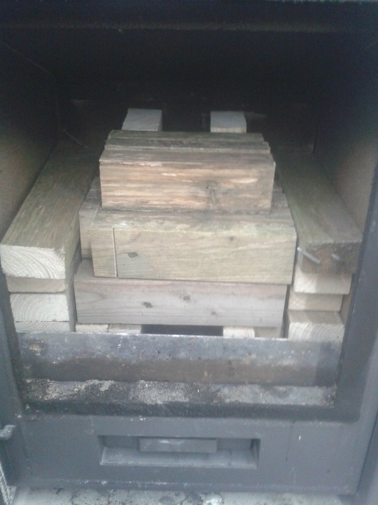

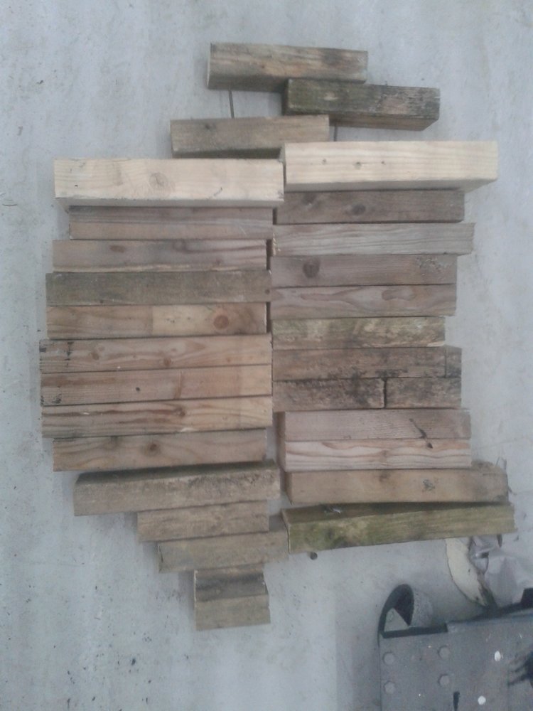

the wood above would be gone in 3 hrs ( 1 burn )even if you built a rocket stove within a stove as i did with that model above
however same amount of wood and i get 3 burns out of the same wood thats 3 x 3hrs within a rocket stove

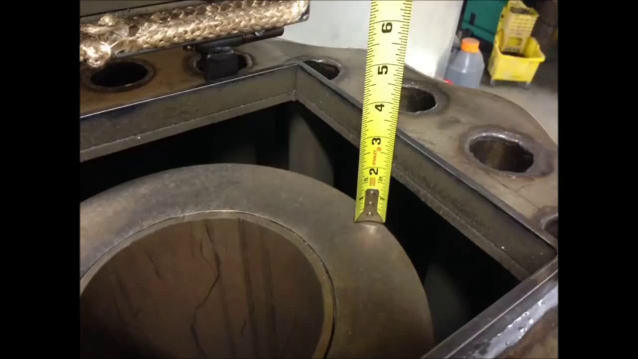

with 2 heat chambers putting out 1000f+ from the stove and not 1000f+ up the chimney ( like a normal wood stove ) as that only reaches 2-300f depending on your build

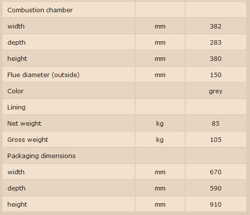

yes the build is lets say 1200 compared to the 590mm of depth of a normal wood stove it dosnt have to be this length though all depends on the tubes that you use it uses no fans neither electric or a stove fan and spreads the heat around the shed rather well
