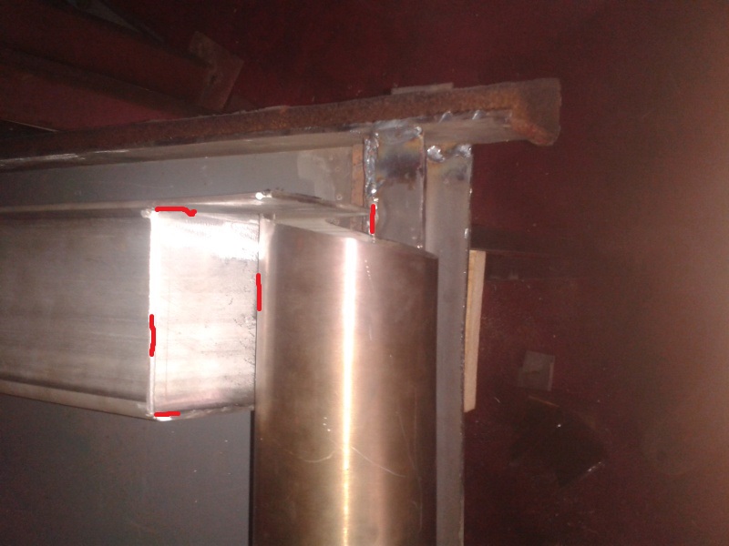

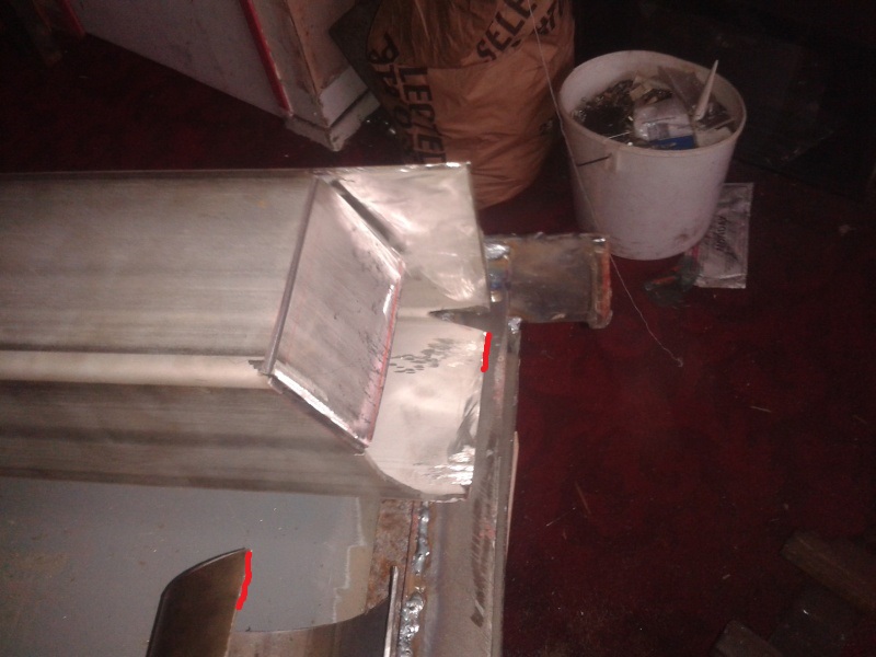

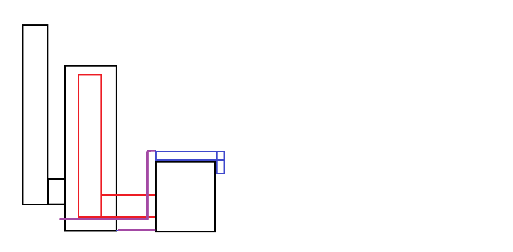

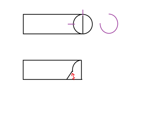

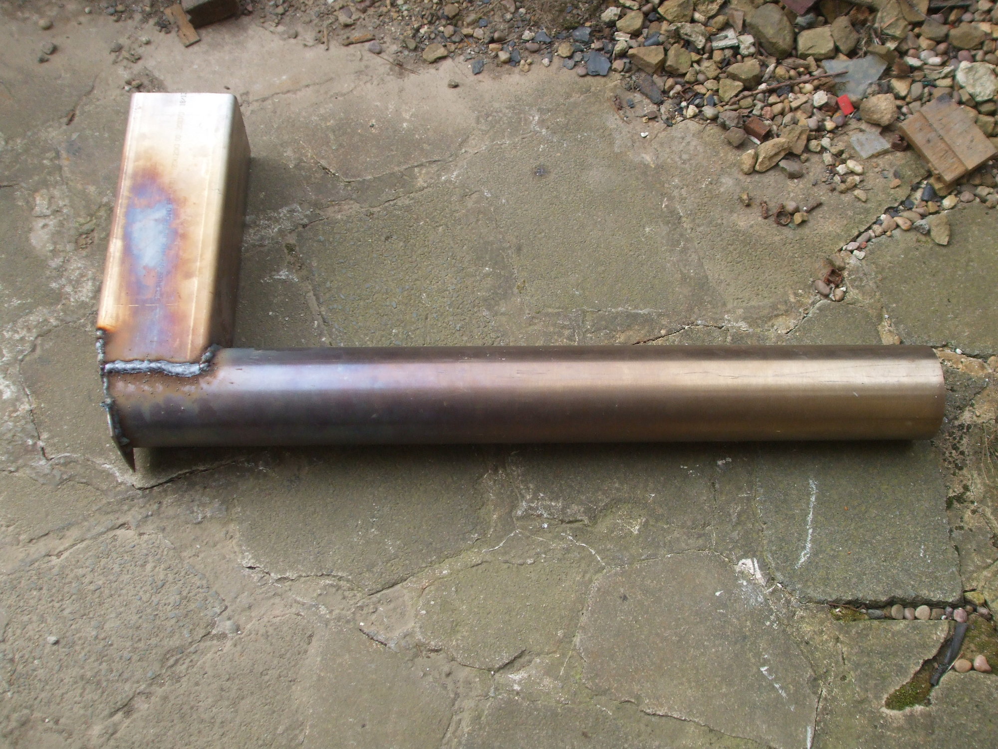

delta the welds on my joints was all butt ended to each other
all welds was done on the outside of the materials so no chance of any welds going through to other side just beaware with stainless steel it gets hot quickly and drop through on you if your not careful
the pieces marked in red is where i welded the one you cant see is butt ended to each other
