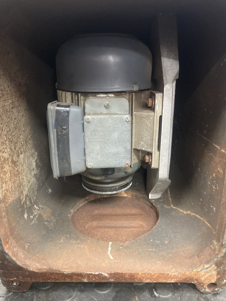

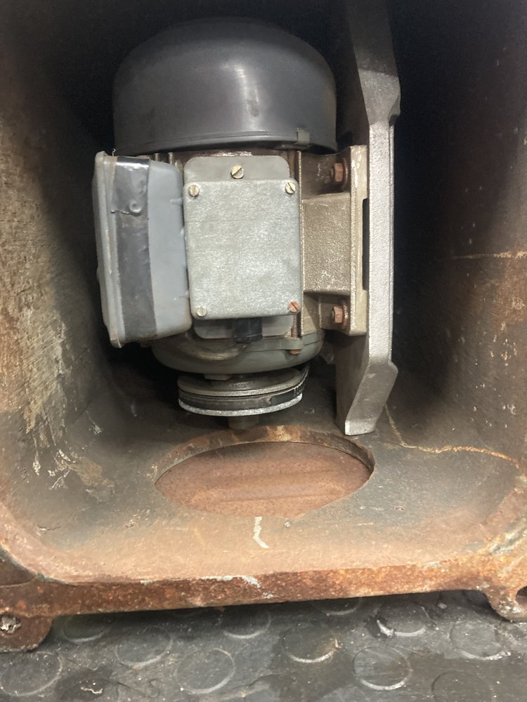

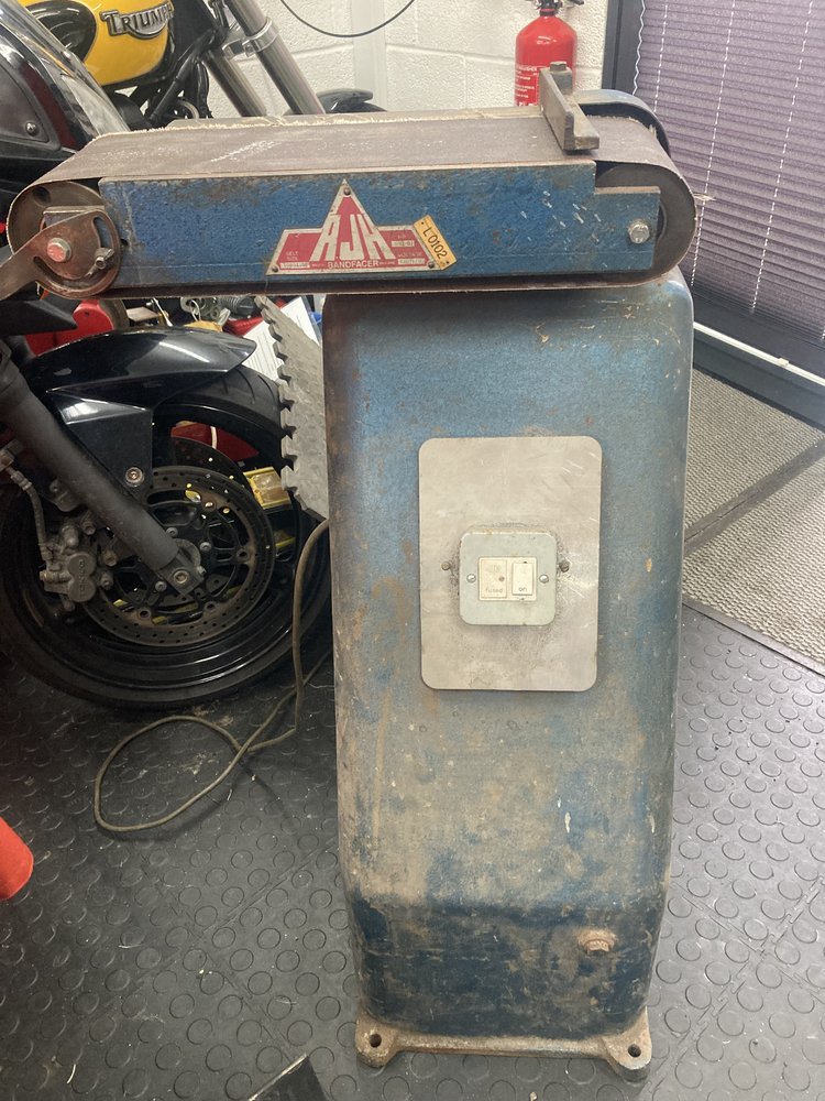

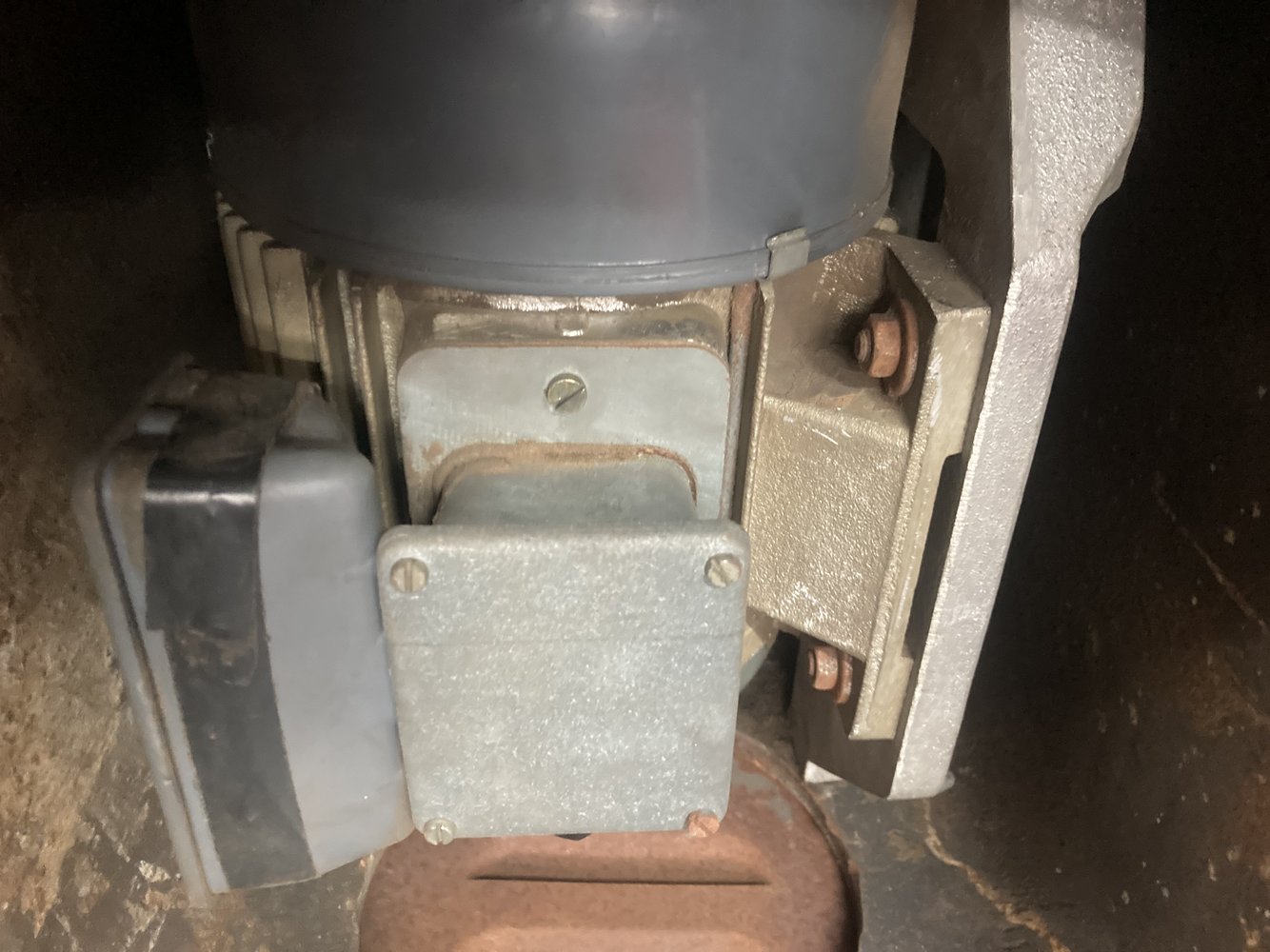

@Milkybars mine is a 3 inch o.d. pulley but it is only the 4" belt version so may well be sized differently, motor is original as far as I know, and is a 1440 rpm 1hp (0.75kw) single phase.
I should also add the drive belt appears to be an A64.
