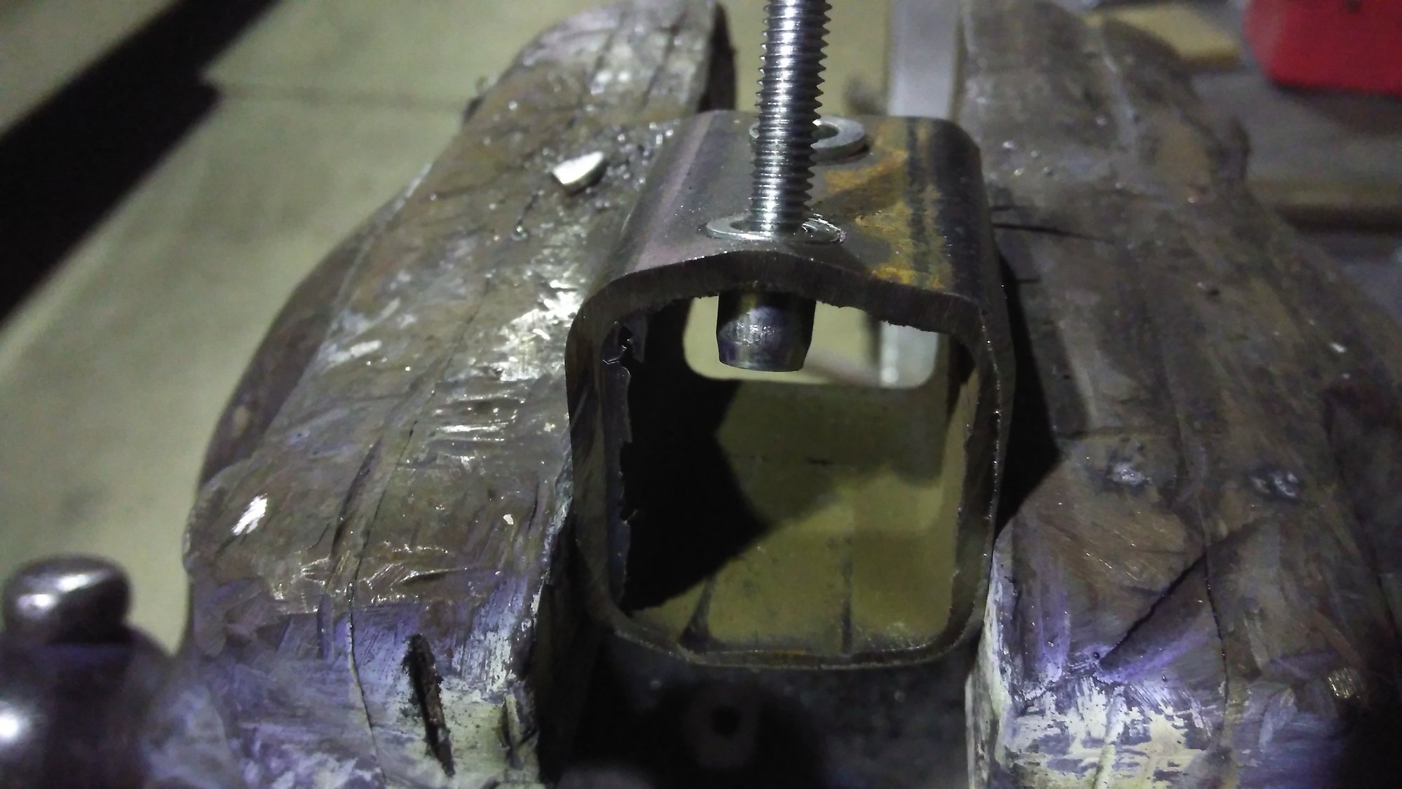

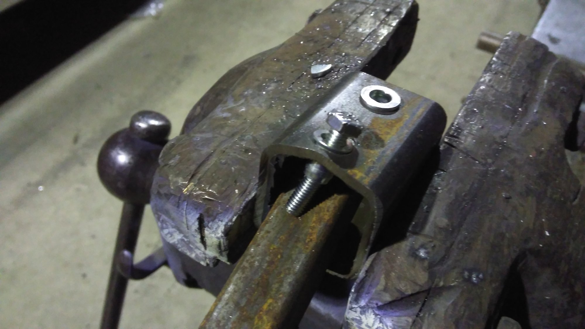

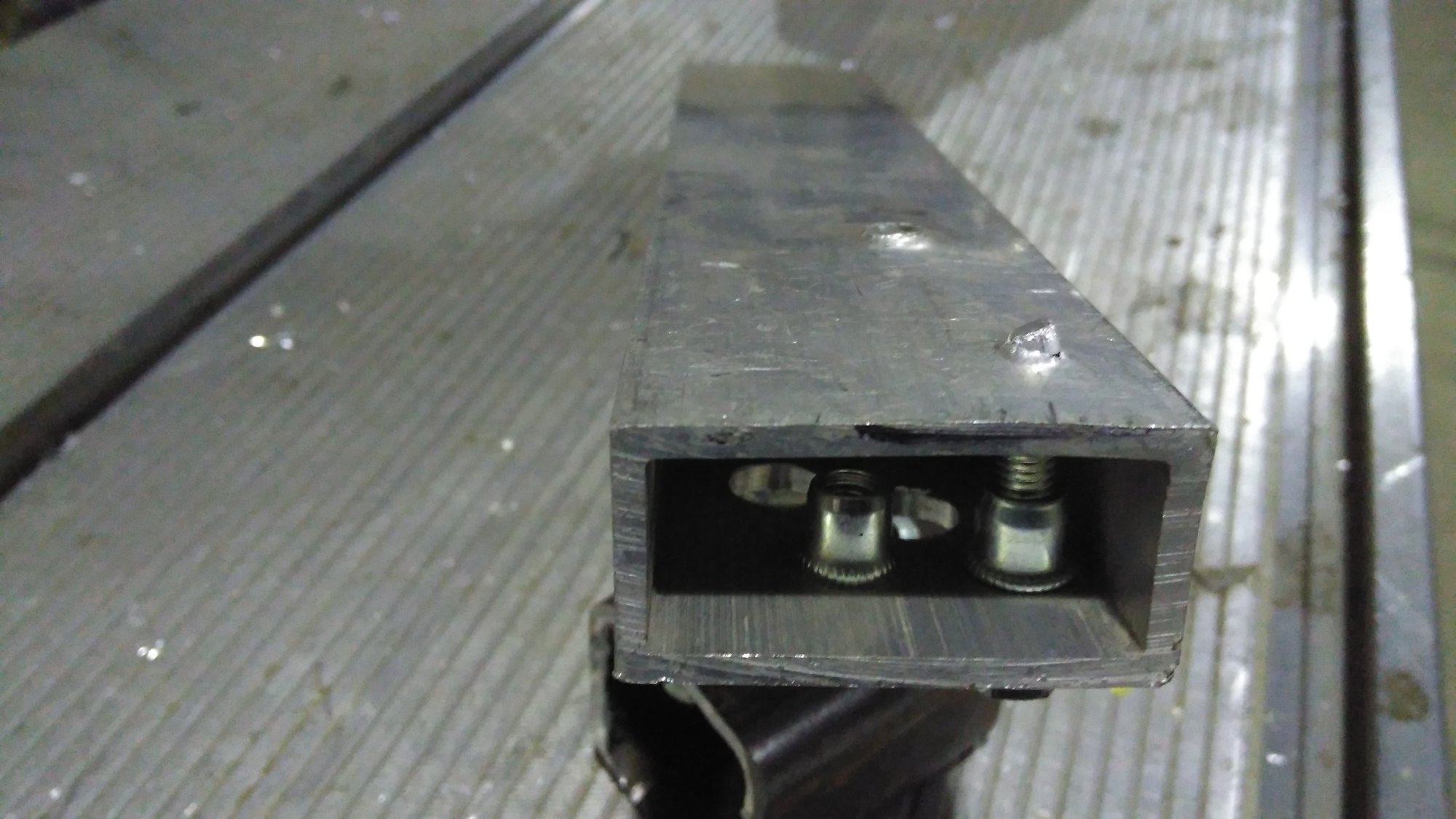

I’ve the Bralo hand pliers show in that link, good up to m6, m8 is possible but you need to do it in stages, unless you have a grip like an ape.
I assume the
If so I have a similar one bought 'for me' from RS by the last company that employed me IIRC it was over a ton back in 2002 ish. It gets used occasionally but agreed M8 is just doable with normal sized hands.DRNT105 professional Workshop tool kit nut riveter
