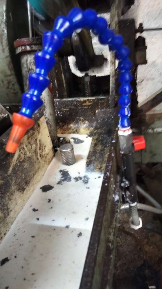

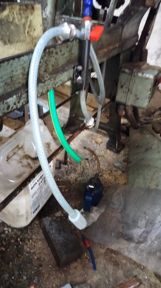

is that the original?Found the missing 1/4"bsp tap under junk on the bench of all places...not on the floor which I'd been scouring. Didn't really need the check valves on order so it's basically finished and works as expected. Not running through the filings until I get the strainers as I want them. But YES it works! Cheapo Chinese flexible nozzle drips a bit...other than that... nada.
If Milkybars would be so kind as to post an image of what the genuine article looks like it would be most appreciated, as I've never seen one and only guessed that they even existed.
The pump uses simple 'O' rings as seals and piston rings, so how well the stand up will be interesting. I do have the correct 'U' seals from China now, so could change out if required. The pump is lube'd by the suds.... so hopefully not an issue.
