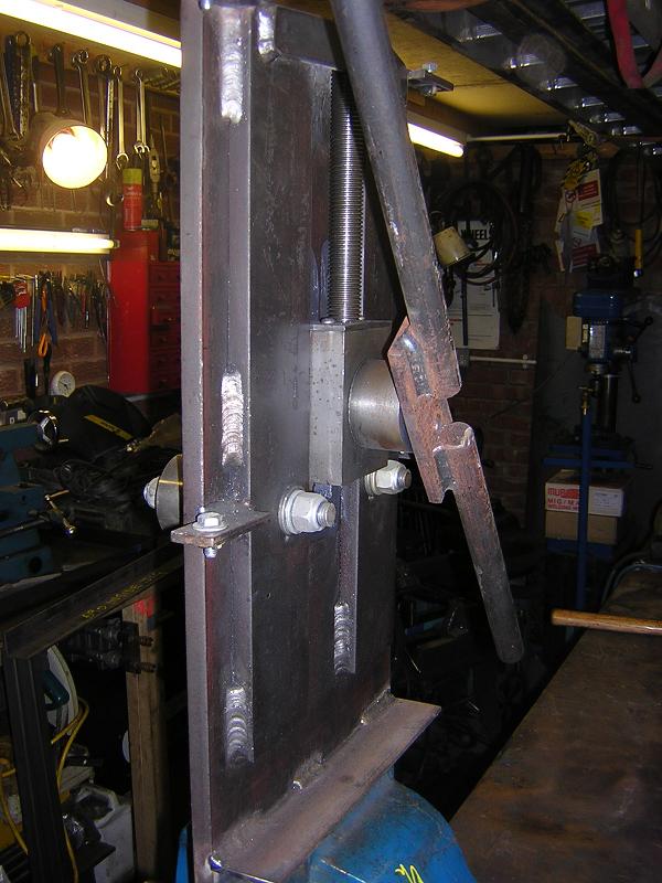

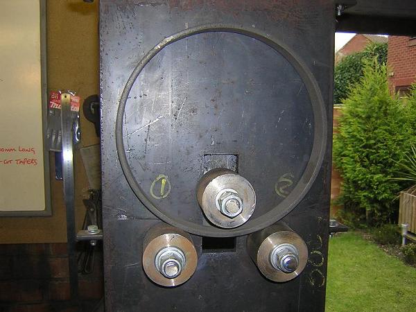

This is my section roller i made - it's made from 300 x 15 flat with 85mm dia bdms rolls. It was knocked up pretty quickly for a job, but has seen some real use. Biggest problem is lifting it onto the bench - it weights 40kg plus! Will post some pics of rolled section soon.
