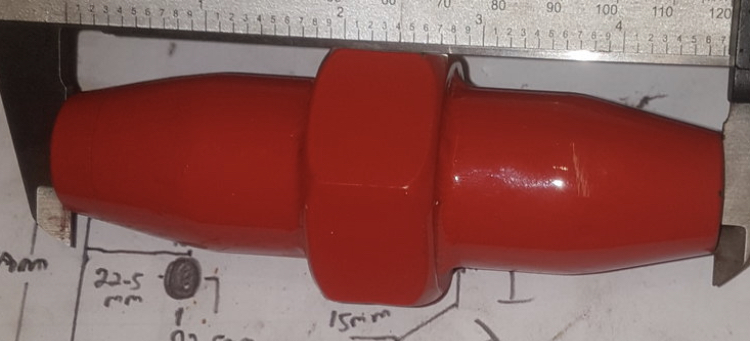

I’m doing some of these for @123hotchef and I need a left hand thread in one end and a right hand thread in the other they are trackrod adjusters
my vote would be a let hand tap and a right hand tap
Would not putting a right hand thread in one end then flipping it in the chuck not do the sameThat world be my first choice, what thread is it?
Nope, unless you cut the threads on a lathe it's right and left hand tap.
yeh they aint long enoughIs it worth making when you can buy them for a few quid? https://www.norelem.com/us/en/Produ...07222-Turnbuckle-nuts-hexagonal-DIN-1479.html
Bob
They are going to be out of stainless but they are going to cost a lot more than themIs it worth making when you can buy them for a few quid? https://www.norelem.com/us/en/Produ...07222-Turnbuckle-nuts-hexagonal-DIN-1479.html
Bob
So what I'm trying to figure out is have it would adjust the track rod if it as a left hand and right hand thread surely that would just screw it's self along instead of adjusting it
Yes so they would i have had myself all muddled up the last few daysNo, left and right hand threads will shorten or lengthen. Same as a load binder .
it happens mateYes so they would i have had myself all muddled up the last few days
