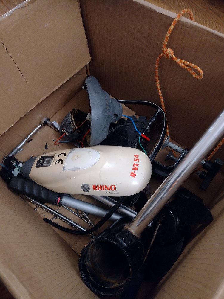

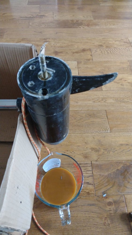

....I managed to disassemble the motor but it didn't come apart easily. The (sintered?) bronze bush was very tight on the shaft and I managed to crack in when I was removing it. Previous owner said it was working last season so maybe got stuck during winter storage.I had exactly the same thought myself...the motor bit is very simple. Even the speed selector is just a bunch of extra windings in the case. I'm hoping it had a fuse fitted which might have saved the windings.A minature sump pump, for use in case the shaft seal went, plus a water sensor in the motor compartment, with a warning light on the top, would be handy.

Cheers I'll take a lookSintered bronze bush? Try this lot
