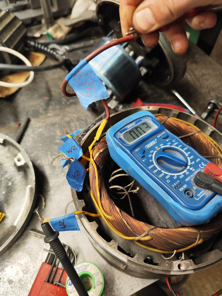

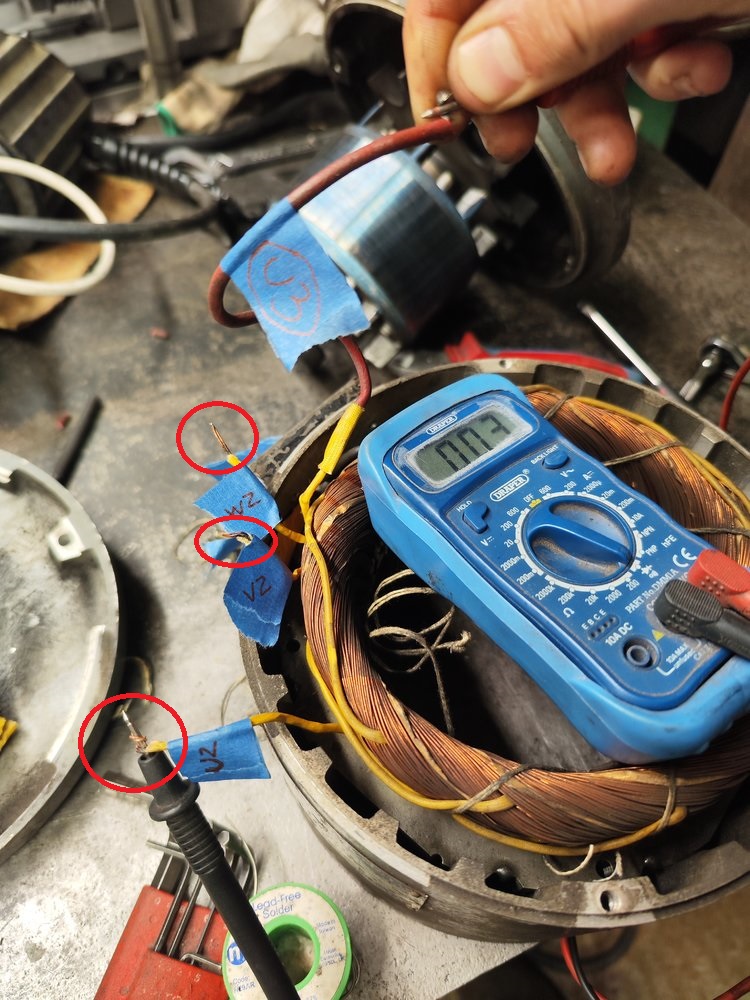

Background:

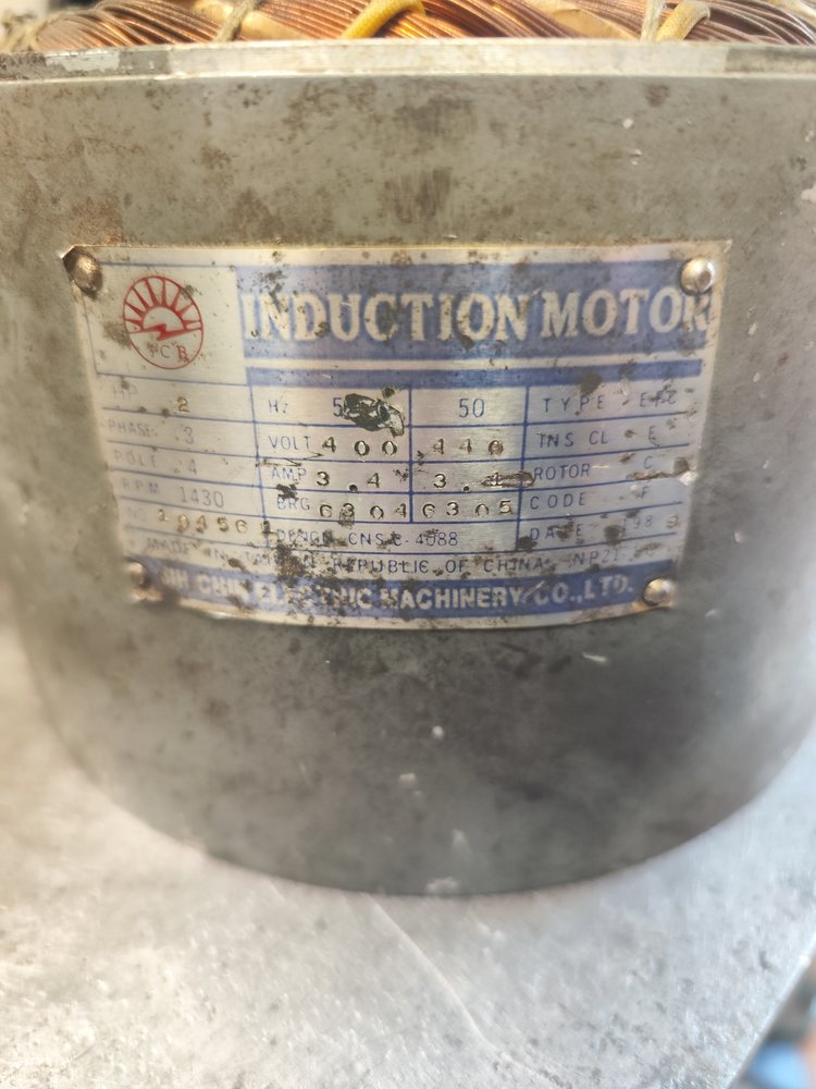

My Semco (Bridgeport clone) mill's motor is a 3-phase '440v only' motor.
I want/need to find the STAR point in the motor so I can rewire the motor to 220v 3-phase for use on domestic power via a VFD.
I have successfully dug the STAR point out on a few motors before so I could rewire them to DELTA.
My first motor I have ever rewired.
Two motors on the Elliott TV 2 mill.

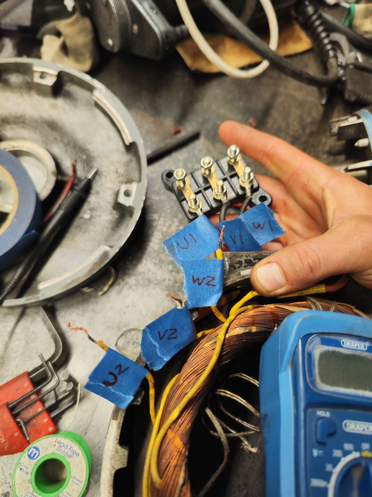

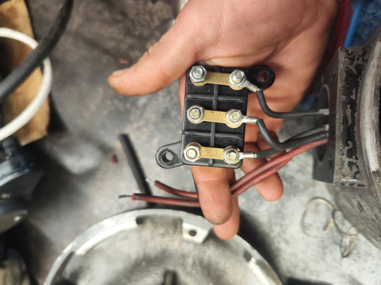

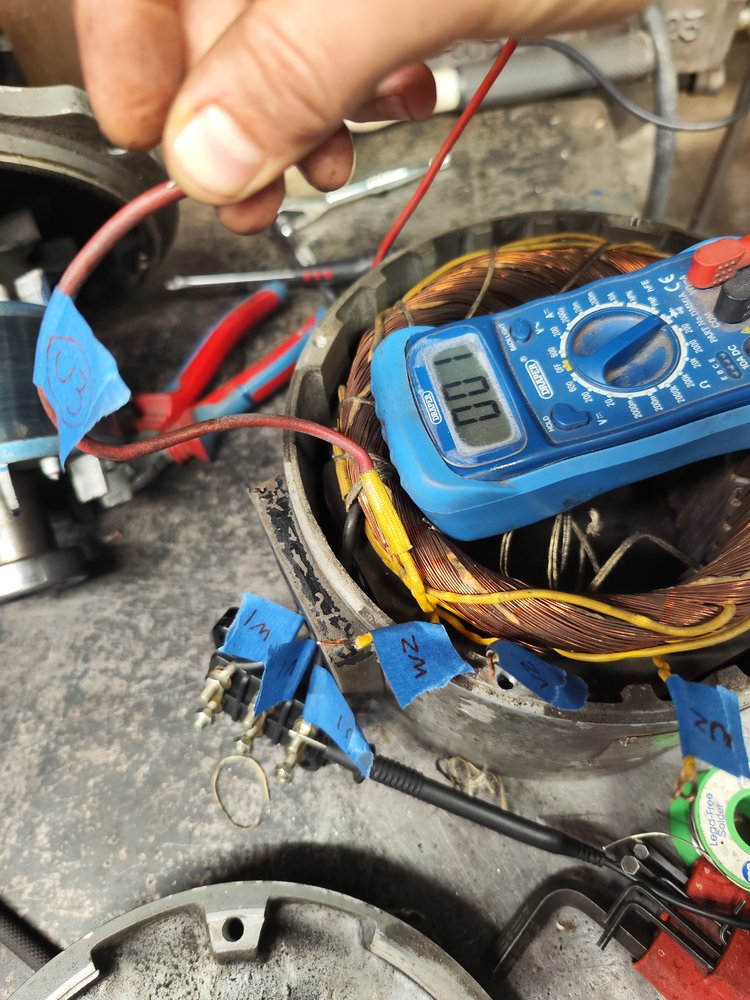

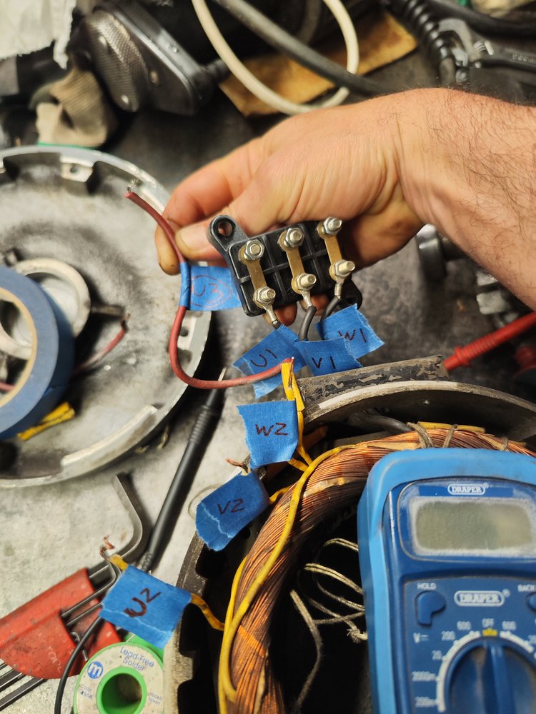

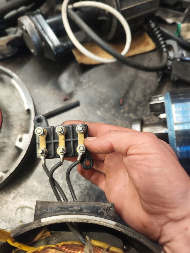

Here is the motor I now want to rewire to DELTA

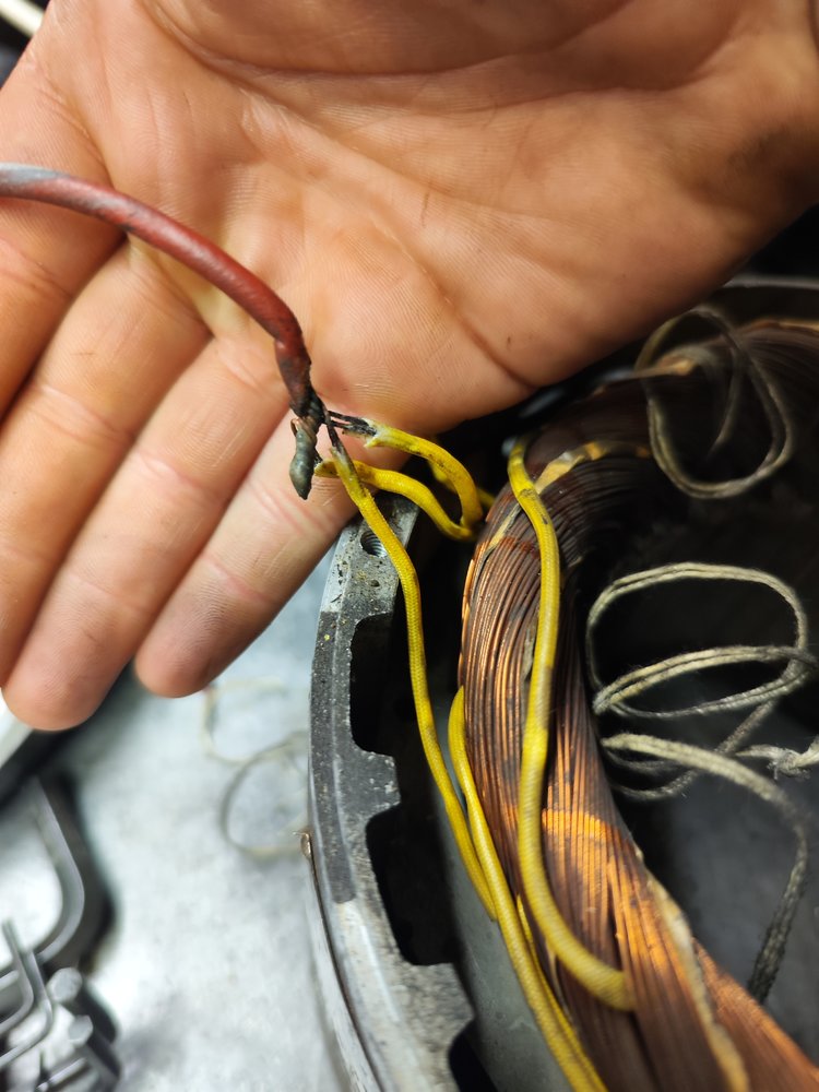

It has got the 'normal' three black wires coming from the windings (U,V,W).

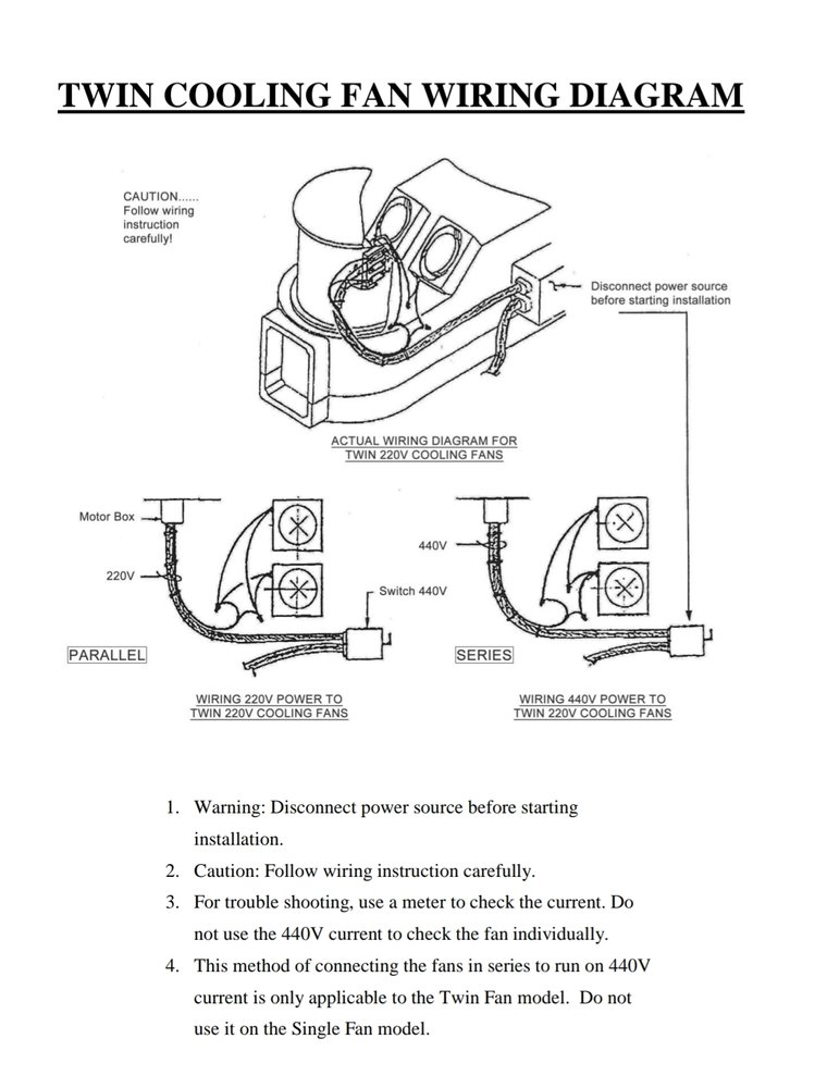

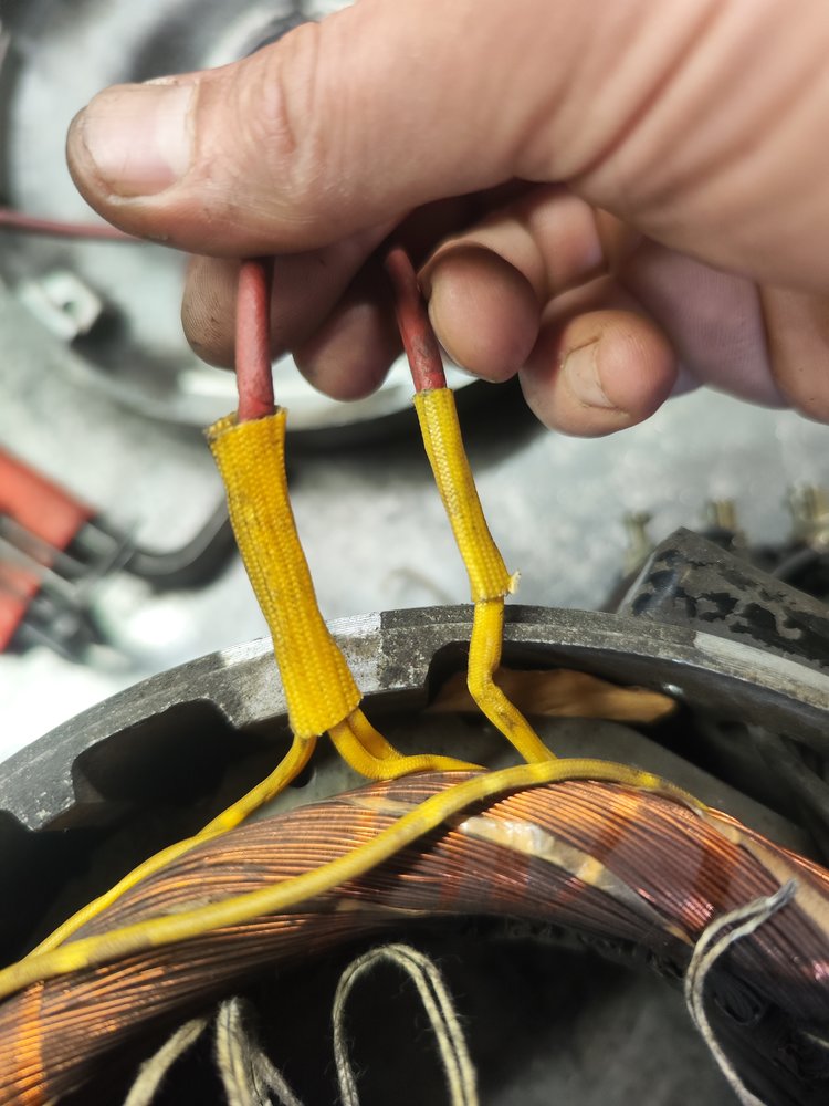

But surprise surprise, it has also got two additional wires coming from the windings which powered the twin 220v ac fans.
On one of the red wires, it looks like that might be the STAR point I am looking for as there are 3 wires being joined there (please correct me if I am wrong).
What is the other wire connected to?
These two extra wires that usually feed the fans have completely thrown me and I am unsure of how to proceed....

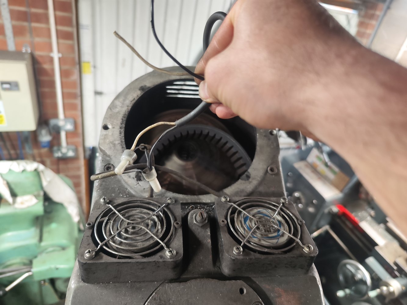

For clarity, I have also attached a photo of the two fans. The two red wires from the motor were connected to the black and white wires I am holding.
