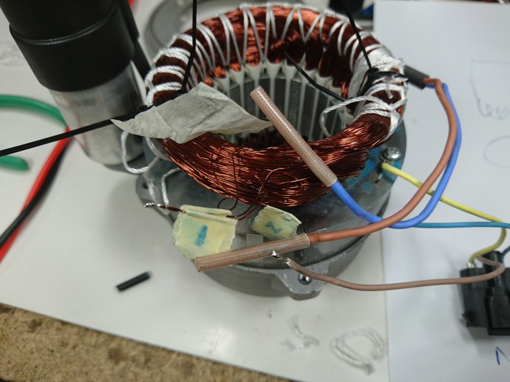

I was asked today to reverse a small ac induction motor for a pump, it only had live and neutral connection so no access to the windings directly.
After opening it up I was able to get to the windings and rewire it. In researching the job I came across this web site which has lots of good pages on motors and how the different types work.
Worth bookmarking if you ever have to deal with motors.
https://woodgears.ca/motors/reversing.html
The job was for our mechanical workshop manager so great for building up points for when I need another homer.
