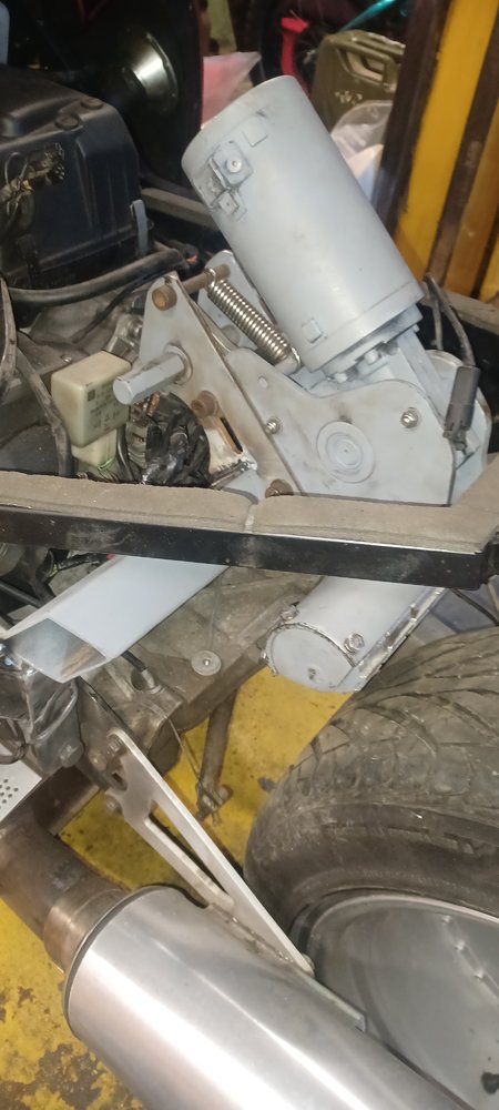

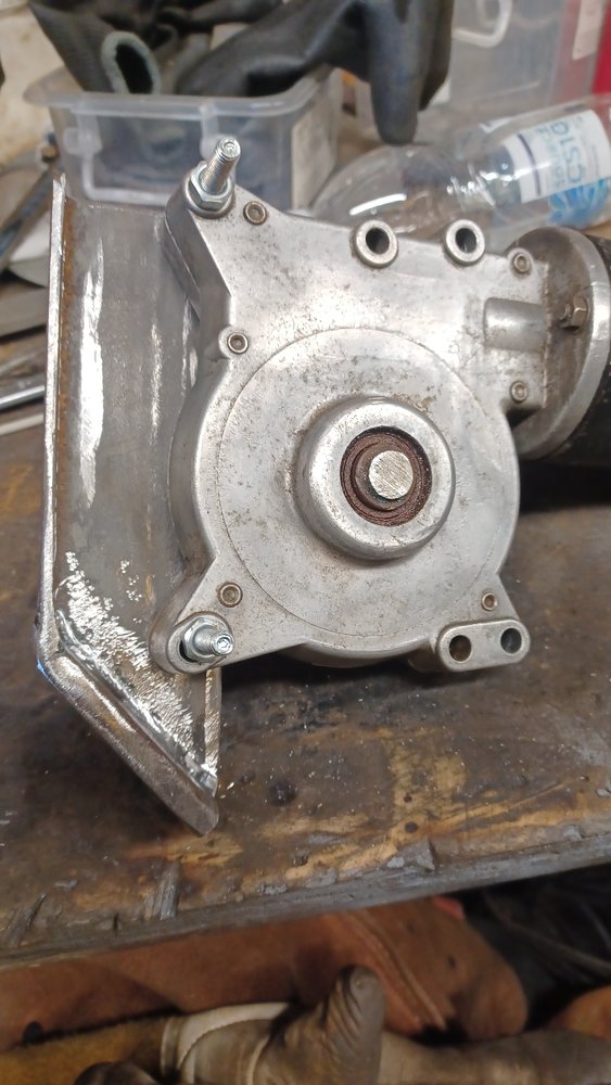

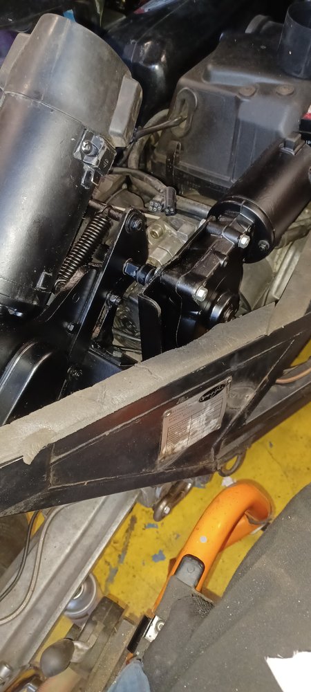

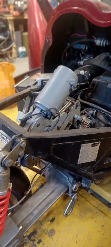

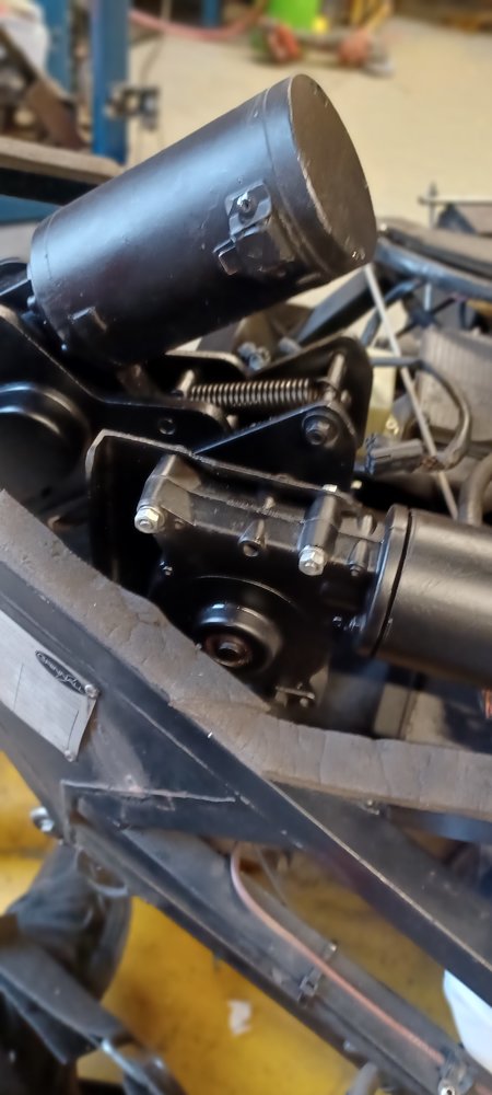

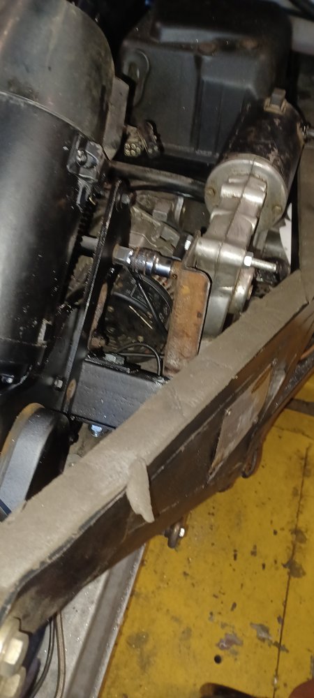

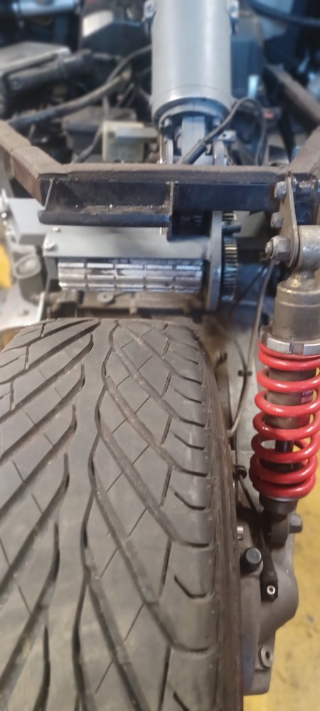

the grinnal being based on a bmw bike engine has no reverse gear which can be a bit frustrating.
i was given a caravan shifter that is a roller drive unit very low geared that drives the jockey wheel managed to get it in place and tacked .
its bolted to the box section for easy removal
i have to make a linkage to engage it and a couple solenoids . should be great for parking as it can run both ways
