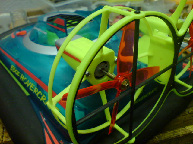

if you look on youtube a few of these have already converted to modern radio gear and now use 3s lipo batteries so the batteries are 11.1v instead of 9.6V, but I want my radio controlled toys to un on 3.7v batteries, which meant that everything electrical on it would need to be replaced. One of the issues with working with low voltages is the voltage drop as the current increases, when you're just using 1 cell in series but not a problem when using multiple batteries in series. A result of this was that I started in measuring the voltage drop across different connectors and wire sizes. I was lucky that I found suitable new motors that were the same size as the old ones, but ditched the old direction propellers as I made adaptors that allowed me to try different 5" quad propellers that were cut down to size, so I could try ones with different pitches and number of blades. with the thrust being measured on a scale and compared to the current drawn

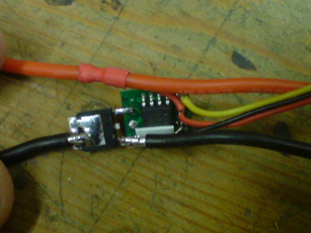

and the electronics, I used the original housing as it is waterproof, on the left is the lift motor, and that is switched on by the white cam on the right which operates a tiny microswitch below it, but that cant handle the current of the motor (about 3.5 amps) so that uses a tiny mosfet to turn the motor on and off. ( the contacts for the switch were originally on the circuit board that operated the radio gear and motors but that was thrown away, but I think my way of doing it was a neat solution to the problem. both of the thrust motors have a separate speed controller, the are designed to work at a higher voltage than I used, but with a bit of simple rewiring work fine (and they were cheap too) I got 5 for £14 delivered but looks like the price has gone up

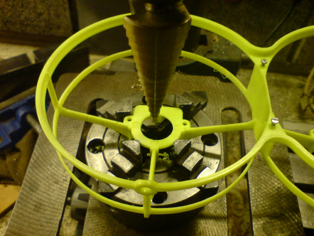

with the battery at the front being lighter than the original one (and providing more power), it made sense to reduce some weight at the back, so most of the propeller shroud was removed. Im old enough to know that you dont stick your fingers in propellers and if you do its your own fault, and secondly it has to slow the hovercraft down.
