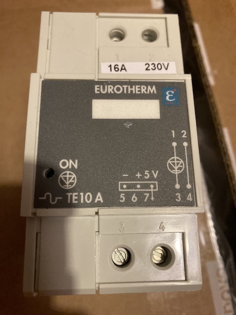

I’ll have a look and see what I’ve got. I definitely don’t have a ct, so you’d need to find one of those. I’m sure I have a phase angle thyristor and a controller that should be suitableYea if you had a kit of parts it would be ideal as I don't have a clue what I am looking for![]()

I have a 16amp phase angle thyristor
Yeah, whatever works I guess. You’d be limited by the size of thyristor available, you would need to size the heating element accordingly.Existing heater is only 3kw but that's the on-demand one (13a)
There’s no real point in getting a heater that can take more power than the thyristor can handle as you’d never use the extra. I have some 40a units but they are logic control (on/off) so wouldn’t be much kop for your application.

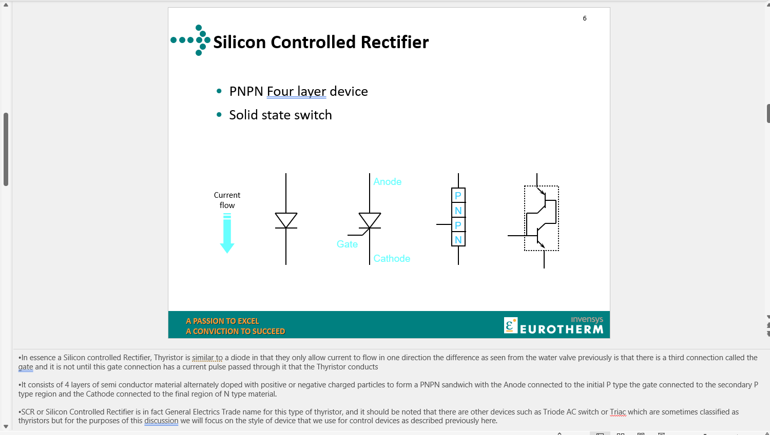

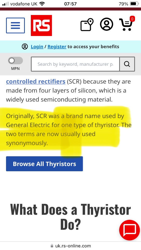

Finally someone who knows what he's talking about...An SCR stands for silicon control rectifier (not a trade name, just an abbreviation). It is to all intents and purposes a switchable diode (diodes are silicon devices used for rectifying current hence the name). Diodes allow current to flow in one direction only (within the device limits). Normally you can't turn them on or off, they're just always on.
An SCR is turned on (allows current to flow) when a current is passed into the gate terminal. You only need a pulse, they remain conducting as long as the current flowing through the main anode/cathode junction remains above the holding current. I.e. The only way you can turn them off is to remove the load.
They don't work well for AC because they only allow current in one direction so will inherently rectify the current flowing through them. A TRIAC is another form of thyristor that is effectively two SCRs back to back. This allows current to flow in both directions through the main body of the device. These need a constant gate current to stay on because at some point during the AC cycle the current will drop to zero briefly (50 times a second).
To limit "power" through the device normally you have some electronics synchronised to the AC waveform with a zero crossing detector. You then turn on the device a controlled period after the zero crossing (as it won't turn off until the current flowing through it is zero). The relationship isn't quite linear as @daleyd says because the waveform is sinusoidal but it's close enough most of the time.
Care to expand on that? I've tried to keep it in simple terms rather than going into things like gate pulses as that level of details isn't needed at this point.Finally someone who knows what he's talking about...
