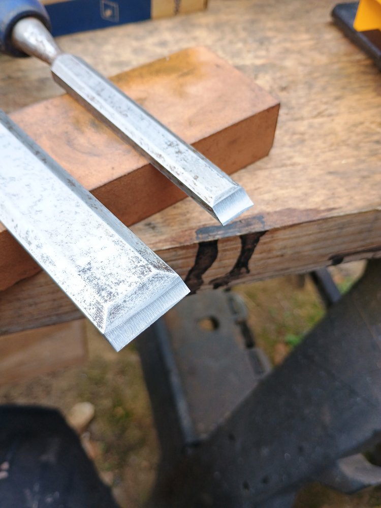

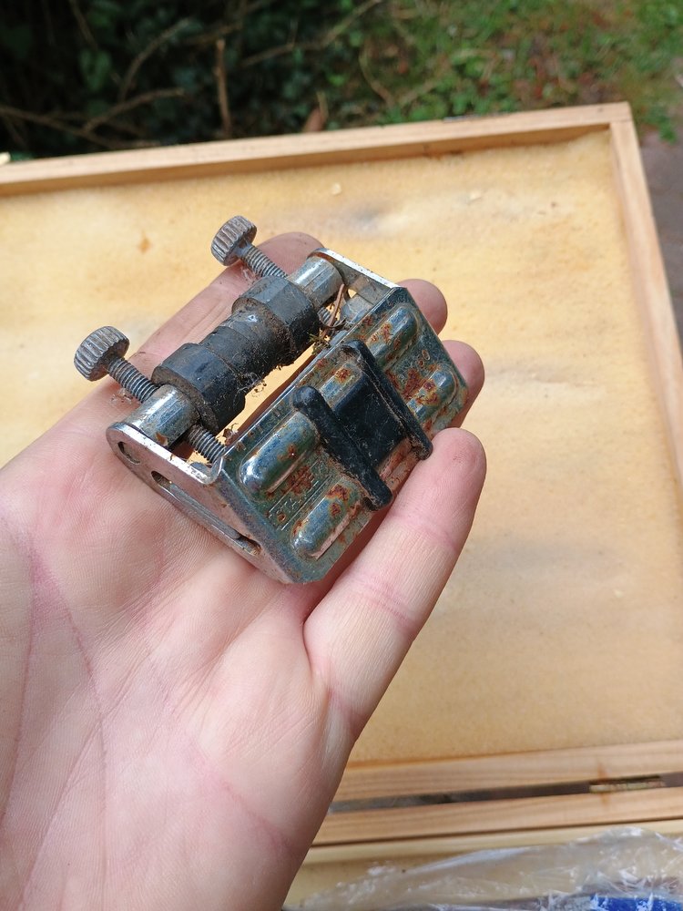

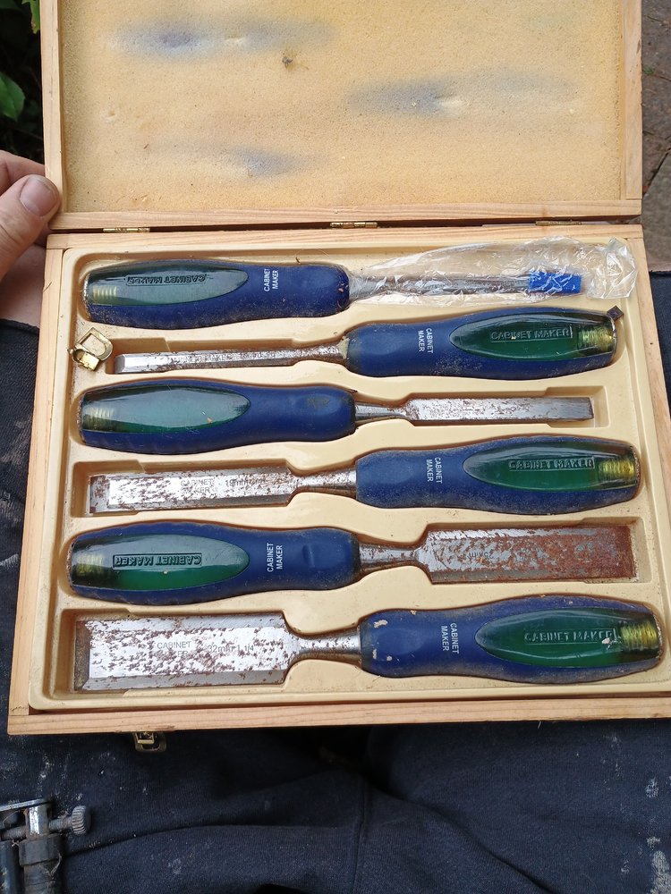

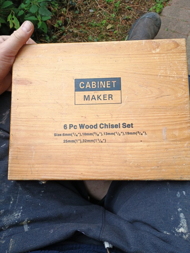

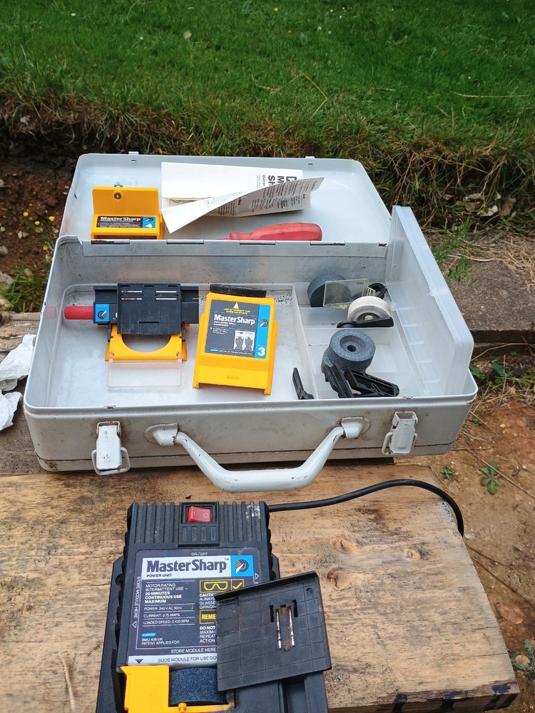

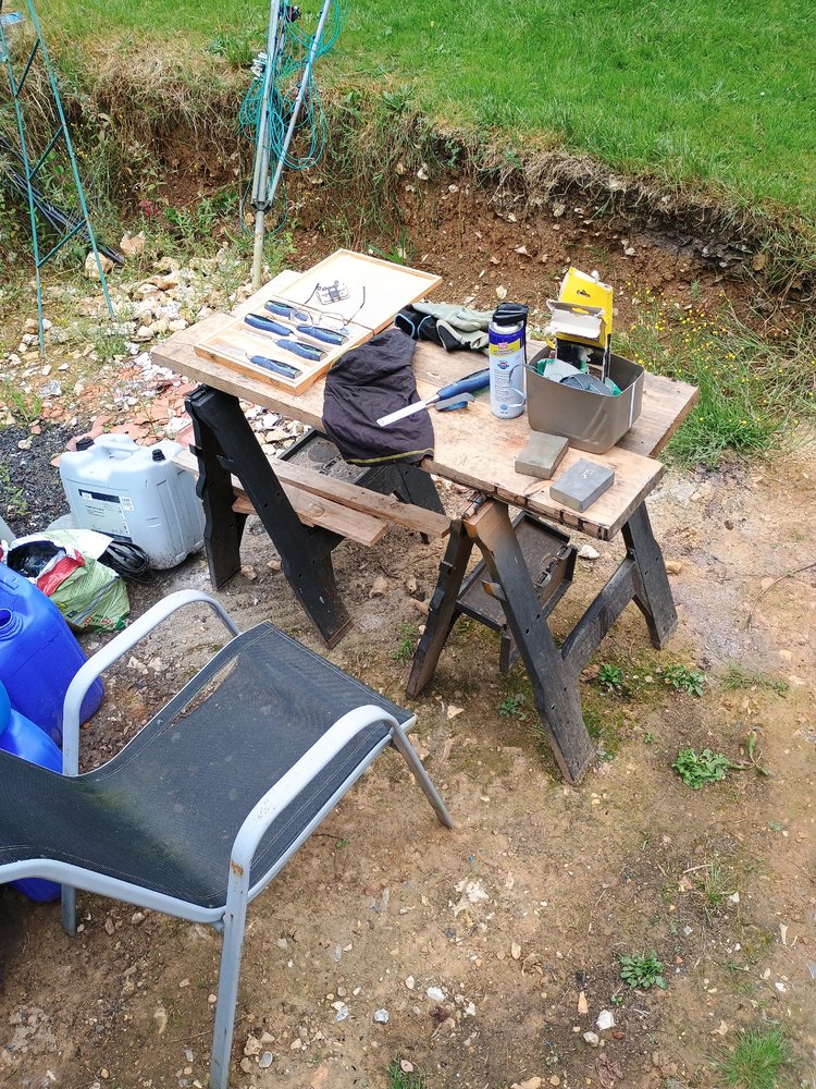

I’ve just seen them !It hasn't been too bad once I started. De-rusting them is a bigger task than sharpening them.
This Plasplugs thing puts a hollow grind on them.

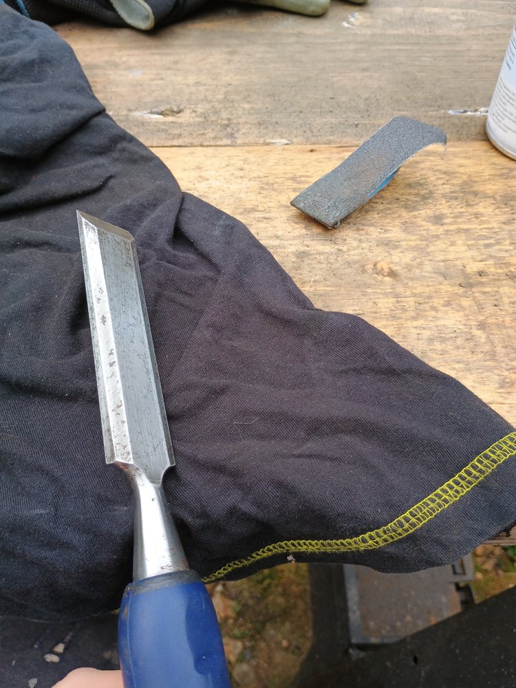

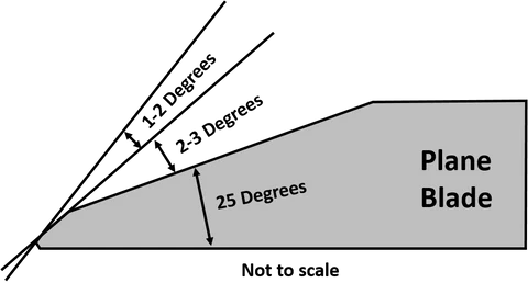

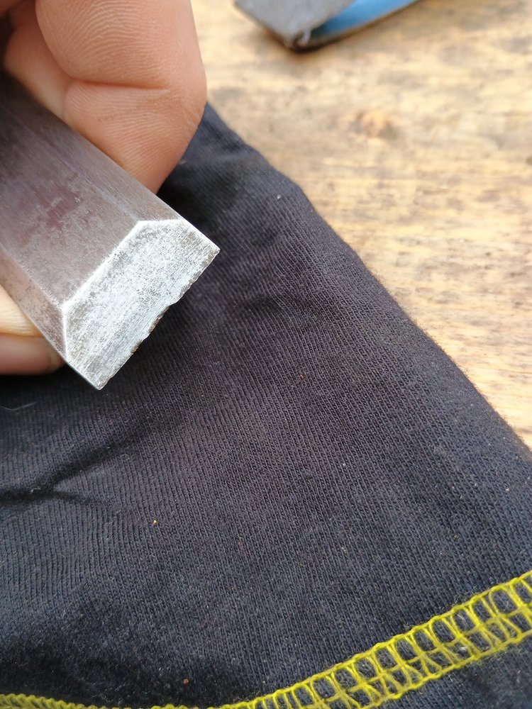

When you've sharpened the fronts tape some wet and dry to a sheet of flat board or glass and flatten the backs off.
Makro, home of quality tooling![]()
iis that an illusion looks to be curved on the ground face and the tip looks to be at a massive angle
should be sharpened as in wozzas post. set mine up for the angles on belt sander using my wixey digital angle finder. need to be fairly accurate for a smooth cutThat has to be the smallest door I’ve ever seen!They did the job I needed them to:
