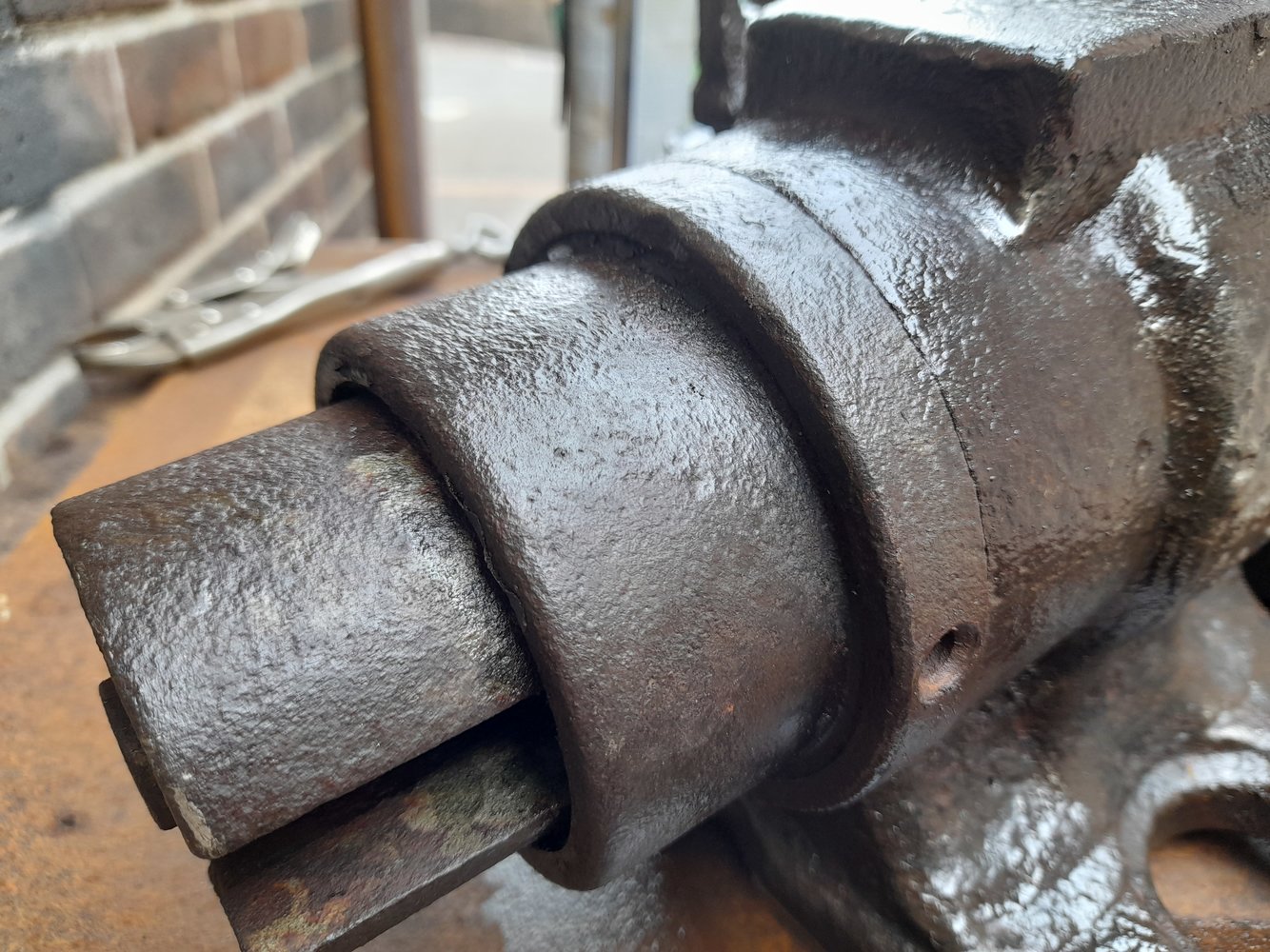

Possibly a nieve question, where do you normally "find" a vice like this, as obviously hugely usefull tool for the workshop, now I do mean on a shoe string budget.
Ha ha I love the hardened grease that looks like a country I thought it was metalThanks. Maybe I should make a video next time and teach you some new swearwords. I had to start making up new ones as I went along. Some choice moments include discovering a "mark on the casting" was actually a hole full of muck using a high pressure air line.

Of courseYou just post these photo's to tempt people by making them realise that there's more out there to collect than they thought, don't you.![]()
I looked again at this post still impressive the electrolysis really works wellIn this example the electrolysis was a bit of an overkill, I was always going to wire brush it. It does help though and since I am already set up, I can bung it in the tank and leave it for a day or two while I get on with some other stuff. For me the key issue is usually to preserve the original vice as much as possible. On this occasion however I am probably going to mod it; fit a different type of locking lever, machine or grind off the ugliness and maybe even attach it to a rotating base.
I think this one is going to be my main welding vice so it will probably get alloy or copper jaws too.

	Looks like you've done a nice job but of all the colours you could of gone with why did you go with the one colour that's gonna show every knock and scratch up like a sore thumb? When you sold it did it come with a free touch up kit![]()

Its next on the list. I will need to make a set of jaws for it. Copper jaws I think!
 thankfully !It needed a lot of work.
But the plain turned face looked horrible.
So after facing it and a fair bit of work with a hand file, I actually distressed it with a peen.
And the colour was a test of some super heavy duty epoxy (one part) paint I bought as a job lot. Its HARD!
I had to make a new retaining ring from a billet of cast iron and finished off the anvil to surface plate smooth
I won't be painting this one white.
