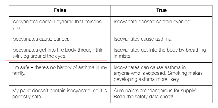

Thank you everyone.
Based on the above, I'm definitely going to just stay away from the traditional 2K isocyanates (and cyanides too - oops! That misconception was one of the things that always freaked me out). I've managed without them for 25 years.
So will only be using the 1k paints that I know plus I'll experiment with the non-iso / ADC 2k aerosols.
