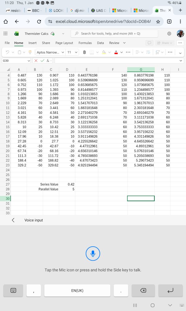

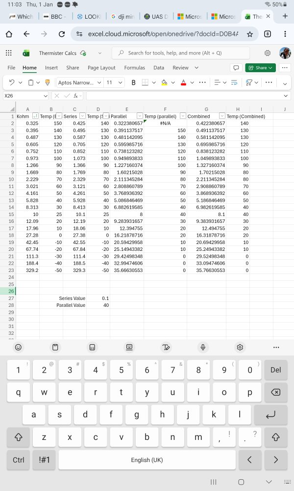

I think there's an error in the combined calculation - you are adding the parallel and the calculated series value, whereas you want to add the parallel with the fixed series resistance - for 80 degrees for example you want to add E9 to D27, not E9 and C9Should probably attach the spreadsheet for if anybody else want's to improve it
