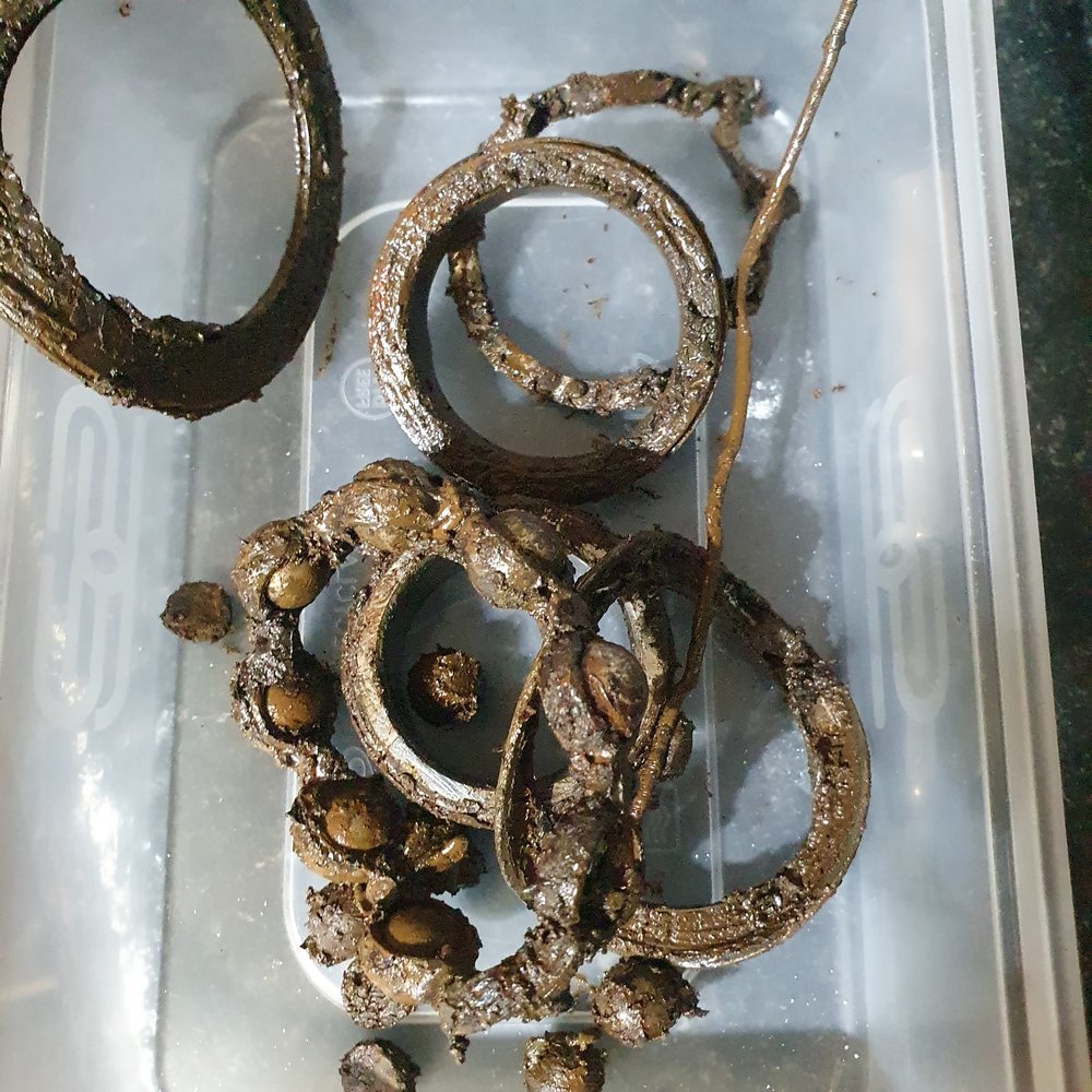

Don't even know why I bothered to start this job...
Bit annoyed as I told her several times to register for the 10yr warranty....
Bearings been rumbling for ages and its finally chucked the belt off
Got the drum out but it's bonded/welded together so I think that's enough..
There is one enthusiastic chap on utube who's cut his open then glued/screwed it back together afterwards.

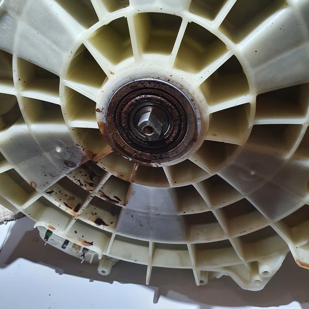

One question, is it only the bearing(s) at the rear of the drum supporting it? I was expecting to see something around the outside of the front end as well so now I'm tempted to cut it open just to have a look..
