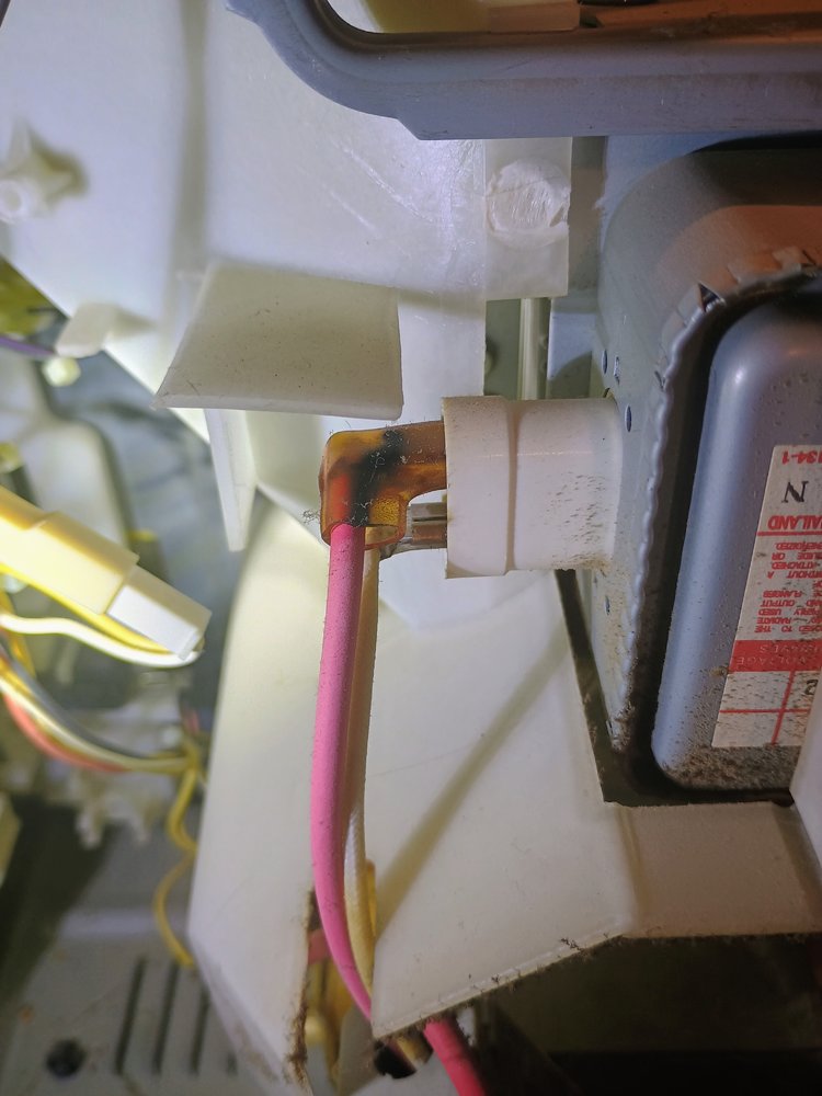

SWMBO went out leaving the microwave on. I heard a single loud buzz like if metal had been left in there (it hadn't).
Back she came to continue cooking and soon declared it to not be working. A massive old Sanyo combi. The conventional oven and grill still work.

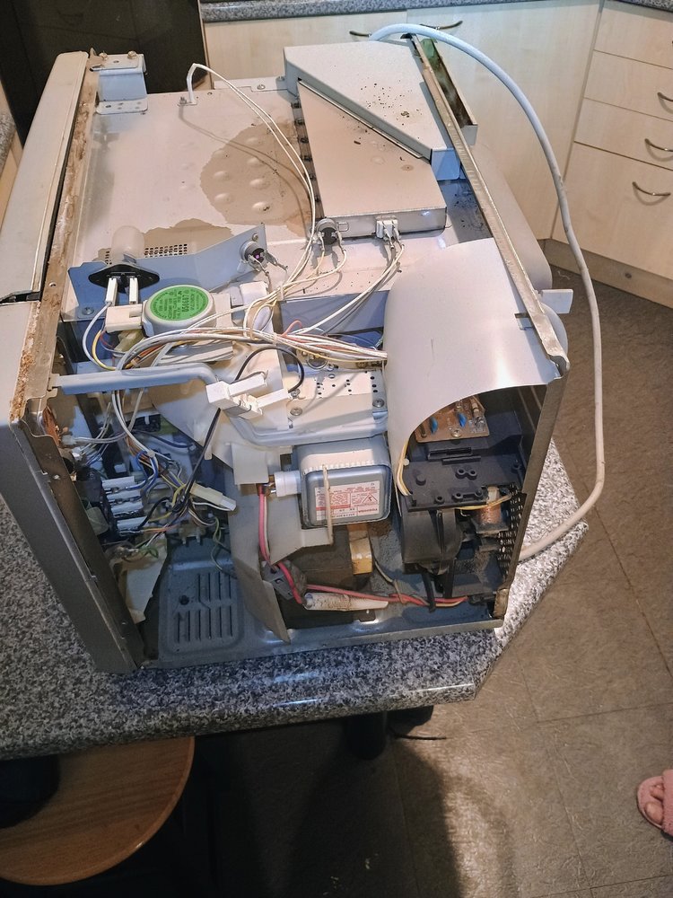

So...spare microwave dragged out from lad's uni days, dinner done and strip it on the breakfast bar. Needs a hoover. How do crumbs get along the top edge?

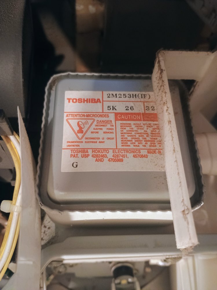

This connector on the magnetron appears a bit charred:
Assuming it's that then the only one I can find is £40 secondhand:
