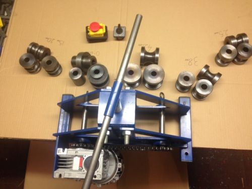

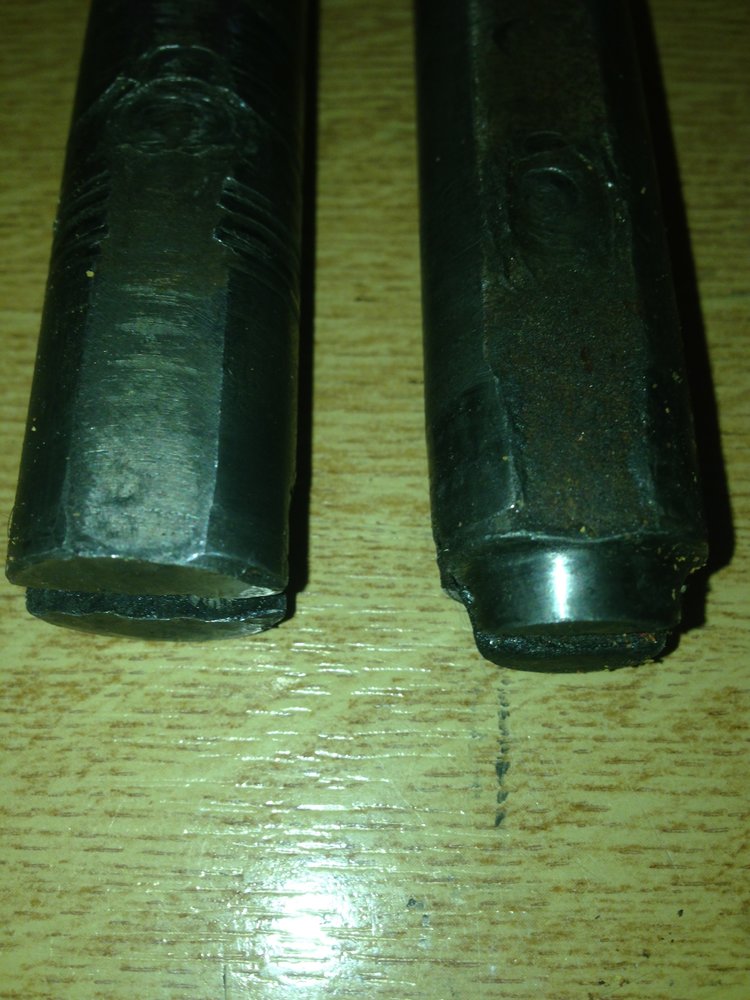

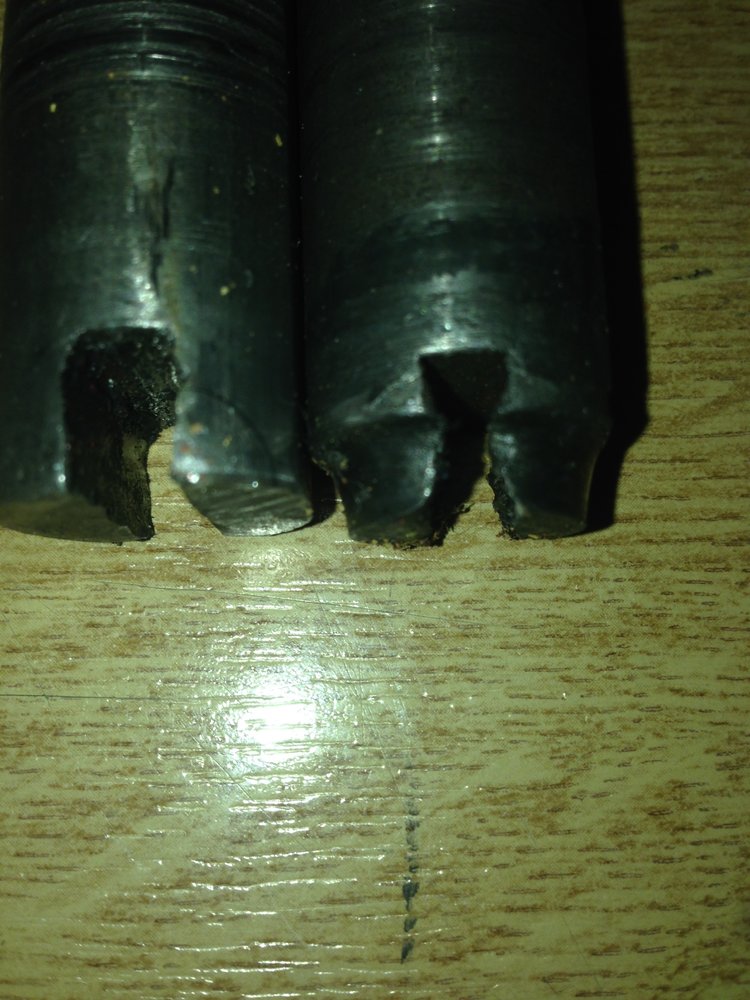

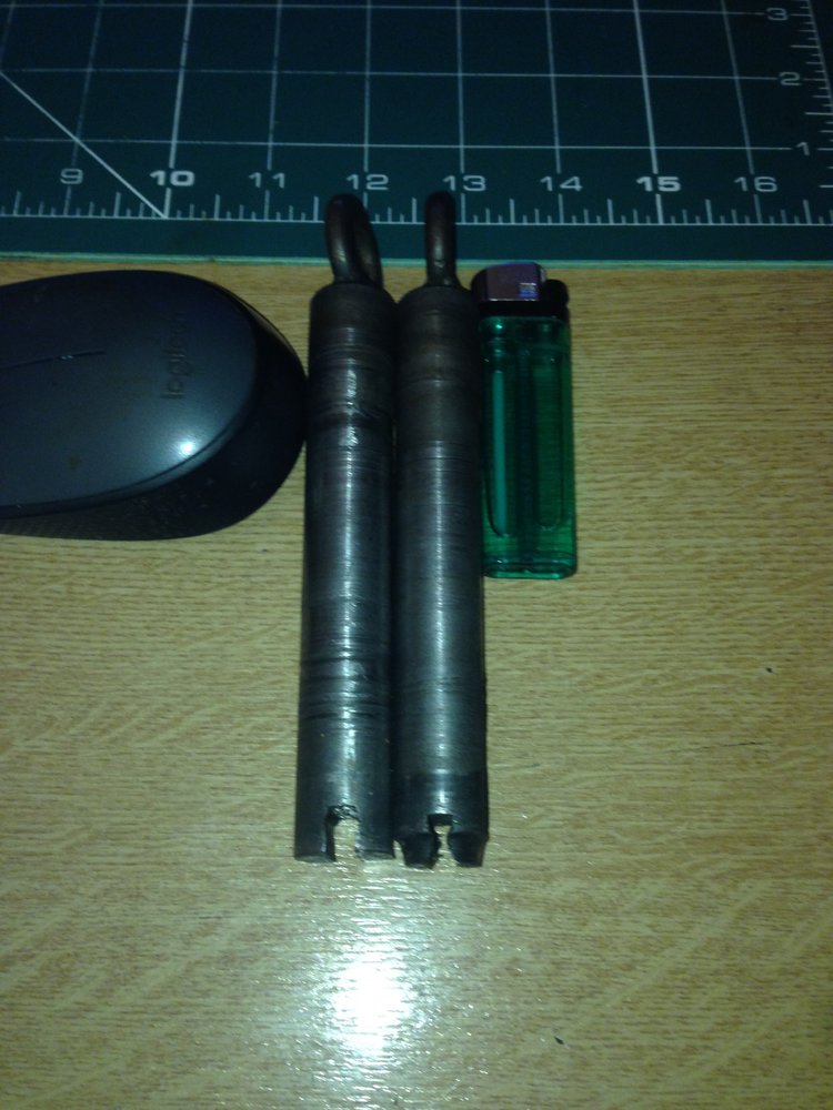

I I/Mx Member Messages 38 Location South Coast UK Apr 19, 2021 #1 One of the pins on my rolling machine has worn. It is the pin that is furthest away from the drive motor and I need to replace it/them. I am not sure if they are mild steel/hardened or if they are en8 Any suggestions welcome please.
frank horton V twins are great but 4"s rule......... Messages 4,712 Location Crete, Greece Apr 20, 2021 #2 en8 would do but better is some en16, just that bit tougher....en32 is tougher still but really not needed..... nice little machine..... poss more photo's and make.....ta....
grim_d Unlikeable idiot. Messages 4,160 Location Scotland - Ayrshire Apr 20, 2021 #3 Looks easy enough to machine....I could help you with that if you like.
