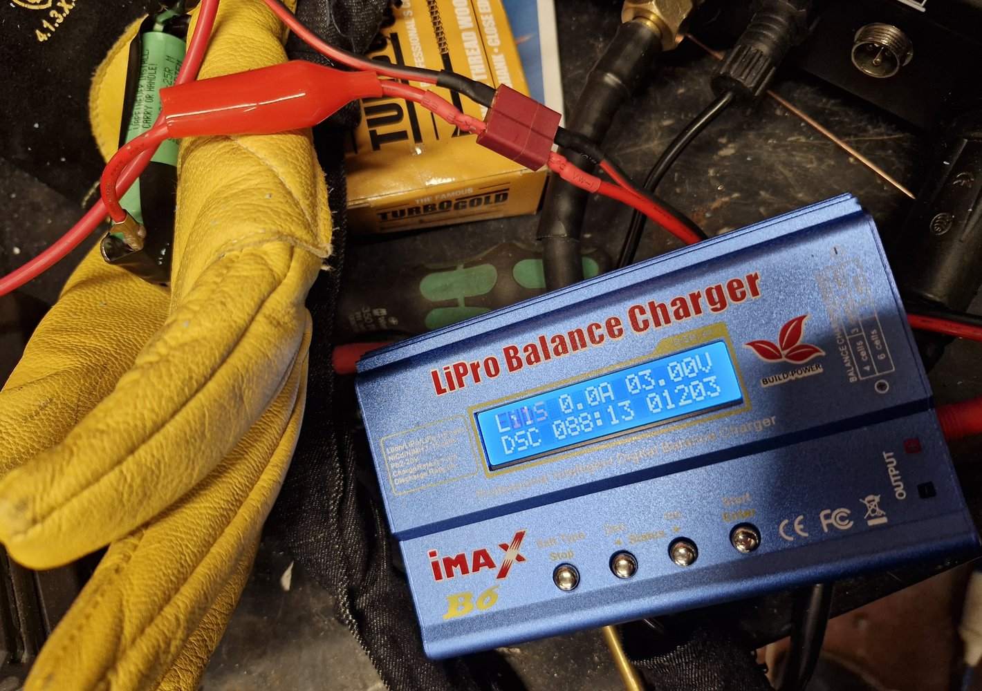

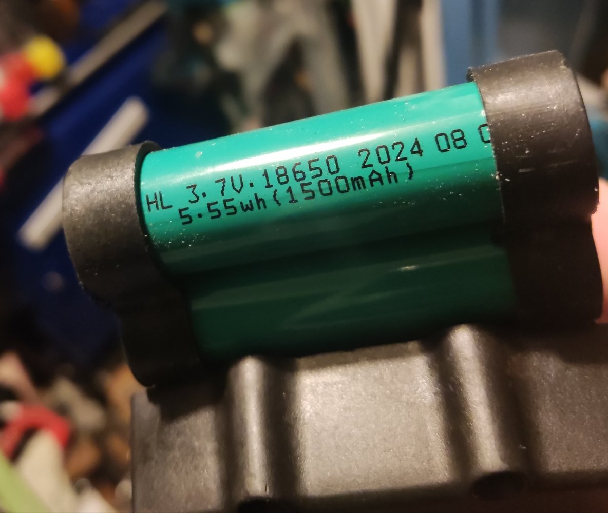

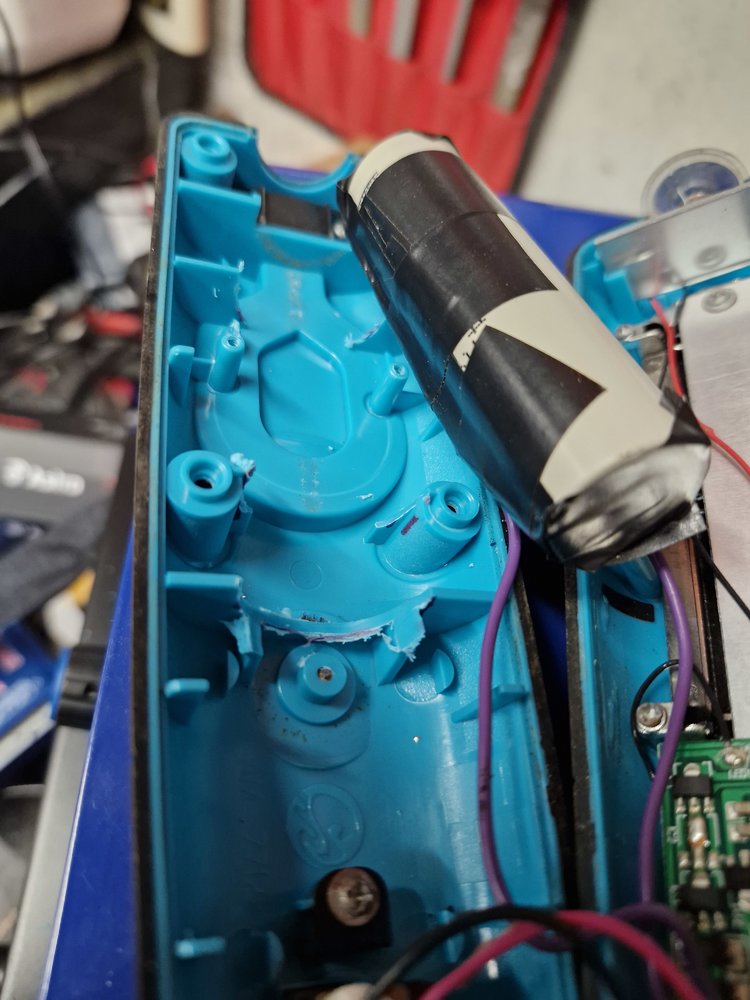

Hi JOEPRO. The voltage shown is the present cell amount. To assess the cell capacity stop the discharge and charge the cell until your Imax 6 indicates a full charge which for a good 18650 lipo will be no more than 4.2 volts. To begin a cell capacity test in the discharge field of the Imax 6 set the cut off to voltage to 3.0 volts. Set the discharge current to around 10% of estimated cell capacity [maybe 0.1 amps]. It is better that all charging and discharging tests are carried out whilst you are observing condition just in case something goes wrong.
