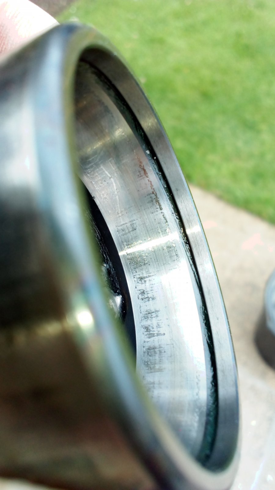

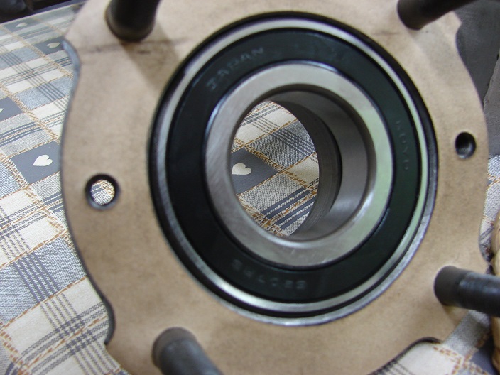

Bearing quality and lack of grease, very likely, Trouble is these days you can't be sure that you are getting an item from a respected manufacturer, So many fake products, even in packaging identical to the original.
That's one of the reasons I like getting 99% of parts from a trusted, old fashioned motor factors where you can be sure it's come from the correct places.
The presealed bearing only has the correct amount of grease at the time of fitting and not enough to give it a sensible service life, we are not talking about packing a bearing until the grease cant escape or bog down the rollers/balls, we are talking about replenishing and you know full well any excess will just spew out of the pre sealed bearing shields as does the original grease. The grease in the top picture has long dried up and gone and to prolong life needs an occasional squirt of grease hence the successful mod. There is not a pre greased bearing on any of my kit that lasts. All the machines with greasable bearings go on for years. One particular machine has run for in excess of 6000 hours on 4" diameter bearings and has to be greased every eight hours, thats the only chance the bearing gets to flush out the old grease or debris which in turn prolongs its life. Just my observations from real life experiences with machines over many years and a bit of fun
