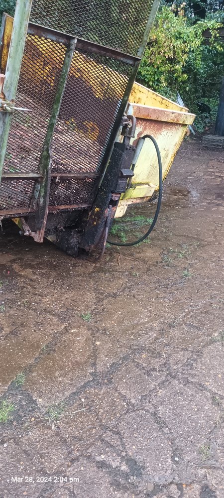

The trailer is online auction with Adam Hewitt salvage number 217640
There’s a clue what happened!
Probably overloaded with muck as there’s still some inside
The chassis rails have broken right where the cross member fits which holds the rams
The rams are bent
I am rather interested how the experts here would repair it
Or would you say no
As I say I won’t be buying it just interested

A local farmer bought a brand new 6 ton dumper trailer first job for it was a load of sand from a nearby gravel pit. His son said to the loader driver "fill it up". Got it back to the farm went to tip it and instead of the body going up it pushed the axle clean off the trailer. They dug out approximately 20tons of sand brushed and cleaned it, put a half load of corn in it, got the manufacturer to look at it. I bet the bloke who welded the axle on got a bollocking for nothing.
